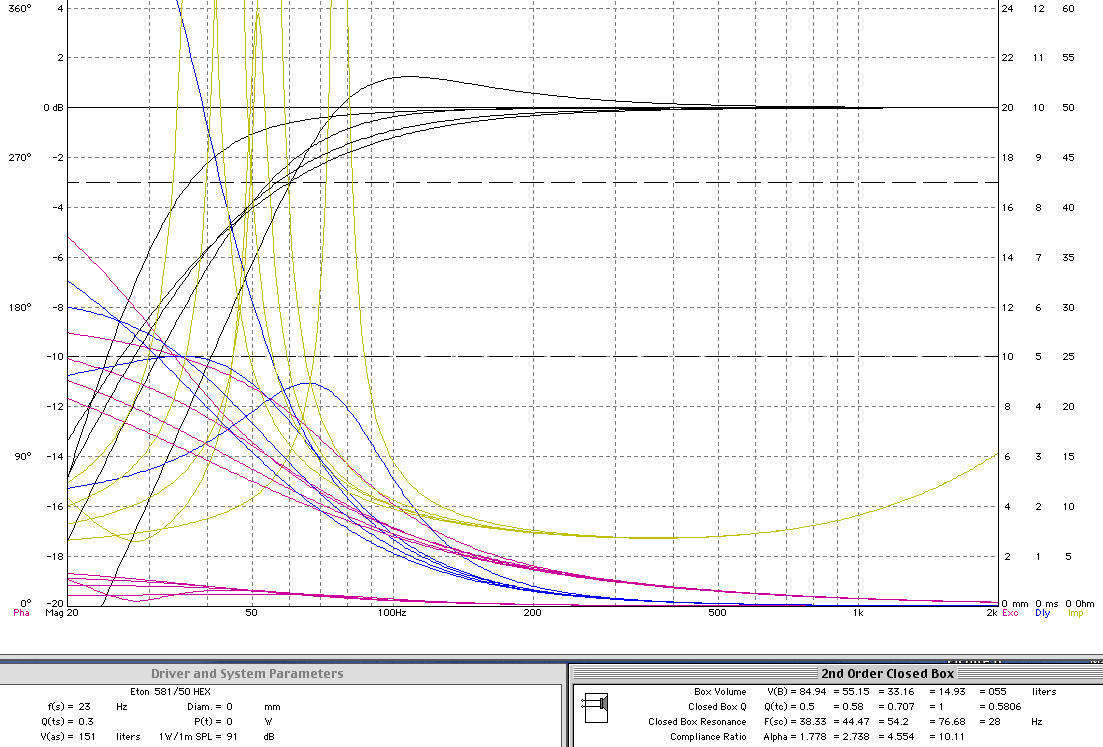

So how does this all work?
I'm getting funny numbers.
The Qts of my speaker is .30 Which is good I think.
So 0.30^2 = 0.090
Fs isn't given.
Fr is, and that is 18Hz so 18^3=5832.
Vas is 151dm^3
voice coil length of 18mm.
I'm not really sure how to calculate when
I don't have the specific numbers though.
Then the dreaded Qms of a high 8.80???
Ouch.
Bummer.
And I'm still trying to follow along but
it way over my head. 🙁
So when we have two drivers in push-push, do we
divide or multiply the resulting calculations by 2?
The numbers are for the Eton 581/50 HEX driver
for living spaces. I don't see much about them
nor much written up.
For sealed & reflex boxes you only need Qts, Vas, and Fs
Makes little difference unless you ar eusing a current amp.
2 drivers volume increases by 2, ports x2. Some numbers double, some halve, some stay the same.
A 55 litre vented box looks good. Tuning depending on how much room gain you have.
