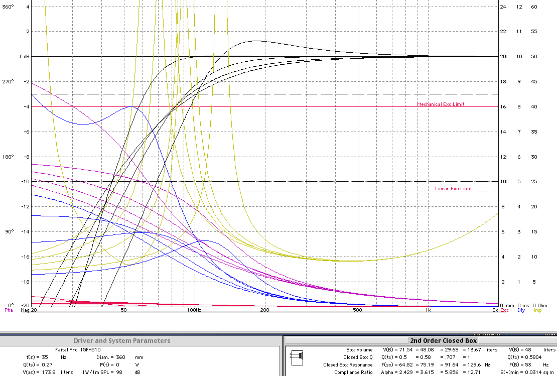

I disagree but like any low Qts driver it needs an EBS alignment to reach Fs.
Which is not good for free space positioning but very useful when the speakers find themselves close to walls.
These guys will be up against the wall. Is EBS tuning to the fs of the driver? The 12s330 simmed quite well from what I can remember?
Anyways. I'm pretty set on 1x 15 per side and to add another pair when funds allow. They're not too big in twin setups like an 18 and are affordable too. This way I can try ppsl, push push dual opposed, wmtw etc etc!
Faital pro 15fh510 looks nice http://www.faitalpro.com/en/products/LF_Loudspeakers/product_details/datasheet.php?id=151060125
What do you think?

Make the box too small and the peak before rolloff increase. The alignment becomes underdamped. From the sim i wouldn’t go much smaller than 15 litre and i would consider aperiodic at that size (or smaller)
dave
dave
So in a 48l closed box it's f3 is abount 62hz? That shows a lot of promise for a larger box then
F3 is a meanless number. Consider F6 48 Hz, F10 42 Hz, you’ll note that the same box sealed gets near to that and if you have lots of room gain will be better suited. A sealed box is also easier to EQ.
And there are lots of other vented tunings that could be considered.
dave
What do you think?
With a quick ISDonline sim the 15FH510 gives a very useable EBS in about 120-160L tuned to 32-35Hz.
And yes the bass shelf estends to Fs.
With suitable drivers the FR drops 3-6dB below 100Hz and remains at that level down to Fs from where it drops as you would expect from a ported box.
Helps keeping low bass at a sane level when the speakers stand against a wall and most of the time no correction is needed.
And research has shown that the useful bass cut off point is around -10dB (F10) rather than the usually quoted -3dB (F3).
In conclusion and on paper (on electrons?) the 510 looks like a good candidate IMO.
