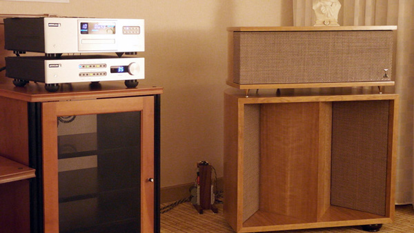

The vented LaScala sounds really good on music, but puts a demand on a compression driver (unless you want to try a Synergy style mid and HF).

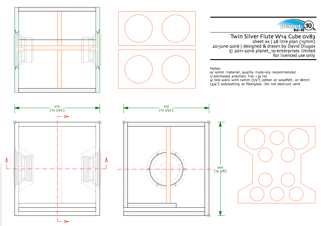

More vs larger? 12x2 vs 18x1?
Using a pr of drivers per box has the advantage of loading them push-push to get the advantage of active vibration cancelation so as to put much less load on the boxes.
We did test boxes with 2 SDX10s per box push-push made with 15mm BB. There were no significanr box resonance issues until the amps were well into clipping and levels were set about 10 dB above loud.

A quick look (it is past my bedtime).
BMS: 2 in 36 litre — estimate just over 40 Hz F10, F6 just below 50 Hz with no room gain.
Faital: 2 in 100 litre — ~42 Hz F10, f6 ~51 Hz.
Out of curiosity i checked the W14 response. 2 in 20 litres (smaller than the pictured woofer — its use assumes lots of room gain and goes lower yet) gets you just a tiny bit lower than either of the above. It would take ~16 of them to get the same Sd as one of the above, but it would give you lots of possibilities for room distribution and smooth room response.
dave
dave

I might recommend these type of bass bins, good to 60-70 Hz, and a TH sub.
Klipsch, volvotreter and Danley style unity horns if my memory serves. Thx Chris
