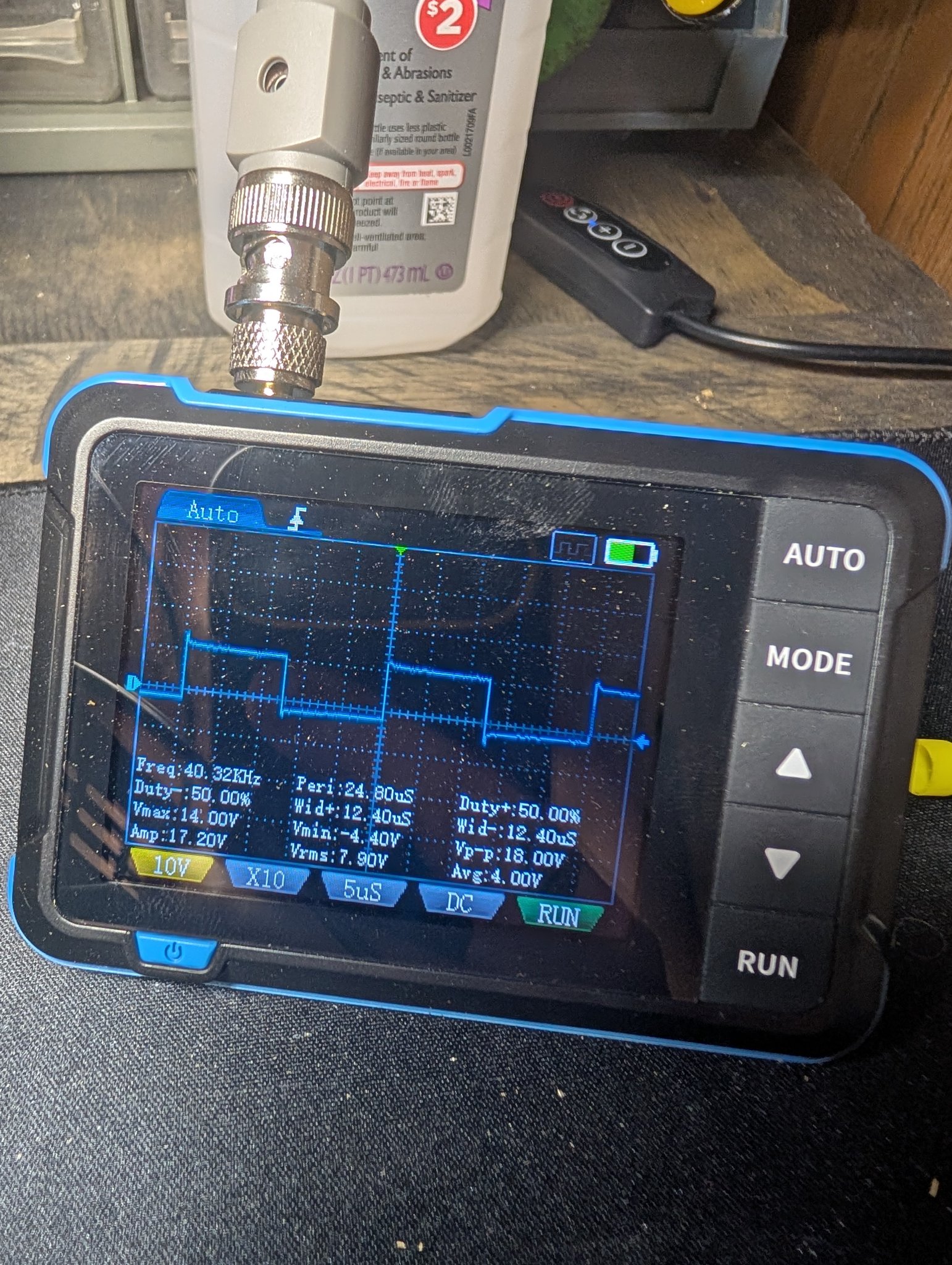

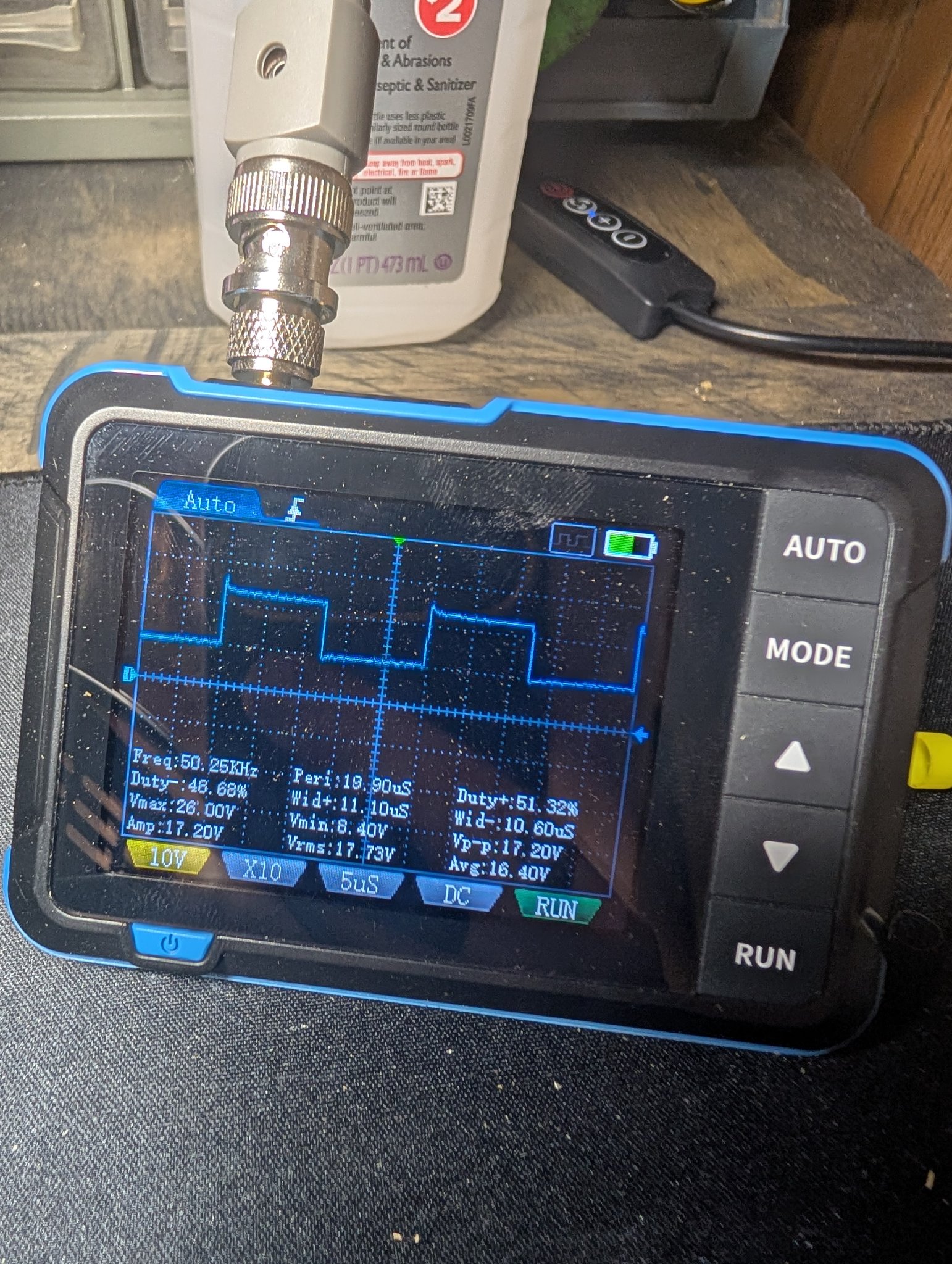

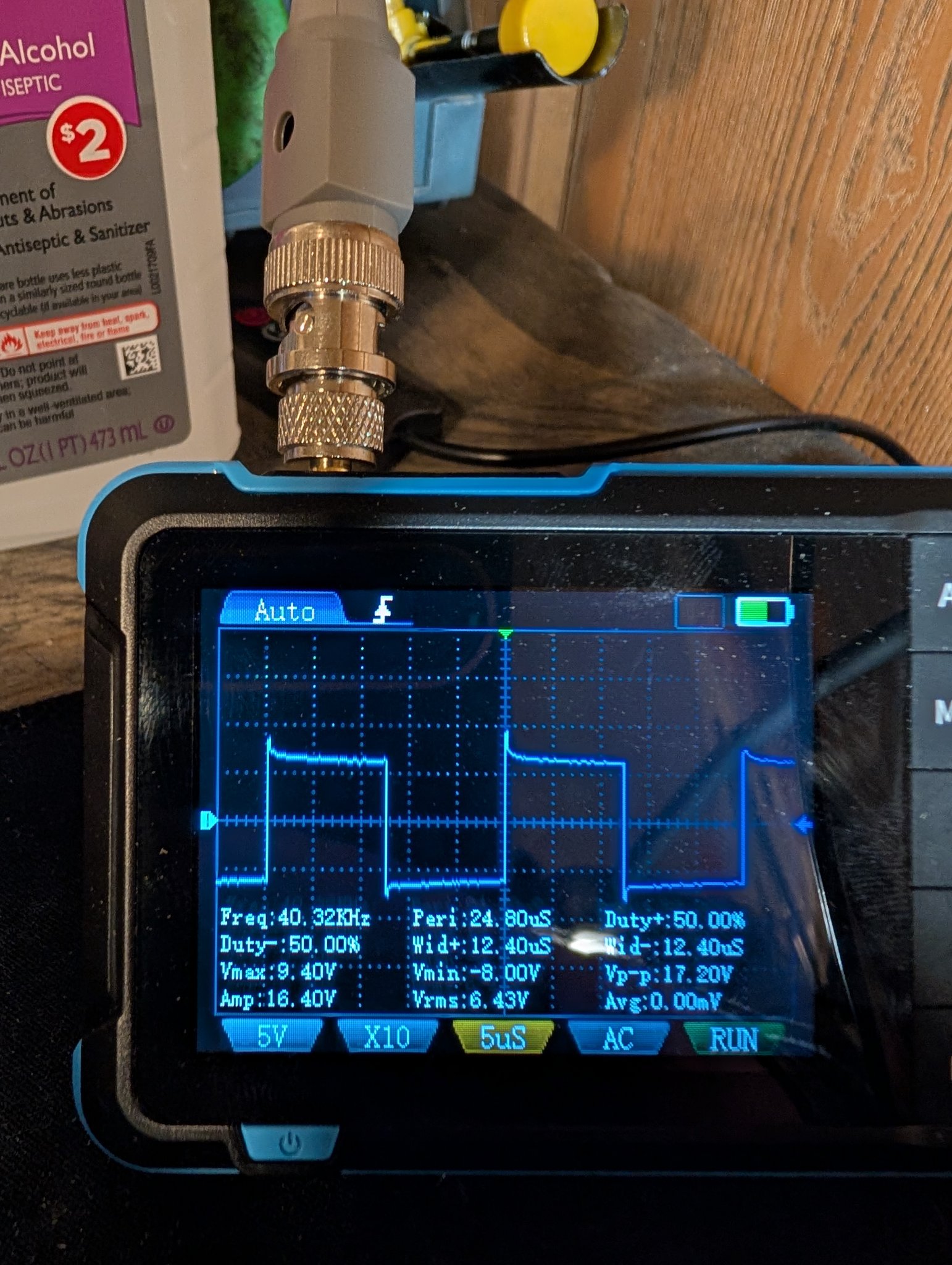

You need to leave your scope on DC coupling. It's virtually never good to have a handheld scope on AC coupling.
Set the scope to DC coupling and see what you have on both terminals. It won't be the same on both sides of the cap.
Okay noted. I'll check again after eating quick.
So always use the scope on DC coupling regardless of what I'm probing then?
With a battery powered scope, you will leave it on DC. If you're checking drive signals where you might want to use AC coupling, you place the scope ground on the source terminal of the FET and then probe the gate.
For mains powered scopes with grounded inputs, you cannot directly connect to the source with the scope probe ground. You have to use differential mode. Not hard to do. I leave my scope always set for differential input. It doesn't change the way the scope works but you can check drive waveforms with proper DC coupling, even for the high-side.
Below, the high-side in normal mode (20v/div) and in differential mode (5v/div). In normal mode, you can't tell anything. In differential mode, you can see the actual high-side drive. The DC coupling lets you see that the drive is pulling back to 0v. It's absolutely critical that you can see that it's going back to ground (or at least very well below the FET's threshold).
