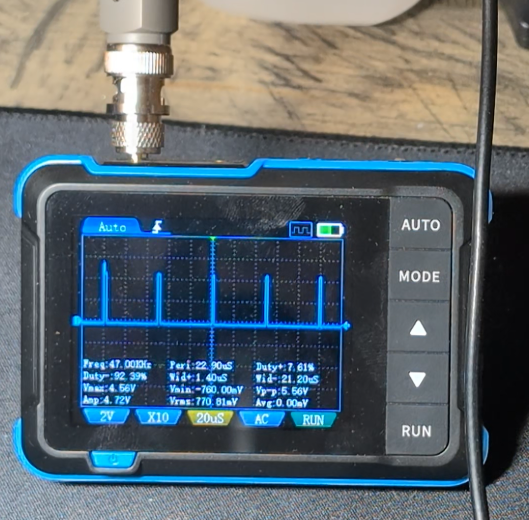

Bass 8k not building power supply square wave
Update: swapped MCU with working one. I have drive signal to IC3 for a few seconds and then the amp lights up power and protect LEDs and drive goes away. IC3 does not send any drive output even when drive is being sent by MCU. Tried replacing IC3 again just to rule it out and still having the same issue

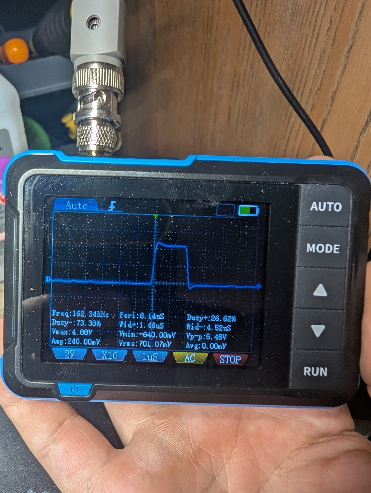

Amplitude showing 4.88v on scope (attaching picture)
Pin 6 voltage is 12.36v
*Edited because it attached the same pic twice
