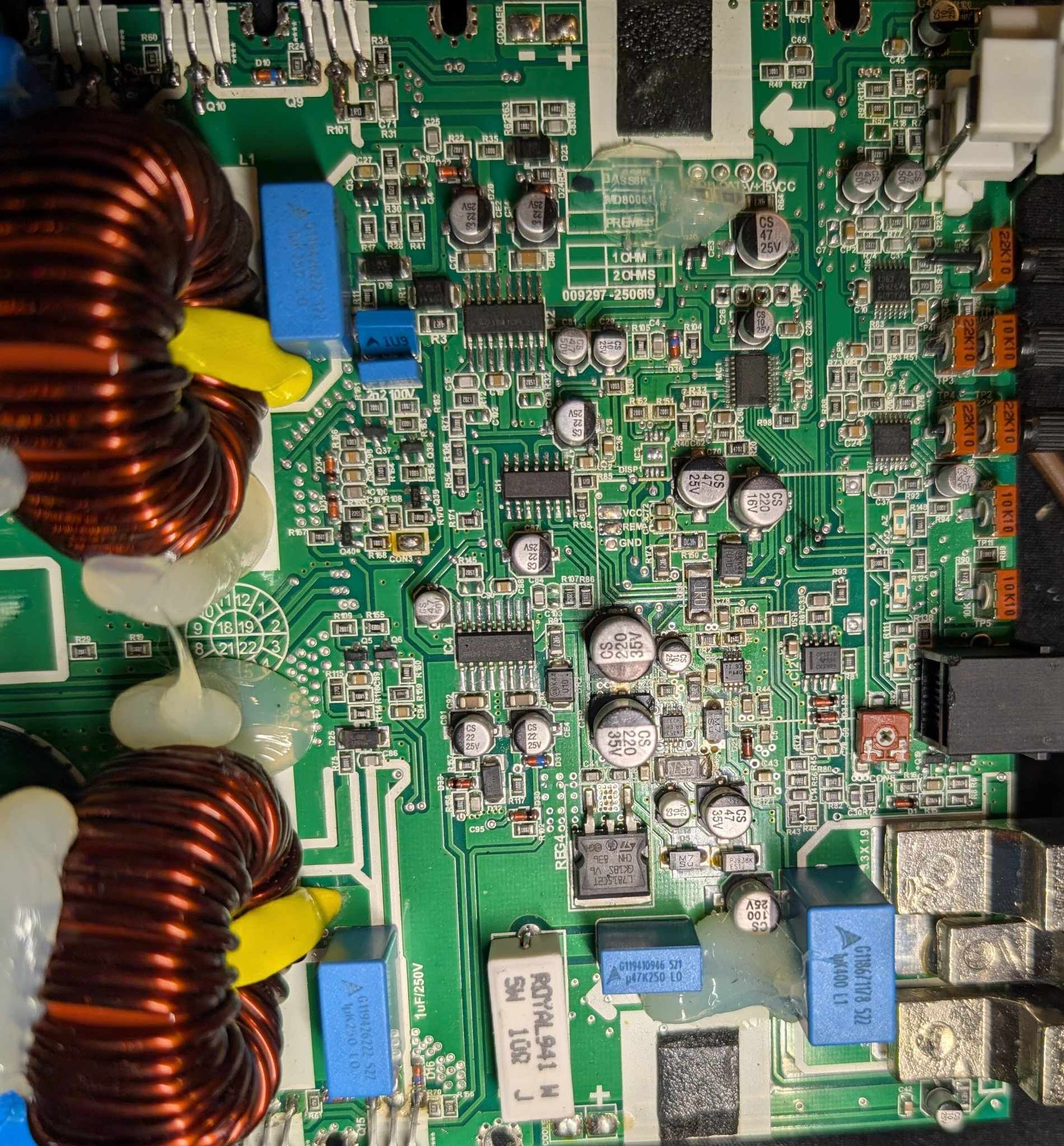

As of now, when the transistor that was driving it into protect is out of the circuit, do you have drive into the driver ICs?
Do you have output from any of the 4 output drive channels of the 2 ICs?
If you bridge pins 1 and 2 of IC12 with a meter probe while monitoring pin 1 of the driver IC, does that bridge give you a signal (whatever you're driving into the amp) at the input of the driver IC?
I have 7.8v DC on both of those pins but solid DC, I don't see any audio signal if that's what you're asking
Are you driving a signal into the amp?
Do you see audio on the output pins of any of the op-amps in the preamp section?
