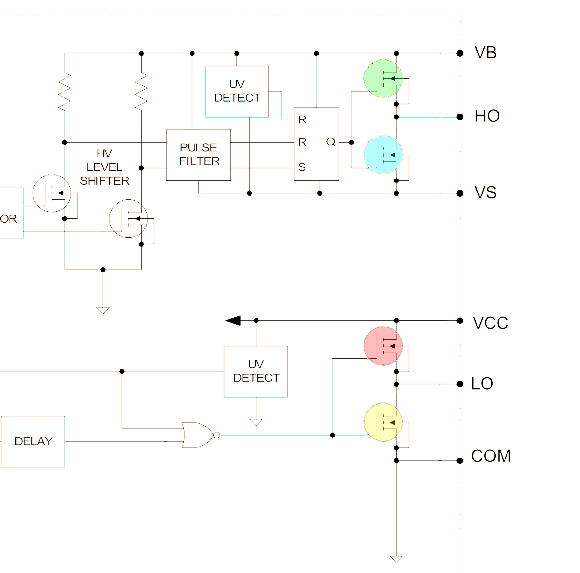

The IC didn't fail in the most common way (you checked the output stage). You checked everything else in that part of the circuit.
A couple of things you could try. Completely disconnect from the IC by removing D33 and R157.
You could also try paralleling a second capacitor across the caps in that area. They are low in value so even a 0.1 or 0.01 would be more than enough to tell us if you possibly have a bad cap. It's unlikely but there aren't many things left to try.
What you're doing here is basically what you're doing when you check the output transistors in an amp. ICs can fail in other ways but this type of failure (shorted internal transistors) is easy to check. The 8244 datasheet didn't have a good diagram. This is from a different driver IC. Note how each drive circuit is much like the output stage of an amplifier.
My mistake on post #116. You check:
14-15
14-16
15-16
