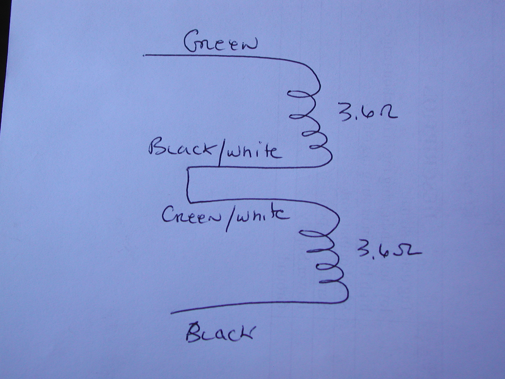

I made small test with multimeter
Primary:
Green/white green - NONE
Green/white black - 3.6Ohm
Black/white green - 3.6Ohm
Black/white black - NONE
Sec:
Red-Red - 150Ohm
Brown-Brown - 1.6Ohm
Yellow-Yellow - 1.6Ohm
I dont know about the secondaries but they might mistake with the primary colors ?!
"none" = zero ohms?
The above data is with all four primary wires not connected to anything? ie the black/white-green connection is not connected?
It appears that the color coding of the wires is incorrect..........
If you connect the Black/white to the green/white wires do you get 7.2 ohms across the green and black wires?
Nothing is connected to anything.
Connected green/white to black/white, then measured black-green and got 6.8Ohm (not doubled but close)
You just figured out your problem.....
There it is, the black/white and green white wires were reversed at the Factory.
Connecting 240V across the green/white and black wires would certainly blow the fuse, since you area only going across one primary; half the impedance pulls twice the current.
Meters are not very accurate at very low ohm readings, that's why you are seeing 6.8R instead of 7.2R.
....and it only took 63 posts to figure this out....😀
You need to wire like this:

Any way you want as long as the two primary windings are in series with each other giving 6.8-7.2 ohms.

Sagi: My comment in post #66 is incorrect.
You need to wire the primary windings in phase. Without having a scope and a signal generator, the best way to accomplish this is by fitting a small fast blow fuse around 1/4 amp and applying mains power. If the windings are out of phase, they will appear as a short, and blow the fuse. The transformer may hum loudly also. If they are in phase, everything will work normally.
My guess is that the green/white and black/white wires are flipped, so I would start there.
Well good news....this was the problem with the transformer. I used signal gen. scope at our lab to check the right wiring conf. with 1V-10V as input. All the secondaries are working as they should be.
