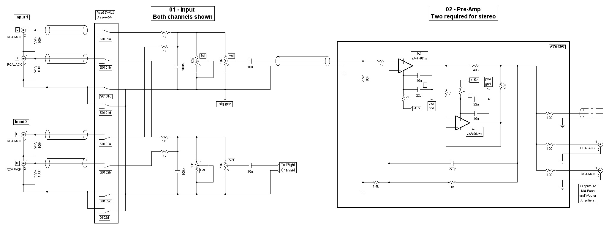

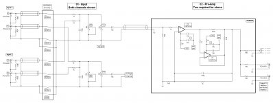

It's been awhile; I'm hoping to get back into this project. Once I get back to work I can start buying parts and the equipment I still need to make the PCB's.
Instead of Rod Elliot's balanced driver circuit I'm going to use DRV134's from TI. They offer better performance than anything I could create with standard opamps, but are still cheaper to implement than transformers.
The preamp circuit itself is still the same one I've been messing with throughout this thread. The DRV134 circuit is pulled directly from the datasheet.
This is the final version:

I consider the input filters to leave too narrow a bandwidth for pre-amp duty.
Those values are similar to what I would use in a power amp and I normally aim for at least an octave wider at both ends for a pre-amp.
Right, now that I've gotten more into power amp design I see 200Khz is limited for a preamp these days, even though any higher really seems pretty unnecessary to me.

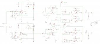

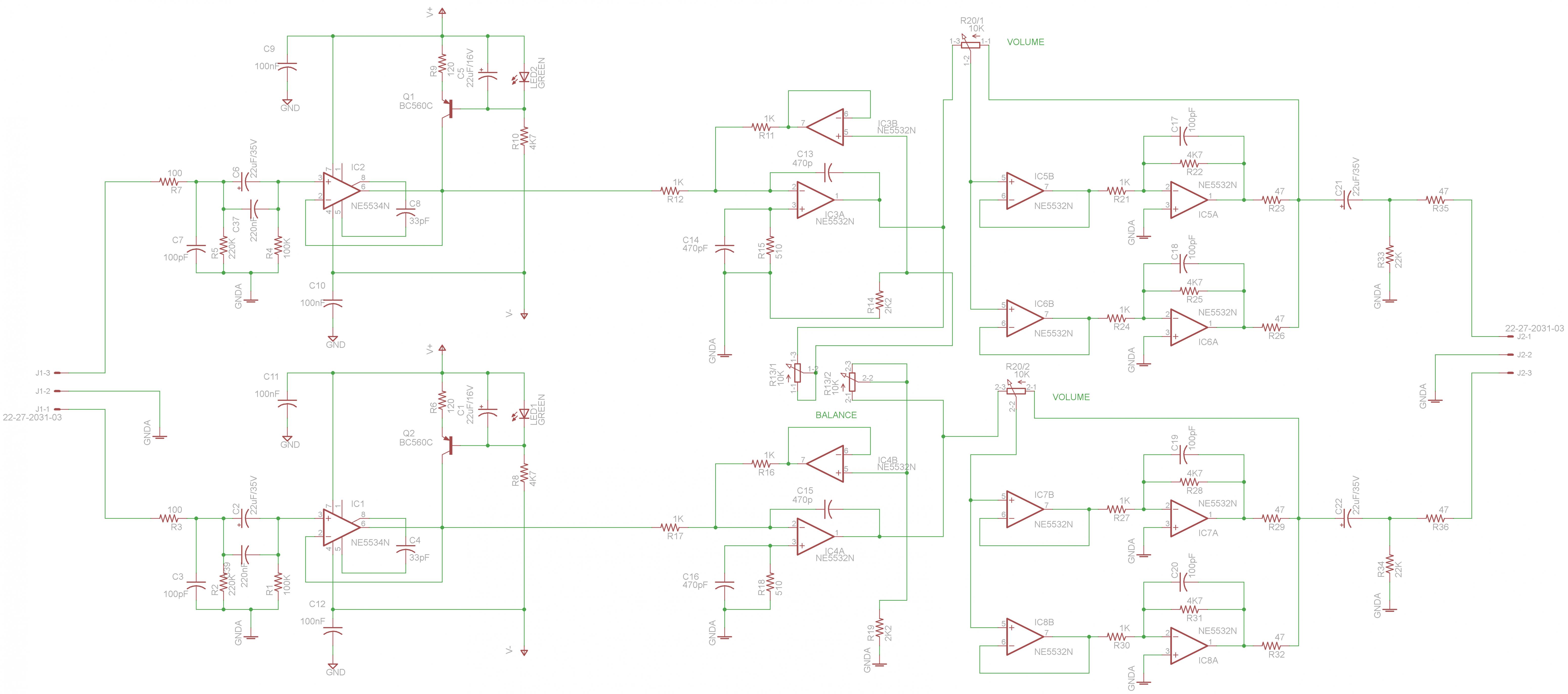

I recalculated the RF filter, reduced C to 50pF for ~500KHz bandwidth. The input cap will be 2.2uF. That's 1.4Hz with the 100K resistor. The output cap will be 5uF, that's .31Hz with the 100K.
Sorry for posting that old schematic. This is the one I'm working from in Eagle. It shows everything except the Vol. pot, which is off board, and the power supply.
As far as the board goes I'm going to start over. Too many things I didn't like. For one, I don't think I need the two 100uF filter caps on board, so I'm dropping them to 22uF. The power supply board is going to be pretty close anyway, inside the 1U case.
I really wanted to make the boards myself, but I may just plunk down the money to have some professional ones made. I found one company that charges 72$ for four two layer boards under 6.3"x4". I figure I'll probably keep two and sell two if anyone wants them.
Here it is: PCB Prototypes
Is there anything else I really should change before having another go at the board design?

That's interesting Mike, thanks. I don't think I've seen anything like that before. Is that basically a buffer inside of the feedback loop for the first stage? One thing I really don't get is the 49.9R basically jumpering the buffer stage.
two 50 Ohm esistors are making sure the output current divides equally between the 2 op amps - a way of doubling the output current
I'd use a genuinely high output current op amp in a multiloop composite
CFA op amps designed for A/DSL line driving make excellent outputs for audio line levels

Come on guys, this has got to be far from an ideal design. I know there is room for improvement. I'm open to ideas.
This is my pre-amp. The simplistic of Douglas Self pre-amp. Volume control must be log. function, using this active volume control, it can use linear pot. to achieve log. function.
