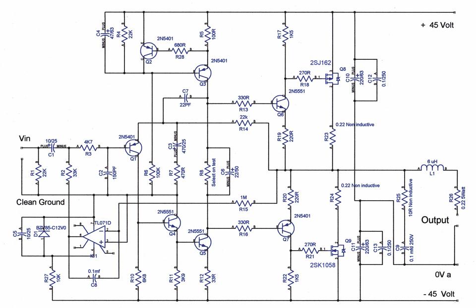

What do you mean by this?[Servos] add another "pole" into the LF response.
That's a good question, and it depends on the exact implementation of both the circuit and the servo.
So just to wander of the original thread for a moment, I used a servo in my power amp design, and you find if you examine the LF response of the amp that the servo has an influence causing a sudden peak in the response (and phase shift) at extreme LF
It's easy to "visualise" as you can see the effect of the integrator (the TL071) reduces at LF, and starts "adding" signal back into the amplifier.
So in some ways a servo is just as bad as using coupling caps... and in a preamp I wouldn't entertain it. Here it was the only way to enable use of a single ended input stage with DC coupling at the outputs.

Naturally it's better to have neither a DC servo nor caps as a general principle, but is there something inherently 'evil' about DC servos that I'm missing here? (Lot's of people seem to be upgrading their equipment with servos, to do away with caps.) As discussed, in designs like Stormriders (and mine), the amp offset can readily be eliminated by using low Ib, low Vos opamps. Would you say that it's always preferable to use such opamps and do away with the servo or caps, even if something like NE5532 would be deemed better (for what ever reason people might prefer a certain opamp with similar performance over others), or is it a matter of personal taste? I think I might by an OPA2134 and do some listening...Without the servo a true DC coupled amp will produce perfect squarewaves at LF.
I would say there is nothing wrong with servos at all if properly implemented.
Having said that, for a line level stage, I would look at ways of getting similar results without using one. Why ? because in a power amp we know that a speaker is never going to be asked to be presented with a squarewave at 1 hz with flat tops and bottoms. Hmmm a preamp... why compromise at all when you can design without that complication by using FET opamps where needed etc.
If you are really intent on using say a 5532 then you have to consider is it best to use AC coupling (such as in the VC wiper on Stormriders circuit) perhaps using a 0.47 film cap and 470 k bias resistor, or go down the DC coupled route and use a servo. I would probably go down the AC coupled route on that one.
