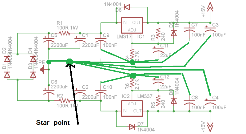

Power supply schematic... I just went from the LM317 datasheet and added the gnd lift circuit on the end. Output should be +/-15.3Vdc using standard values.
The gnd for the preamp board, and all the input signal gnds will return to this point, GND. PE will be connected to earth gnd. Is this the right way to do it?

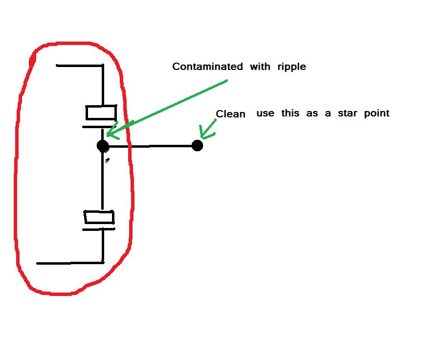

Make sure you use a "spur" off from the main reservoir caps as a clean ground to all circuitry. There are large circulating ripple currents in those caps that develop a volt drop across print and wiring that cause hum if you don't run a spur, and just connect "along the line" instead. That "star" point becomes the main signal ground. I wouldn't use ground lift resistors tbh... you shouldn't need it.
On your diagram the ground from C5 to C9 is "dirty" but to the right of C9 becomes clean. Make sure the "adj" terminals of the regs go to the clean ground.
yes,On your diagram the ground from C5 to C9 is "dirty" but to the right of C9 becomes clean. Make sure the "adj" terminals of the regs go to the clean ground.
The common ground for C1, C2, C5 and C6 must NOT be connected to the zero voltage reference of the regulator.
The two halves of the circuit must have a separate ground lead to the Power zero volts point.
No.Like this?
You must break the connection between the smoothing caps zero volts and the regulators zero volts reference. The regulators require the C9 & C10 to be located at the reg. These must stay with the regulator zero volts line.
C3, C7, C11 and R4 must meet at a point. The zero volts reference.
Take separate wires from the regulator zero volts reference and from the smoothing caps zero volts to the main power ground.
Something like this. Your ground connection/s to the amps goes to the star.
Try and imagine and think of each wire and line of print as a resistance... and what will happen if a current (AC... but it's useful to think in DC terms too, to make it easy to follow 🙂) flows along it. Ask yourself "will it influence any other voltage or superimpose itself and interfere with any other part of the circuit"
The good news is that yours is such a low powered circuit it's not really going to be a major issue anyway... but it's nice to get it right.

This seems completely unnecessary. Are individual ground runs really needed for each regulator? And one for each 100uF filter cap? Is this the same thing you were talking about, Andrew?
It's definitely not COMPLETELY unnecessary, although some parts are more important than others.
Currents flowing in ground return conductors induce voltages back upstream, at the non-ground ends of the conductors. So, something that should have a quiet ground should not share any length of ground-return conductor with something that is not quiet.
Conductors have at least both resistance and inductance. And while the voltage induced by the resistance is only the current multiplied by the resistance (bad enough; but it gets worse), the voltage induced by the inductance is the rate-of-change of the current multiplied by the inductance. If there are even small-magnitude currents that are changing rapidly, the induced voltage can be relatively large, with relatively-large dynamic fluctuations. And if that voltage appears back at the ground reference point for a regulator, or an opamp or amplifier input's ground reference, the voltage ends up being SUMMED with the input. That's "a BAD thing".
If you are aiming for perfection... then this is the way to do it. It's not just being fanatical about this... it's a very real issue and the main reason why DIY amps are not 100% silent hum wise (and a lot of commercial stuff too)
The charging currents in the main reservoir caps can be huge, they can peak in the "several amps" range for a millisecond or two. Now imagine you have a piece of PCB track or wire a few cm long that has only a few milliohms resistance lets say 10milliohms... and the current through those caps peaks at 2 amp. That gives you 20 millivolts of ripple. If you connect an input ground to that print and a feedback return a few mm futher along you have "introduced" a proportion of that ripple into the amp. Result... a harsh hum/buzz.
You can clearly see on a scope this ripple current just by clipping the ground wire to one of the reservoir caps and "sliding" the probe along the caps lead... it's very clear and measurable... and audible if you get it wrong.
In your case, you will achieve 98% of this by making sure you just keep the star ground separate as a spur from the main caps as I indicated earlier. It's all low power stuff... it's all essentially class A, so the current draw is constant. Is 98% good enough ?

As you have drawn it here, it's still wrong...
It works 🙂
indeed.As you have drawn it here, it's still wrong...
Listen.
Run a wire from the smoothing caps zero volts to the main audio ground.
Never put a string of tappings on the connection between the smoothing caps.

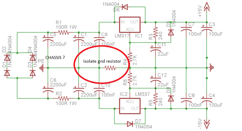

Regarding the ground lift resistor, it's placement seems wrong to me. Placing it between the PSU and audio circuit ground like that introduces a 10 ohm resistance to any circuit taking power from either rail and the ground, which is probably not what you want.
The idea of such a resistor is to prevent ground loops via the protection earth, so it should go between the device ground (the ground shared by the PSU and the audio) and PE. From electrical safety point of view, it's best not to have one and just directly connect to PE. Proper grounding of the equipment ensures that there is no hum due to ground potential differences. But what if the impedance via PE between devices is not much higher than along the interconnects? I would expect this to create crosstalk between (unbalanced) signals via magnetic coupling since PE acts as a signal return path. Also, RF pickup might result. I've never experienced this problem myself, so I can't say how big it is.
how about isolating the gnd of the reg from the smoothing caps
So carry your idea foward 🙂
What value would you use ?
Where is the star point ?
If it's to the left of the resistor, then the reference pin of the regs are not accurately defined and with reference to the star would be subject to disturbance as any AC component flowed in the caps of the regs. That would alter both rails relative to the star even if the current draw was only in one reg.
If it's to the right of the star... where would you connect the load too... imagining it were a power amp etc ? The same problems of currents in the ground lead still apply.
Do you see 🙂
