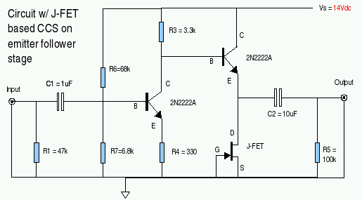

Regarding the circuit in post 16, the whole point of the follower is to lower the output impedance. I bet you could use a smaller resistor for R8 and run higher current say 20mA in the follower, and perhaps a larger output coupling cap. Or better....if you happen to have a J-fet of adequate conduction, you can replace R8 with a CCS, just connect the gate to the source of the fet. Then you have a singe end class A (small) power amp for the common emitter. Easy:)
J-fet input stage does have it's advantages. If you get into audio electronics, you will acquire a love for J-fets.;)
BTW, if you notice on those small signal BJT's the current gain bandwidth decreases significantly when conducting less than 1 or 2 mA. You might try to re-bias the CE stage for at least couple of mA.
Hello CBS240,
Thank you for the suggestions. I'm open to any and all ideas.
While I don't have a bigger coupling capacitor handy, I will fiddle with some of the resistor values to try and boost the current flow above 2mA in both stages too see what happens.
Also, I like your idea of applying a CSS to the emitter follower stage. While I don't feel a need to make this little preamp into a power amp, the CSS concept is intriguing to me as I suspect it might enhance linearity (and maybe PSRR as well). Please take a look at the attached sketch to see if I wired the J-FET properly.

Yep:up:
The fet can be chosen based on Idss. It is good general practice to drive the input of the amplifier with lower impedance so that the input Z of the amplifier doesn't load down and effect the linearity of the pre-amp circuit. Just a buffer, which happens to be a power amplifer.:)

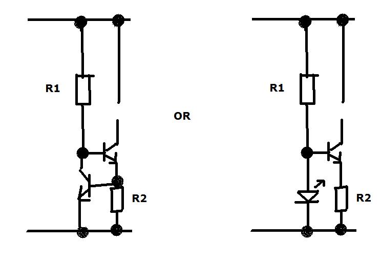

Something like a 2N3819 would be suitable... or you could use two npn transistors, or one npn and an LED.
In both cases R1 is chosen to provide enough bias current for the transistor. So around 4k7 would be a good starting point with a reasonably high gain transistor.
In the first example when the voltage across R2 reaches around 0.6 volts the lower transistor begins to conduct and this holds the current at a constant value by "shunting" away base drive from the pass transistor.
So the resistor value for say 10 ma would be
0.6/0.010 which is 60 ohms. So a 56 ohm would be ideal. By altering that value you get the current you require.
The second one uses an LED to provide a fixed voltage on the base. LED's make excellent low voltage references... different colour, different voltage :) A red one will be around 1.8 volts. So 1.8 volts on the base gives an emmiter voltage of 1.8 - 0.6 which is 1.2 volts. That voltage is "constant" so you can now select a resistor (R2) to give your desired current. So 10 ma would be 1.2/0.010 = 120 ohms. R1 sets the "bias" and current through the LED as before so 4K7 again as a starting point.
The "open" collector would take the place of the drain of the FET.

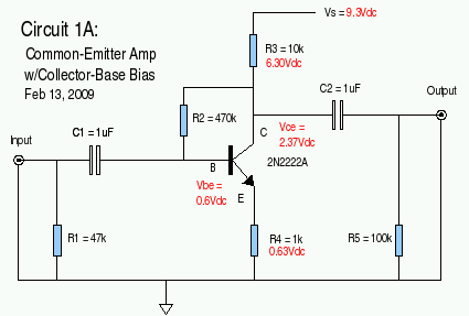

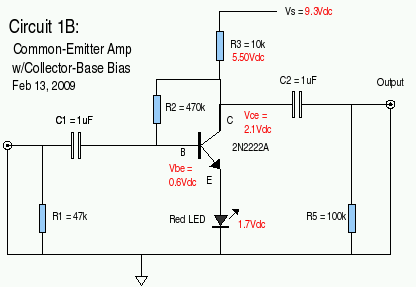

To better understand the various attributes of different biasing schemes, I went back to my original circuit (with collector to base biasing) as seen in Circuit 1A below. To my tin ears it produced the same level of gain as the circuit in Post #4 and sounded decent too.
While waiting for the parts store to open I found a red LED in my junk box and plugged it in place of resistor R4. Wow! Same volume out as before, yet the sound was noticeably more alive.
By my calculations, Circuit 1A should have a gain equal to about R3/R4 = 10K/1K = 10. In Circuit 1B, I assume the gain would be about R3/(voltage drop across LED/emitter current) = 10K/(1.7V/0.55ma) = 10K/3.1K = 3.22.
Interesting!?!?

Keep in mind that in this circuit, R2 is providing some level of feedback. Av is not exactly the same as in a voltage divider bias circuit. (circuit in post #4)
R4 provides some degeneration to the transistor emitter, which is a form of feedback and results in a lowering of Hfe. Just one of the compromises you have to make in exchange for linearity.:) The diode has a fixed voltage, so gain becomes more a function of the device and Hfe, not the circuit parameters. In audio, at least IMO, it is better to design a circuit based on set circuit parameters and not so much on individual device variables.:) Others will disagree I'm sure.:rolleyes:
Anyway, learning being the objective, you should continue. If you ever get serious, a decent O-scope would be a good purchase.
The J-fet is so much simpler as a CCS in small signal situations because a depletion mode device, like a tube, will self bias and no other components are needed.;)

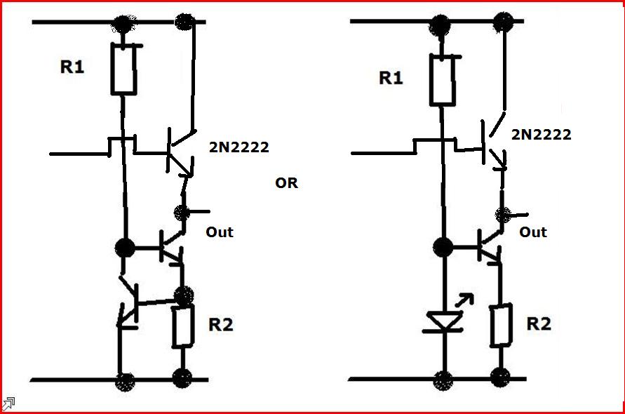

Hmmm... well I'm not quite sure what that would sound like (your LED as shown). It will be very nonlinear... lots of harmonic distortion. It may produce a lot of "even harmonics"... the "good sort".
I've not made it clear enough what I meant with applying the CCS :) sorry I assumed to much.
If you look at my two diagrams the constant current flows in the collector circuit (where the "break is) If you put a milliameter there, then with the values suggested you would find the current doesn't change as you alter the supply. It would be essentially the same at 5 volts or 15 volts or 50 volts.
So the CCS would be inserted in place of the JFET CBS240 suggested in post #23 as shown below.
I used this technique here (this is an all discrete germanium headphone amp).
http://www.diyaudio.com/forums/headphones/160646-germanium-single-ended-class-headphone-amp.html
Don't get confused by the "upside down" look and positive earth and PNP devices... just look how the transistors are configured... and the emmiter follower output Q3. The load for this follower is a CCS formed by Q4 and 5
Q2 and Q6 form a classic two transistor (NPN and PNP) gain stage that's non inverting of phase. You could try that in silicon.

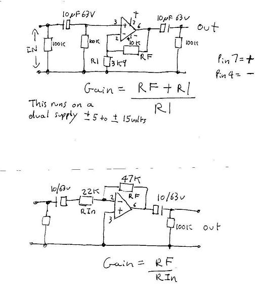

I have a question regarding the polarity of coupling capacitors. I've studied a bunch of preamp schematics using both discrete components and integrated circuits. Some schematics show the input coupling cap in one direction and some have the polarity reversed. I Googled myself silly trying to understand this issue, but came up empty.
For example: Here's a link to a schematic of TL071 preamp that Mooly posted several years back on another thread with the input cap orientated minus to plus: TL071 circuit
And on this web page you can see another opamp schematic with the input cap orientated plus to minus: TL082 circuit

I vaguely remember drawing that...
As I draw them, the empty rectangle is the "positive end". The negative end should really be drawn as a black rectangle.
Now on a practical level, in the circuit in both links the voltage across the cap is actually zero (DC volts) so in a way it doesn't matter here.
If you used a TL071 on a "single" supply such as one 9 volt battery then the polarity is important of course.
With non FET opamps you do get a small "offset" voltage that could be either way, pos or neg, and although only a few millivolts it's worth actually measuring and orientating the caps to suit.
