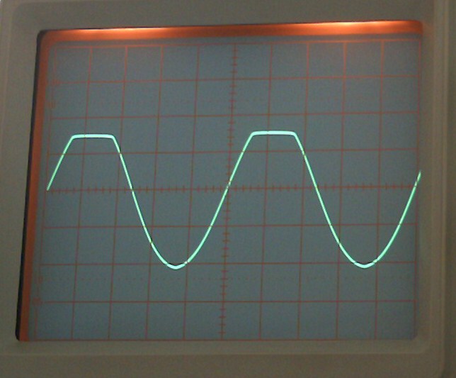

TR2 base current is determined really by the gain of the transistor, but is pretty small. So with no R4 the bias calculation works out OK.
As R4 is introduced, the base bias current for TR2 is still essentially the same, but the extra current flowing through R4 (0.6ish/R4) is "added" to the collector current flowing from TR2, and all this flows to ground via R6.
So that "extra" current is lifting the emitter of TR1... and the effect of that is to reduce the maximum available output at the collector or TR2.
With R4 at the low value of 180 ohms, the DC voltage at the collector of TR2 has to be set to around 9 volts DC by the bias network for maximum undistorted output. This is because the emitter of TR1 is already at nearly 4 volts DC.
It's very much a balancing act... if you could see it on the 'scope it would make more sense in the way that the bias affects not just the obvious "clipping" level, but how it affects the distortion too.
Even on a scope, at low values of R4 and higher outputs the distortion (not clipping) becomes apparent in the lower part of the waveform.

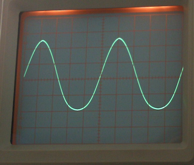

Last two shots showing the distortion.
First one shows the amp isn't "hard clipping" as such, but by altering the bias as in the second that actually gives more "usable undistorted output"
Very difficult to explain :) Get a 'scope ;) lol

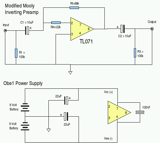

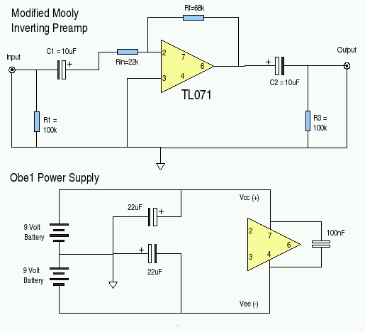

FYI: I purchased a TL071 opamp today and plan on using the following schematic as my first test circuit. As you can see, it is based on your non-inverting design along with my own super sophisticated power supply.

The circuit above wants a little "re arrangement" before it will work :) Rf must go from pin 6 (the output), to pin 2 (inverting input). Everything else is correct.
The thing that may appear strange at first is that you can not "measure" any signal at pin 2.
Can you see why ?
If you applied (for example) plus 1 volt DC to the input (with C1 shorted out of course) can you see what the output will go to and why that appears to give no voltage on pin 2.
PSU is fine (check the battery symbols... ;))

Thanks for checking my schematic. I drew it right on paper, but wrong on my computer. Regardless, I need to fix it.
As to why I won't measure a voltage at pin 2: The answer can be found in your earlier post (as follows):
"Golden rule for opamp design when using feedback (i.e 99% of the time)... the output will do whatever is required to keep the difference in voltage between the inverting and non inverting inputs at zero"
