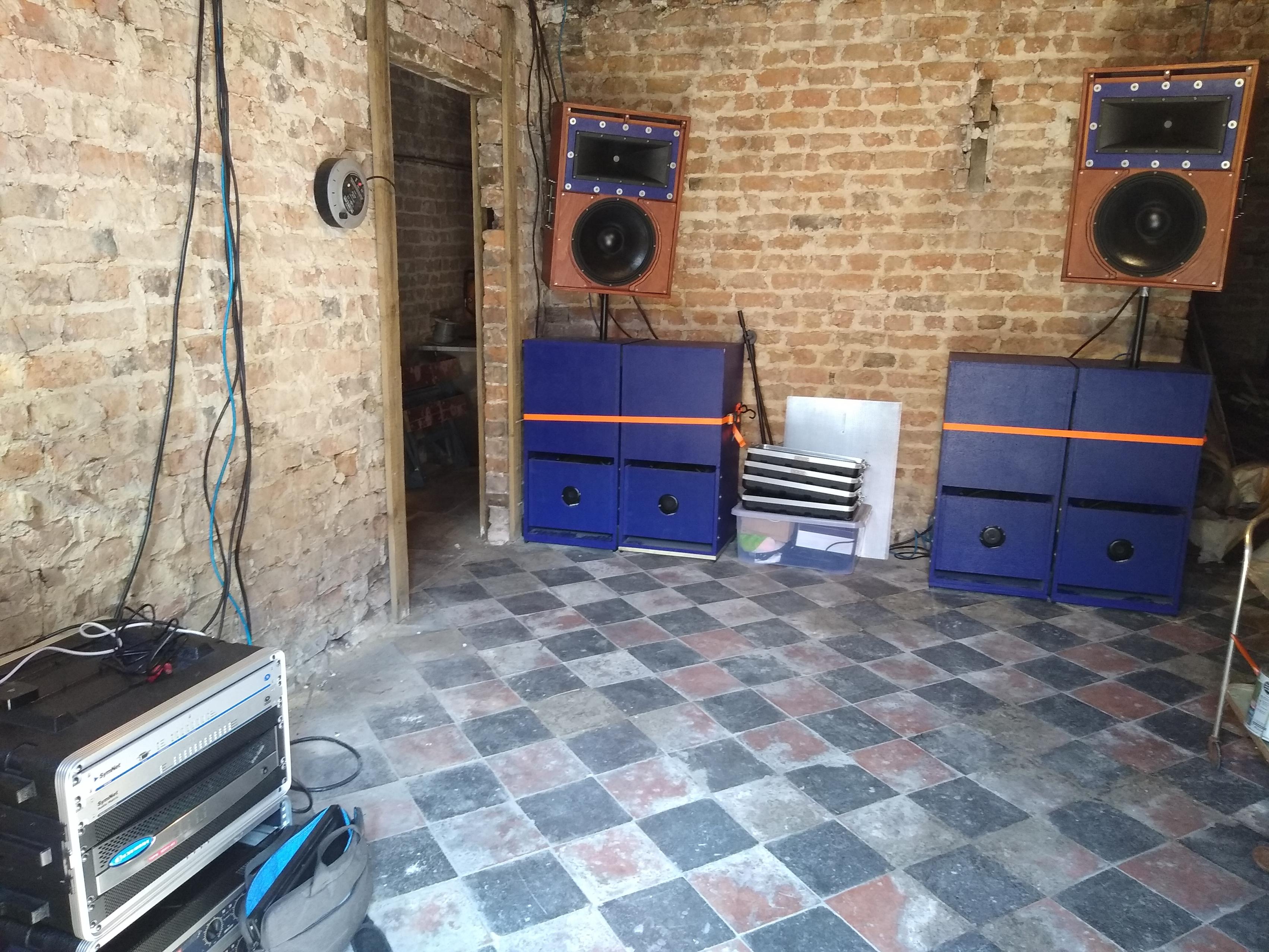

Joined 2007
Perhaps we have different tastes but blurry vision is 140dB+ peaks, to do that it has to be a very very large system or quite a small well sealed space or your head has to be inside a horn or similar. Even 14 FLH in a lossy warehouse space driven by 4*MA5002VZ is at its limit before hitting that kind of SPL on the dance floor. I have only experienced bass this loud a few times; Hidden in Salford next to the ground floor sub stack (void double 18"/21" stack to ceiling height), a ~50 person dance floor with 12*18" reflex subs and the original ministry of sound bass horns (6 Bertha horns with extensions in a well sealed room).
I personally only have 4*15" isobaric reflex subs but will hit their limits sometimes in larger rooms, they would be fine in your room but Its not a headroom for days situation at party levels, even if the mid/treble is at a sane level the bass can be very elevated in electronic music or afrobeat. If you have the space for larger subs I don't see a disadvantage, they will be more efficient, lower THD and capable of higher SPL.
On the floor space point thats also key for me so I build my cabs to have minimum footprint as you can see.
