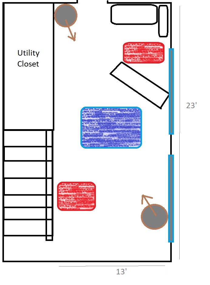

Hi all - finally have made some progress! Looking for some additional help. Here's where we're at: I went with two close approximations of the VBSS (taller and shallower), slot ported, tuned to about 31 hz. They sound great! But I'm having issues with a lack of clarity that I'm attributing to the room and/or my speaker placement.
Attached is a diagram of the current setup. Speaker placement is brown. The bass cabinets are on the floor, the tops are mounted on the ceiling suspended about 3-4" (from 8') and fairly tight against soffit corners. The mains themselves are a DE250 on a small horn with an 8" midrange woofer in a compact sealed box - i.e. there is very little baffle to speak of.
Room itself is drywall with carpet, minimal furniture outside of a wood/metal desk and a wood turntable platform. There are windows (indicated) set high on the walls, they measure 83" x 23". I know these need to be covered, working on it.
Here are my issues:
1. Lack of midrange clarity: I was pretty happy with my mains when listening outside, but now mounted on the ceiling there is a noticeable lack of definition when standing more than 4' away from them. I am guessing it's a reflection issue due to being so tight into the corners, but don't know the best or cheapest way to resolve it. I can lower the cabinets off the ceiling a bit, or I could put some kind of treatment around the corners to mitigate reflections. Which is more likely to restore the clarity? Is there something else I'm missing? What about a bolt-on DIY waveguide?
2. Hot and cold bass spots in the room (colored red and blue). Obviously this is waves doing their thing, but I don't know how to go about spreading the response more evenly. There are hot and cold spots everywhere, I've only colored the most pronounced. I plan to try a less symmetrical bass cabinet placement as a first step, but if there are any obvious mistakes I'm making, please call me out!
I mentioned this earlier but this is intended to be a dance floor, not just a single listening position... that said it would be nice if the sound was best right in the middle!
