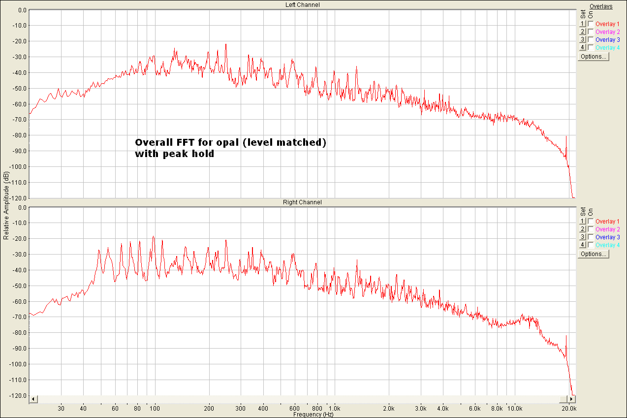

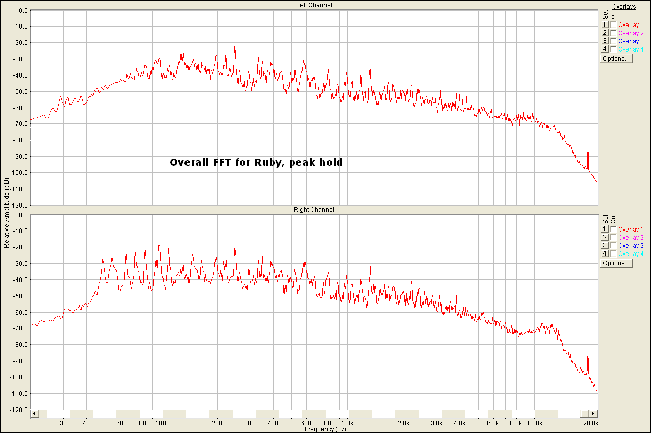

The last one, overall FFT over whole Opal and Ruby with peak hold, both matched in level. It shows absolutely negligible 19kHz component.
In mine, I exported it to a spreadsheet and drew lines between the points. The lines have a fixed width and so show up even if the spectral peak is narrower than a single pixel.
I originally didn't notice that you had used peak hold and so thought your spectrum may be innacurate. Your spectrum may be an accurate reflection of peaks. It's difficult to know if the narrow peaks are displayed properly or not.
I don't know whether the peaks or the time average is a better measure of the potential risk to hearing. It's probably some combination of both.

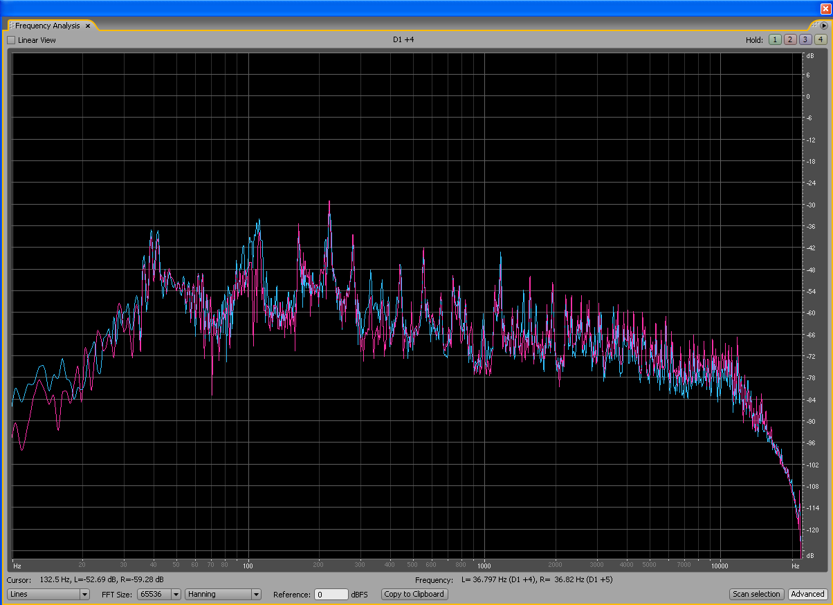

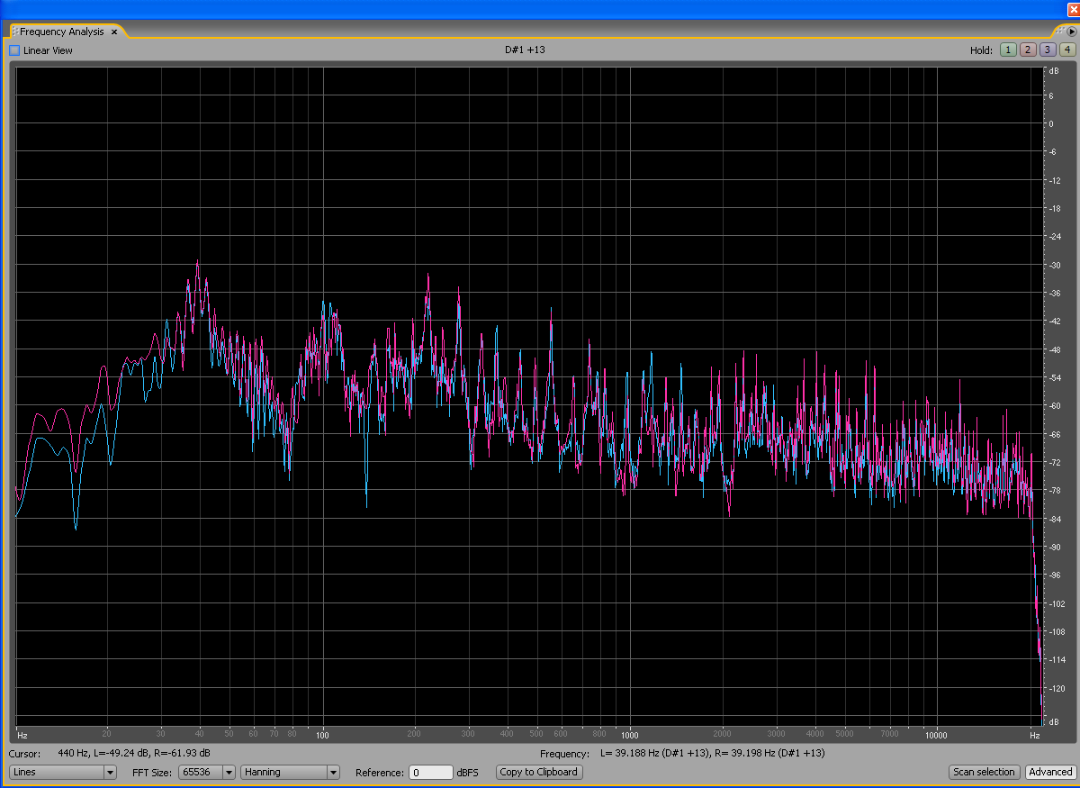

Cassette and CD files for comparison. Level matching is not perefect, it was impossible for these two files. Cassette file is the same as yesterday, so no need to download both files for those who have already downloaded the foot_tapper.
foot_tapper.zip - FileFactory
tapper_silenced.zip - FileFactory
Please feel free to make any FFT analysis, as there is no space for HF noise speculations now. But there is more than enough space for discussion about hiss contribution and high frequency roll-off to sound preferences.
Spectra attached as well.

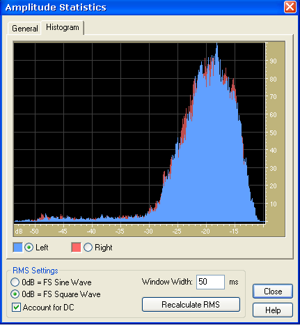

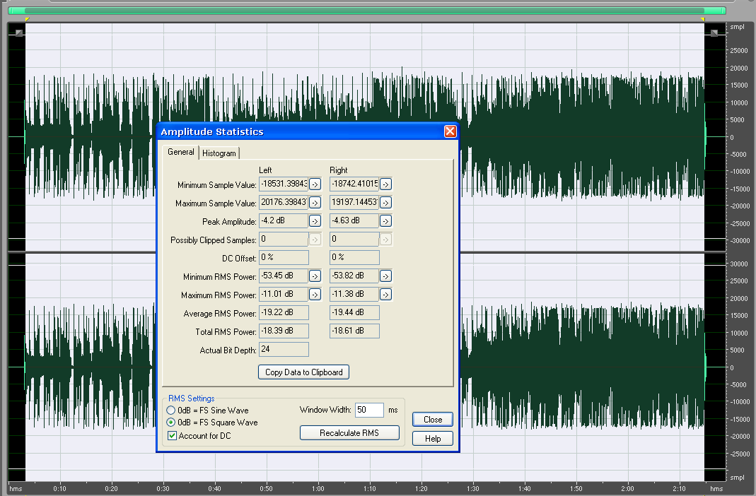

heb1001, regarding ground loops, you hear -125dBFS which is 20dB below overall system noise level, and you hear it in presence of music that is -19dBFS in average? Please try to think over your comments.
I give up as well.
I give up as well.

I don't know the limits of human hearing but if you look in Audacity, someone has helpfully labelled the scale with -120dB as the limit of human hearing which would be -139dBFS with music at -19dBFS and about where the high frequency noise corresponding to the ground loop would be.
If the FFT can resolve signals deep into random noise, why do you have a problem with your brain doing the same thing? The hairs in your cochlea respond to a specific frequency range so your ear is basically doing a FFT anyway. There's no reason why the neurons wouldn't have some kind of time averaging effect. Who knows how it all works in there?
