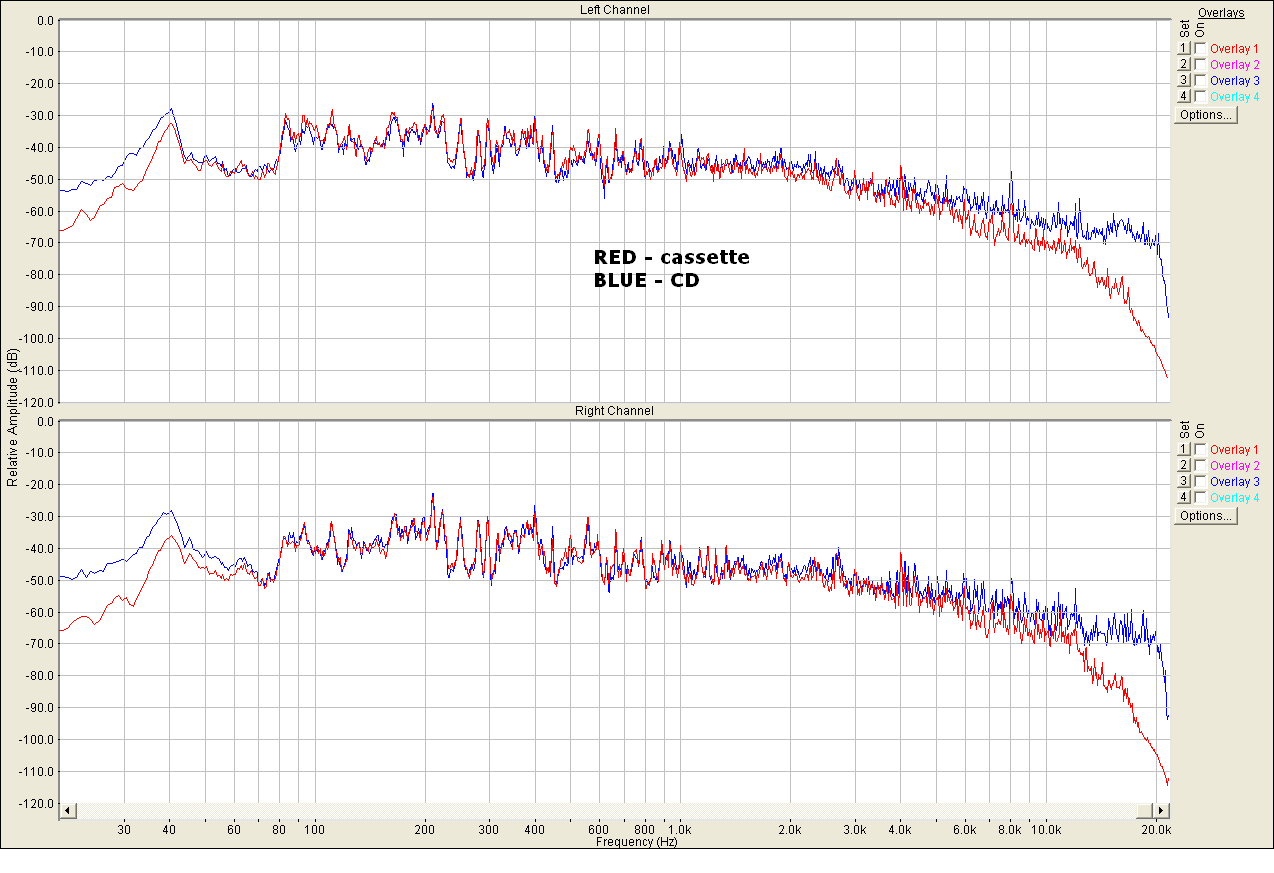

I have posted 2 files recently, record from a cassette tape deck and CD data from the same live concert.
Cassette file has audible hiss, it has measurable roll-off above 10kHz and it has smaller dynamic range. Despite of that, there is a preference (heb1001) for the cassette file. This may indicate why, in another threads, master tapes are regarded superior or vinyl is regarded superior above even hires digital. IMO, it is the smaller information content what is in fact preferred. Hiss (dither) or 1/f groove noise mask the real signal details, + added distortion in both tape and vinyl adds originally non-existent information. I may be wrong, but it is my opinion.

Cassette vs. CD
This analysis might be interesting as a CD x cassette difference. Red line i cassette, blue line is CD. It is that Clapton file that I posted as cassette and CD recordings. FFT over complete song, with peak hold. See how central frequencies are quite equal in spectrum, but both high frequency and low frequency roll-off for the cassette file.
