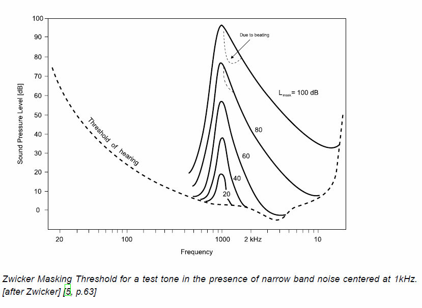

This is why I said its a valid result for you 🙂 Because its how you determine what you like. The whole point of all these tests is to decide by listening, not looking for noise/artifacts or whatever with software.
You go to buy a new CD player or speakers or an amplifier... you listen... its how you make your choice.
And you probably know why I was asking you. Our debate on -125dB/50Hz spectral line, a groundloop product in my setup.
Now, my test was only -100dB/1kHz, no masking music, no masking noise, and 1kHz is much more audible for human ear than 50Hz.

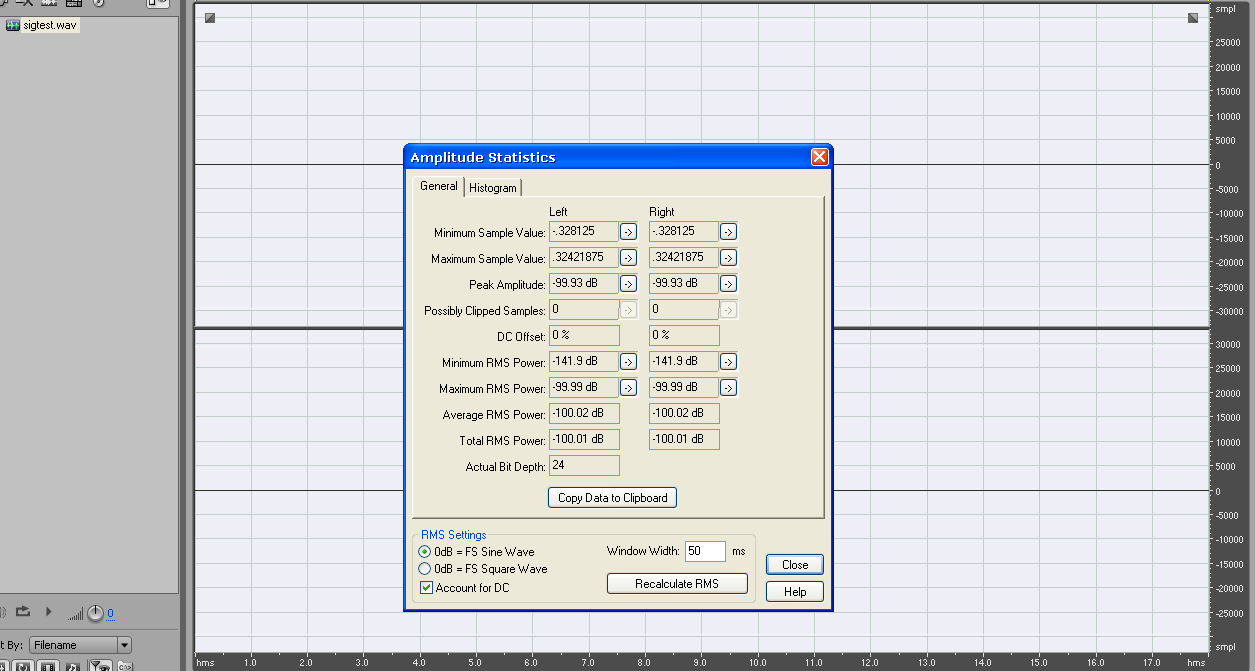

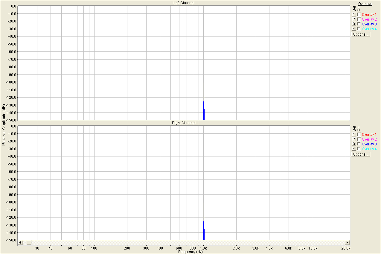

I know that test. But this one was single tone in isolation, without masking effect of the music. And previous arguing in another thread was about -125dB/50Hz (within music) 😀
-100dB/1kHz should be audible from speakers if one puts volume up. It is a 24dB file, no noise there.
In my setup, I end up somewhere between -110dB and -120dB with SACD (Philips DSD test disc) for a single tone, preamp + amp + speakers.

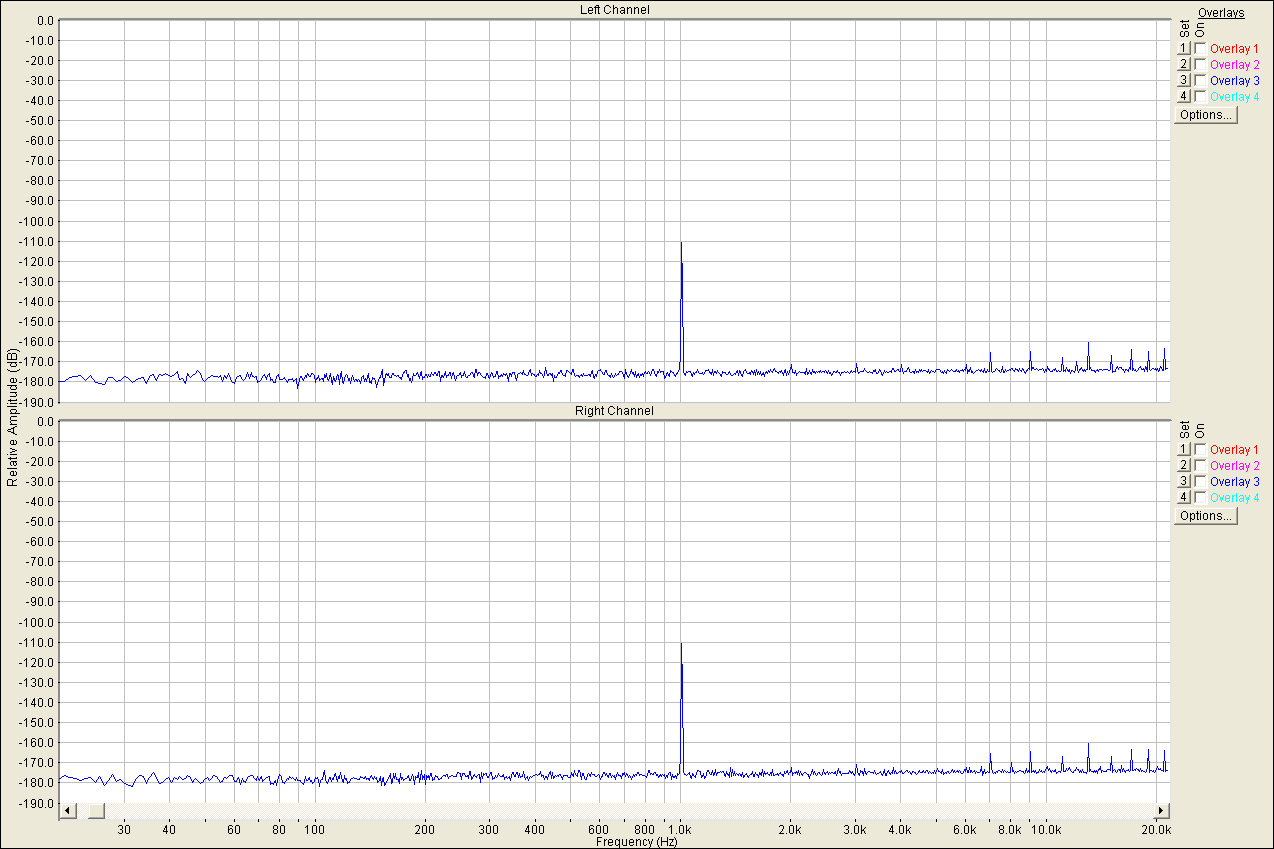

OK, here is the -110dB test tone.
https://www.dropbox.com/s/7v6el9m5r1i0ejy/sigtest110.wav
It has some -160dB artifacts and only about -175dB spectral noise density bottom, maybe you or another golden ear will hear it.

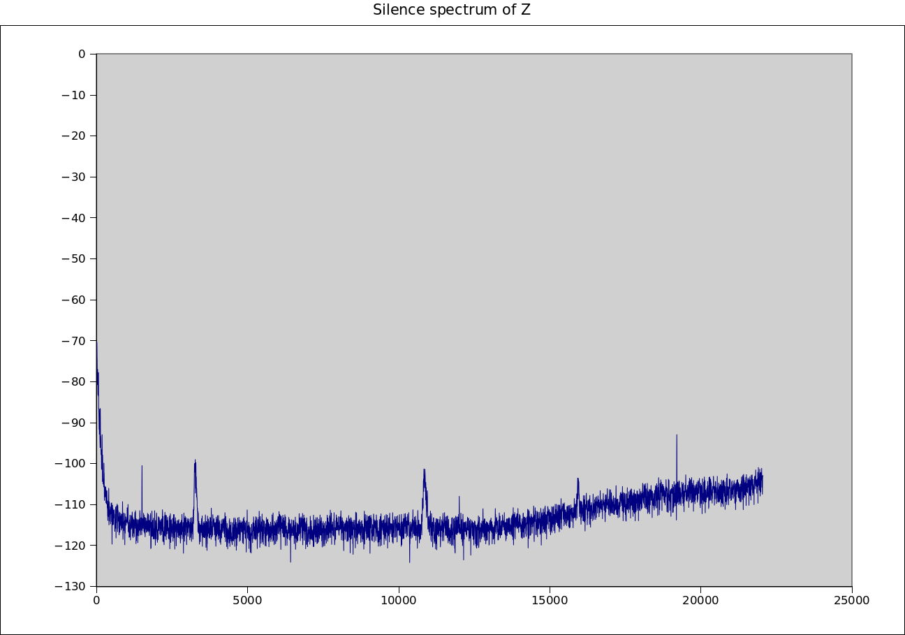

I just tried a 10kHz test tone at -60dB with 2kHz interference at -100dB. You can't even hear the 10kHz test tone over the interference let alone say whether it sounds clear or not.
So if your minidisk player is introducing -100dB noise at 2kHz it has effectively wiped out all the HF content below -60dB and significantly impacted the quality of much more than that.
The silence spectrum of Z shows noise introduced at 3kHz and -100dB see picture.
So, as I said, fairly pointless to consider this a valid test of the ATRACK compression standard.
