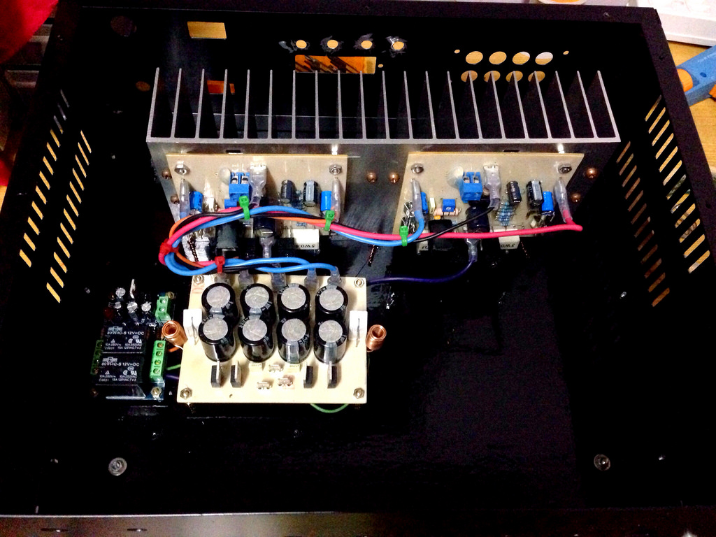

I also did a 'clone' of the AKSA. It's not exact because I didn't have all the information at the time and when I did have it, I couldn't reveal it, but my design has component values that are quite close to the original and may provide you with a good starting point for your own experiments: http://www.diyaudio.com/forums/solid-state/140461-tgm-amplifier.html
go to post 356 for the as-built schematic and don't ignore the needs for a good power supply.

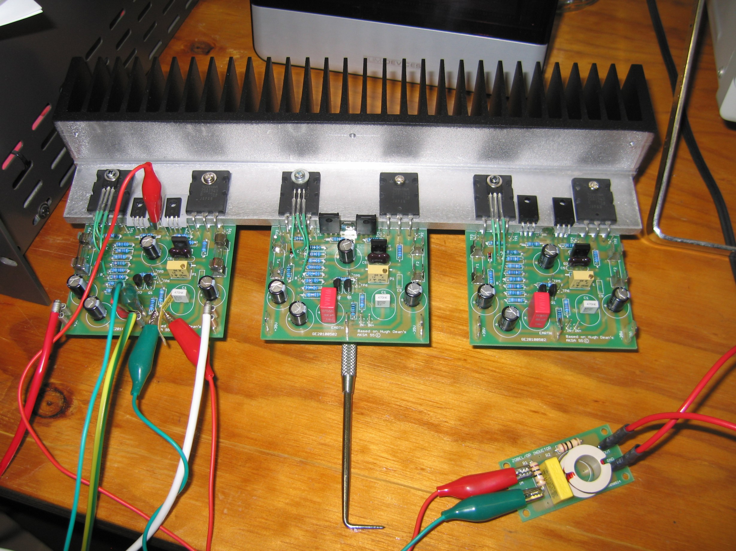

Planning to finisch my BAksa with special thanks to Greg Erskin the boards are provided by him,question regarding the trimpot.Normaly it is 2K2 but can I use a 2K ?
Hi meanman1964,
Great to see you are nearly there.😀
Here are the values that I am aware of from a couple of real AKSA 55s and my BAKSA 55.
Note: R12 and R12B are in series and I believe the 2 resistors in series were used to allow fine tuning/tweaking.
R11 (AKSA and BAKSA) = 1k5
R12 (AKSA and BAKSA) = 330
R12B (AKSA and BAKSA) = 150
P1 (AKSA) = 100
P1 (BAKSA) = 1k
I think the 1k shown on the BAKSA schematic is actually a typo, but if you look at the photos you can see that I used 1k pots.
Using a 1k will make the fine adjustments of the bias a little more difficult but it is still doable.
If you use a 100 ohm pot you may need to adjust R12/R12B.
Looking at AndrewT's last post (and including R12B) I think the values of the original design are correct.
regards
Greg

Sorry for the miss understanding but I messed up two amps.The question was for the ANC340 of Greg.😱
I think you are one of a few that knows about it....and probably the first to build it.
a 2k2 probably has a tolerance of +-10%
Your 2k is nominally inside that 2k2 tolerance range.
Use it.
I agree. Try the 2k and let me know.
