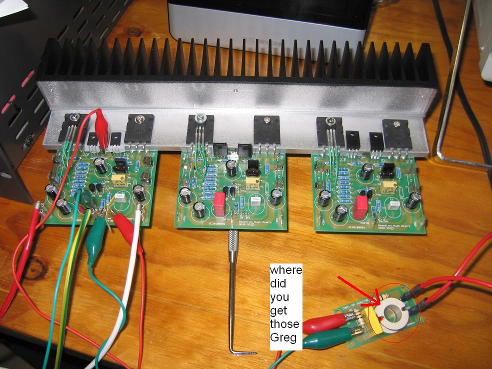

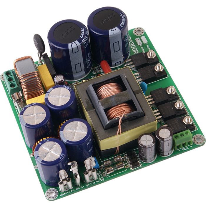

I'm testing with an SMPS right now.I'm happy with the result still having this strong bass.
Yes! Greg we do.
For the drivers I used the BD139-140 combo,C3503 for the VAS and the C5200/A1943 as output trannies
2SC3503 have high Early Voltage (Bob Cordell model) and low Cob. It will give low THD in the range of audio frequency.
For drivers I will choose high hFE like 2SC5171/2SA1930 or 2SC4793/2SA1837.
Before I perform a test I'm wondering of this 300Watt SMPS is enough to fire up 2 channels
For 75W/4Ohm, I think 300W is enough for 2 channels.
