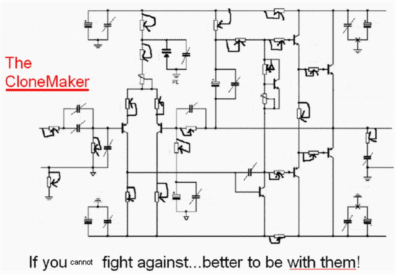

Mr. Hugh Dean is so famous that some brazilians thinks he should produce
the Universal amplifier..... called, the CloneMaker.
Because so many guys are interested in his designs, in this lovely tophologie, that he should explore this.
The CloneMaker will realise the DIY dreams to have his own amplifier...so..he can tweak currents and change values of resistances and say that "he did his own amplifier".
This is the solution i think.... to provide forum and the audio communitty, the chance to have their own...you see how many copies, clones, or versions where made...if this is what people wants..why not to give them.
I really think, this can generate lots of money.
The idea came from Renato Comerlatte... i am glad it came from Brazil (despite the guy is half Italian)
The schematic was attached... the idea is to provide board, parts and trimpots...the Universal Kit...the CloneMaker project.
I will help Renato to produce the CloneMaker.... will be distributed (in the early beginning) for Brazil only.
regards,
Carlos

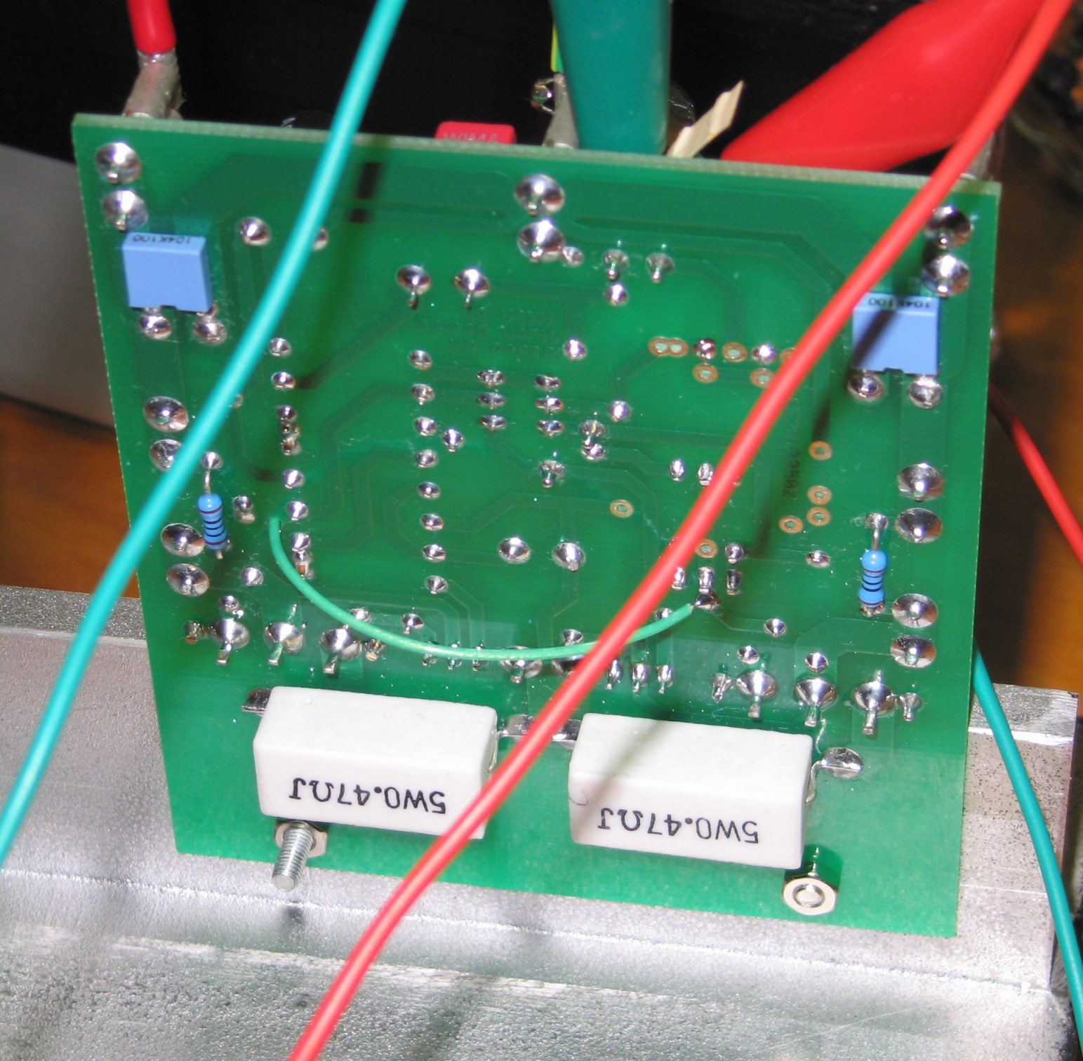

Greg, comparing this picture to pcb you give (in pdf), a question came me : how did you connected Q4 emitter on real PCB. Wire seems to go on left pcb side as on pdf it must be connected near Q3 emitter?
Marc

Hi Marc,
Sharp eye
regards

Hi Marc,
Sharp eye. Have a look at the green wire in the picture.
regards
Thanks for clarification.
Marc
