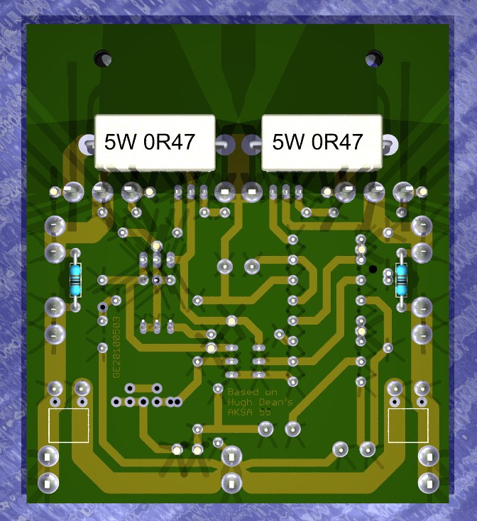

Here's a PDF of the PCB.
Greg, thanks for sharing the layout. A few (major and minor) quibbles:
1) How are the emitter ballast resistors actually fitted? The traces for these seem to go
off the edge of the PCB.
2) Space for input coupling capacitor - probably not enough for a large axial-lead device, even when mounted vertically.
3) the length and width of the resistors, especially R9, the feedback resistor. It would help if they were wider and longer, to help accommodate 2W Kiwame/KOA-Speer carbon films. There's enough space on the board, by moving around a few parts and traces, to make this possible.
4) It would help to leave outlines and unconnected pads for a few uncommitted resistors and silver micas, for those who might want to experiment with different compensation schemas, including Hugh's unpublished addenda to the basic AKSA schematic.

Thanks for the feedback. I'll keep them in mind if I get some more PCBs made. I haven't planned on that at the moment. Also, I am restricted to 100 x 80 mm PCB size by my Eagle license. I can't justify the cost of a license for a non profit venture.
The emitter ballast resistors are just soldered under the PCB onto pads without holes. This is pretty much the way Hugh did it on the original PCB and it really helps keeping the PCBs size down.

A quick look at the pcb (it does bear a resemblance to the original !)
a) are there film decoupling caps to the supply rails ? if not, perhaps there is space in front of C10 and C12
b) Hugh didn't include a dc offset adjust pot in AKSA and I followed this with my TGM amps. But I later found it a PITA, causing me some desoldering/soldering. So I wonder if it's worth adding a pot in parallel with the LTP load resistor to allow for some easy adjustment.
c) For the feedback cap do you want to use a bipolar cap to avoid the need for protective diodes across it (which you might want if using a polarized electrolytic in that spot) ? A smaller bipolar for C2 would create all the space you want to put a pot across R3 for easy dc offset adjustment.
d) In the very unlikely event of output oscillation the zobel resistor will get warm (or even quite hot) and it can help to size R19 a little large to allow for this
For TGM I did the same with the output emitter resistors, it's a very smart choice but I did include holes in the pcb as this made soldering them in a little easier

Hi Gareth,
Thanks for your comments.
Not quite as nice as the original.
Have a look at the under-PCB picture a post or 2 back. Those squares are them.
The first 2 amps had single digit DC offset. Best I have ever got. The one using BD139/BD140 is another story.
I'm using a 22uF WIMA at the moment. It should be better than a electrolytic, but I will be testing some to see.
I do have 1 watt resistors on the external zobel. I have been measuring the temperature of all the components of this amp. The zobel/inductor network don't increase temperature at all, well they must a bit but not even a degree.
These resistors are directly under the heatsink ledge, so having holes in this case is risking a short.

any particular reason for this choice of output topology?
Hi Pete,
Who is this question directed to?
If me, I am just following what the original had, to a degree.
regards
Peter,
The Self EF II is simple, and it works very well particularly when tweaked with charge suckout network. The DEF is widely used in pro-audio because it is reliable, stable, and good sounding. If we ignore single ended topologies, the only other choices are triple EF, which is very good but can be difficult to thermally stabilise and in any event best on multiple output pairs, the CFP (when stabilised very tetchy to bias and sounds ordinary) and the diamond buffer, which features a high bias regime for the drivers which is inefficient and requires two current sources, added complexity.
Answer your question? All were built and compared, BTW.
