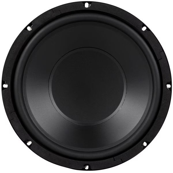

10" MCM 55-2972 $11.38 usd

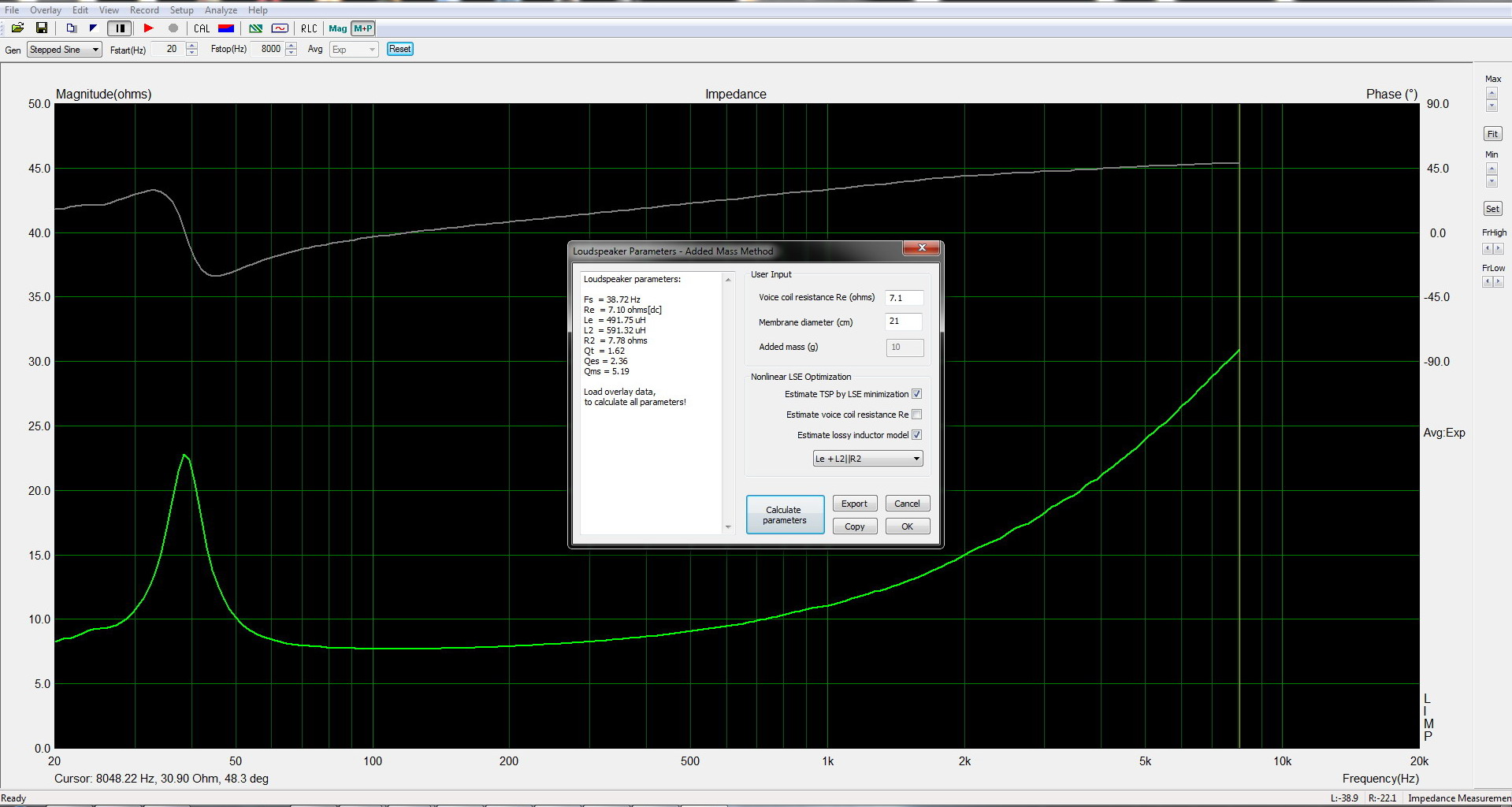

from MFK ,"Distortion data for a 1 watt and 5 watt inputs... (1 watt from 10 Hz to 3 KHz and 5 watts from 20 Hz to 1 KHz) Also, impedance and frequency response. Frequency response was measured with the drivers in open air, no baffle."
https://www.newark.com/mcm-audio-select/55-2972/10-woofer-with-poly-conerubber/dp/80R7011?st=10
MFK graph, QTS 1.62, Vas ?
MCM manufacturer graph
QTS .4516, Vas 82.27 litres
The specs are different MFK vs MCM manufacturer.

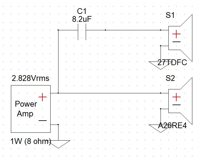

SEAS A26 Tweeter substitution and Revised Crossover
https://techtalk.parts-express.com/...26-tweeter-substitution-and-revised-crossover
https://hificompass.com/en/speakers/measurements/seas/seas-a26re4-h1411
I've been looking at 10" woofers for a Devore Orangutan, Seas A26 alternative.
Could the 55-2972 be used? With a high qts (MFK measured @ 3.5 times(!!!) the published spec). Any suggestions for a box?
Open baffle or open back box only possibilities?
Anyone use the 55-2972 woofers?

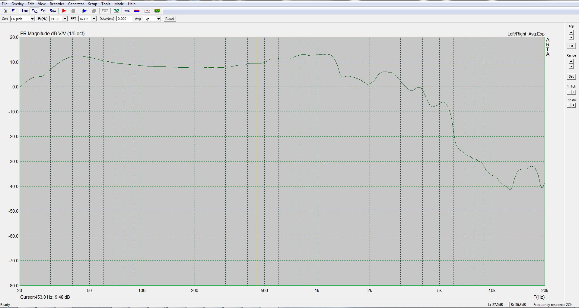

Attached are in-box measurement of the woofer. One is distortion the other is gated. As I said, I wouldn't be afraid to use it all the way to 1K. It might even do well as an old school 2-way using the top end roll off as the crossover.
Sorry for potato quality pictures but its all I have (I think).

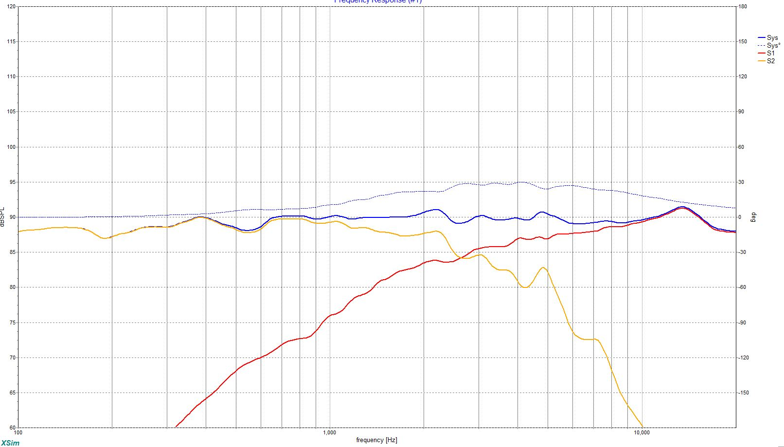

Here’s a new example of using a notch filter instead of a low pass. This system uses a GRS 8SW-4 woofer, which for the price it’s a steal, especially considering not only is it an affordable 8” woofer with 6mm Xmax, it also has sufficiently smooth midrange response out to 3.5K, that in a pinch, you could use it with no crossover components at all.
This is the woofer’s response in a 21 liter sealed box with no crossover:
I’m crossing it to an Audax TW0034X0 which is an updated version of the classic HD13D34H from the late 1970s. 34mm dome mid-tweeter. This is the response...

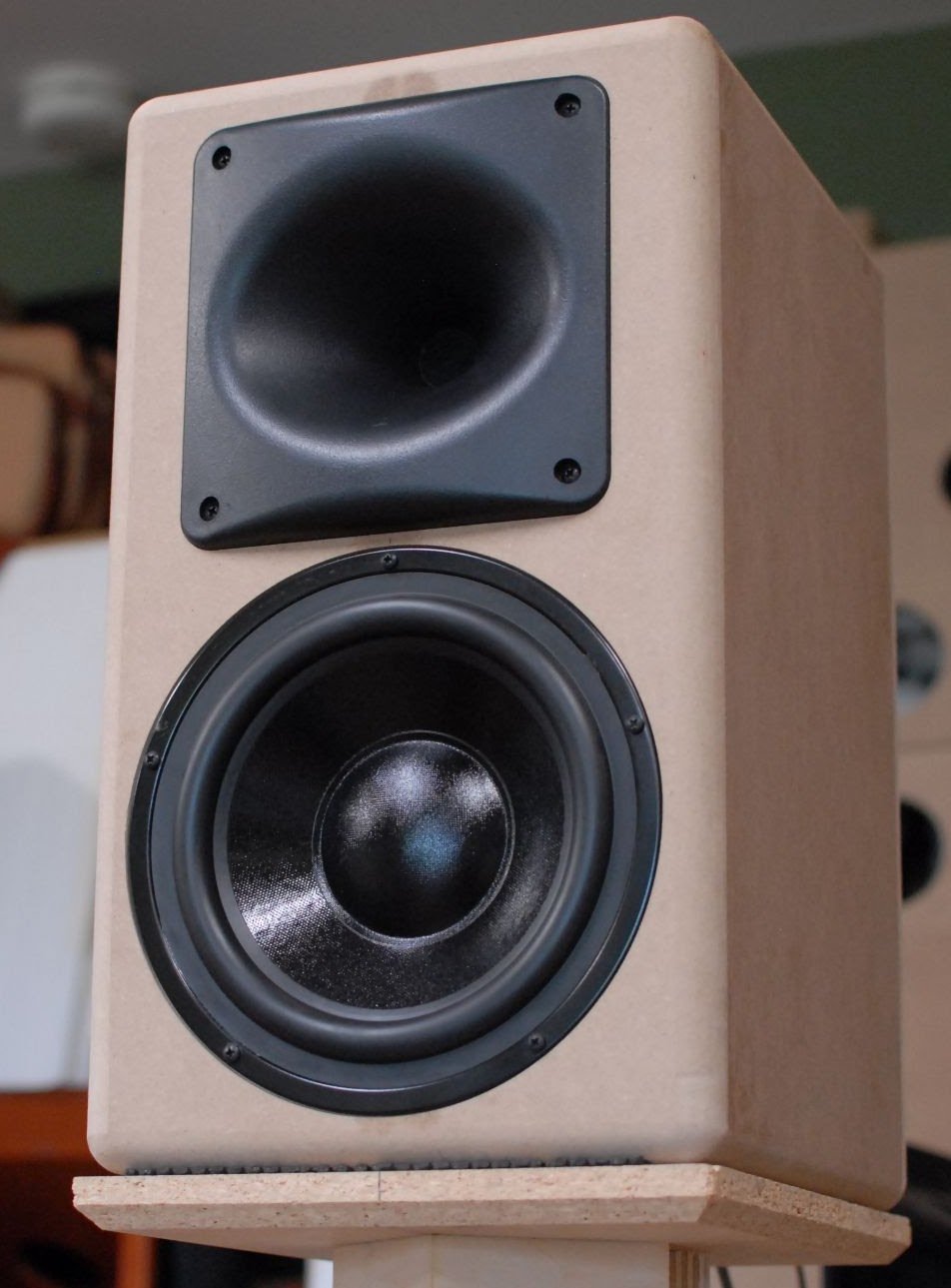

8" MCM 55-2960 $19.33 usd Newark
https://www.newark.com/multicomp-pro/55-2960/woofer-8-die-cast-professional/dp/13T7692
from Mike Chua
https://ampslab-spk.com/2018/04/27/mcm-55-2960/
https://ampslab-spk.com/2018/05/26/mcm-55-2960-fountek-fe85/
https://ampslab-spk.com/2018/05/30/mcm-55-2960-pyle-pds442/
looks like a built in BBC dip
Ported Box = 25 liters. Baffle Width = 13.5″
No crossover is used. Audition with woofer in RAW state.
Mid-Bass (80Hz-125Hz) – Dynamic. Detail. Tight. No Bloom.
Low Bass (40Hz) – Audible. No Bloom.
Vocals (125Hz upwards) – Sounds Flat. No audible peaks.
Bass and Vocals Balance – Good. Bass doesn’t over-power voices.
Despite the widely different Thiele & Small Parameters, the MCM 55-2960 sounds perfectly fine.
Suitable for PA and even HiFi. Fantastic value for $15.21.

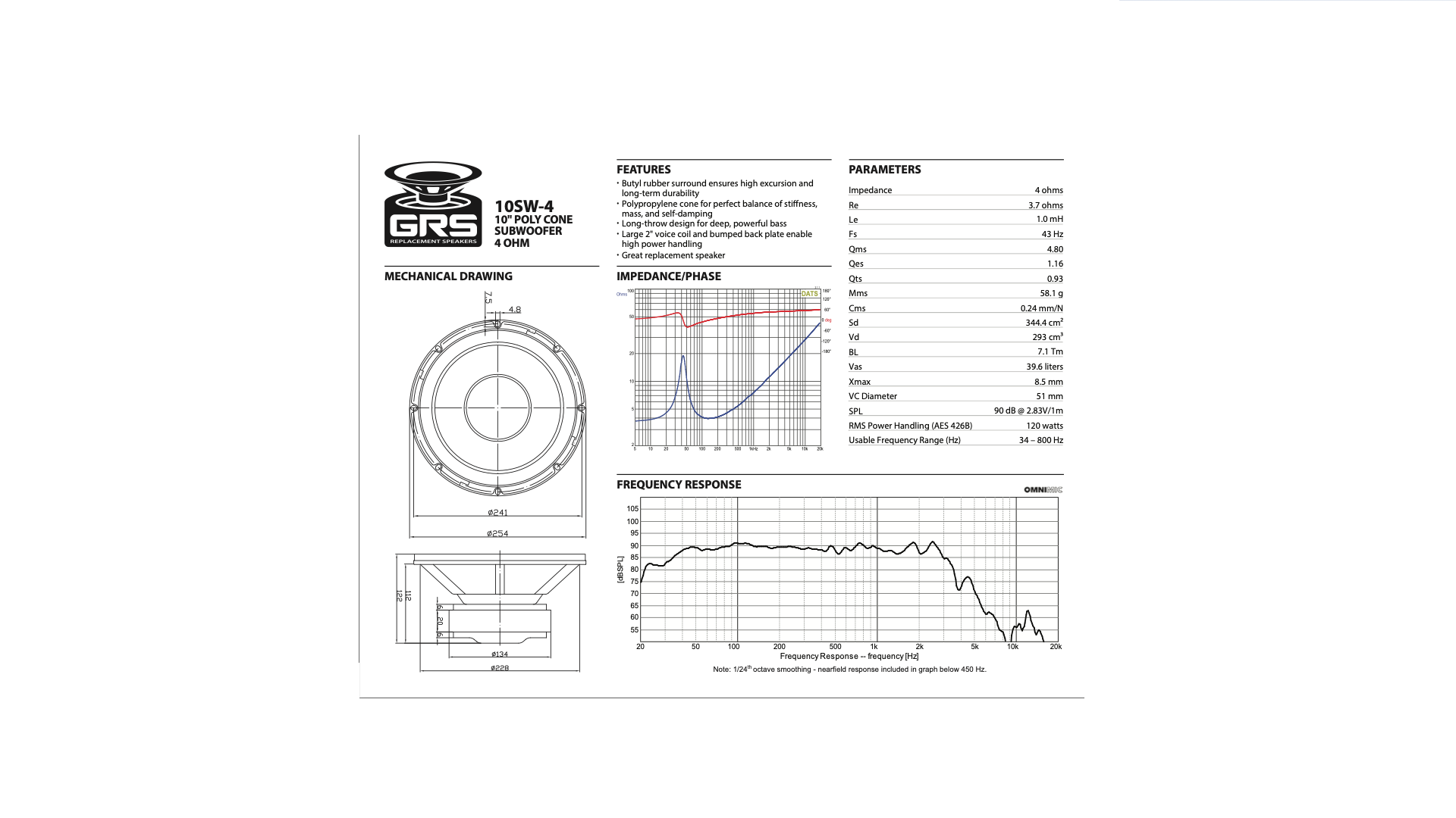

It would seem that there are some CHEAP drivers that advertise/claim to be subwoofers when they are not actually so.
My opinion is that the Fs & QTS of this driver means that it is NOT a subwoofer > The price however is SUPER DOOPER LOW !!!
Thank You 🙂 Perry Marshall, for your measurements of the GRS 8SW-4 Subwoofer.
I was stuck looking at the specs where it says,"useable frequency range 40-800 hz" & "Subwoofer"
Perry Marshall, "it also has sufficiently smooth midrange response out to 3.5K, that in a pinch, you could use it with no crossover components at all."
I was wondering what's correct (if anything)? The freq response graph looks correct (Manufacturer, PE Board -Drew & Perry Marshall)

Don't believe the marketing description, believe the measurements.Thank You 🙂 Perry Marshall, for your measurements of the GRS 8SW-4 Subwoofer.
Yes you can use it as a cheap sub, it has a good Xmax, and I've used it that way before, but it's also a perfectly competent bass mid.

Another GRS "Subwoofer", that doesn't look like a Subwoofer. PE $21 usd
GRS 10SW-4 Subwoofer 34-800 hz
https://www.parts-express.com/GRS-10SW-4-10-Poly-Cone-Subwoofer-4-Ohm-292-482?quantity=1
https://www.parts-express.com/pedocs/specs/GRS Spec Sheets/292-482--grs-10sw-4-spec-sheet.pdf
Would those two peaks @ 1800 to 2500 be objectionable?
Could this work for a minimal, no crossover woofer like Devore / Seas A26?
vs
Seas A26
https://www.madisoundspeakerstore.c...s-prestige-a26re4-h1411-10-paper-cone-woofer/
Madisound $224 usd
vs
Seas A26
Madisound $224 usd
Hmm, assuming you want a high XO point and/or low order XO, then 34400/pi/5.1 = ~2147 Hz VC dia., so a $0.98 tweak to cover over the dustcap's glue joint should damp the ~1800 Hz and adding some acoustical damping to the dustcap should quell the ~2500 Hz or personally would just cover the whole area as required or suspend a damping disc in front of the driver.

While perusing the madisound site I bumped into their Black Friday sale. @perrymarshall had mentioned that the Satori TW29 Beryllium tweeter were outstanding but they are still pretty expensive at the $329 each sale price. So I consoled myself with $35 SB26ADC tweeters instead (which are still a bargain at their regular price). I have a WG to try on them. The Dayton ND25FW tweeters were too cheap to pass up on sale for @ $8.50 each, so I grabbed a couple of those at PE. I expect we won't be seeing these prices come next year with talk of tariffs but fingers crossed. The SB20PFCR30-8 are a great deal too at $35 but not sure about the 5db drop at 900Hz.
Blu Tak turns hard and exudes a hard glue like substance after long enough.
Maybe the GRS 10SW-4 Subwoofer is useable with a small coil or just ignore the 1800-2500 hz peaks.
