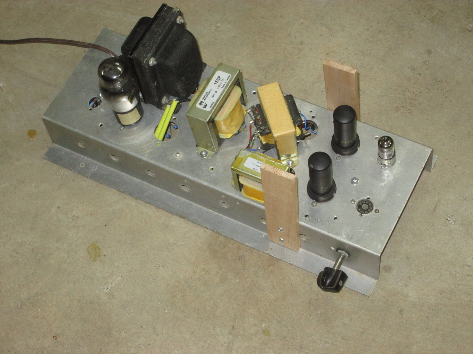

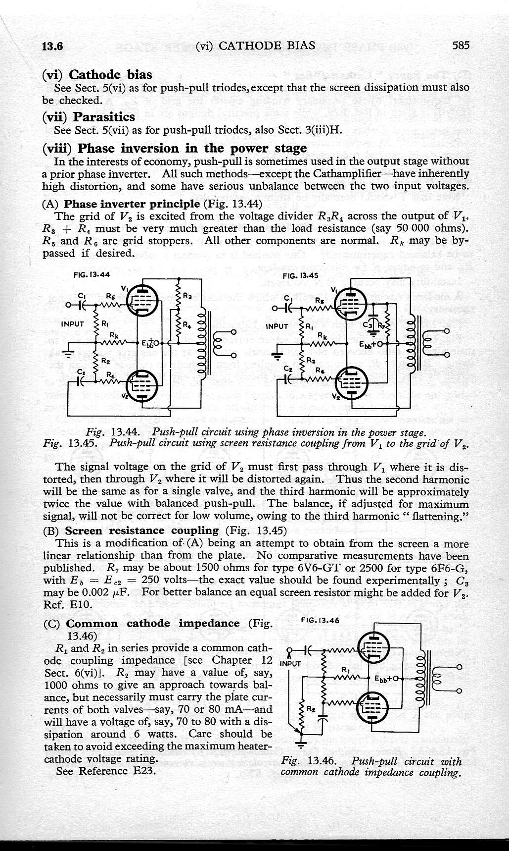

250R to Common Self Inverting Amplifier Popular Electronics.jpg59.8 KB · Views: 102

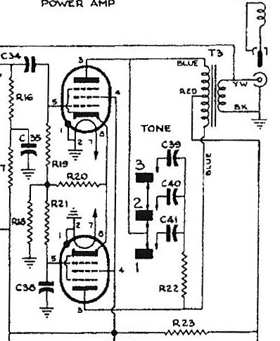

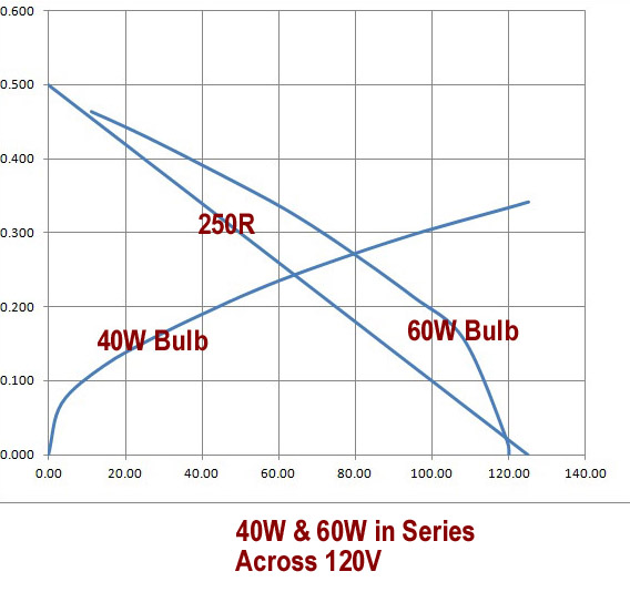

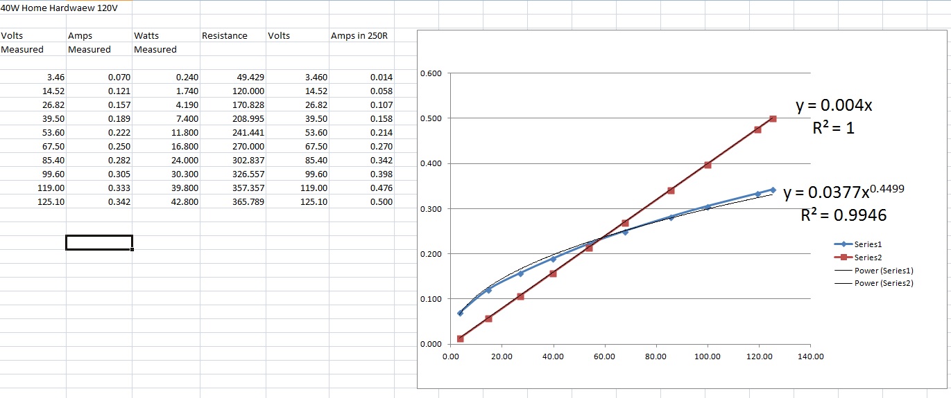

If I remember correctly, a 25 Watt incandescent light bulb is very similar to a ballast.
It has a very unstable resistance, depending on how much voltage you put across it.
Sez who? Here is an example, a 40W tungsten incandescent bulb compared to a 250R resistor on the same scale. Resister is a straight line while a tungsten filament lamp increase resistance as the temperature rises.
But stable at operating temperature. Otherwise our lamps would be randomly flickering. They don't.

A 5% 1000 Ohm 25 Watt wire-wound resistor at standard temperature, resistance will be from 950 to 1050 Ohms.
If it dissipates 0.0 watts, or if it dissipates 10 Watts, the resistance will change much much less than an an additional 5%.
I call that a stable resistance. Stable resistance within its power dissipation limits.
In my amplifiers, I generally use a 3:1 to 5:1 rule. I use a resistor that has a power rating that is 3 to 5 times the power that it will dissipating. Cool, man.
A 25 Watt incandescent lamp, as I said, is not a stable resistance. The cold resistance is one thing. The resistance when it dissipates 25 Watts is another thing.
Now try 10 Watt dissipation.

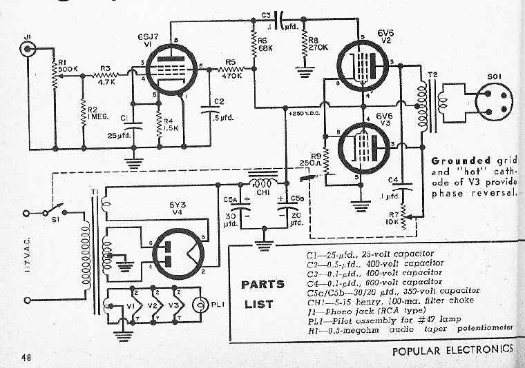

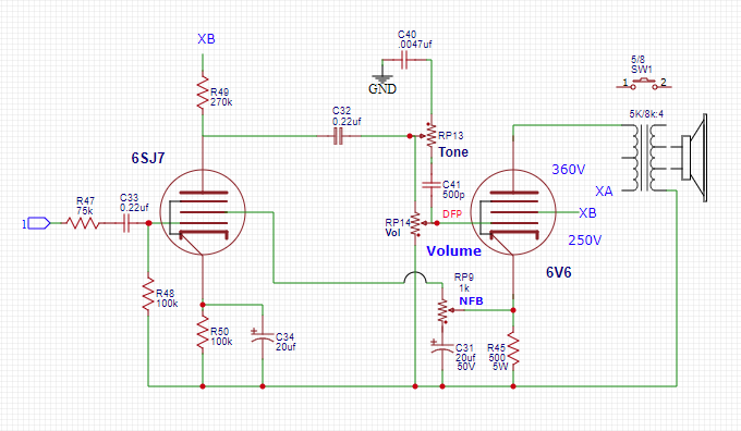

Very interesting!
SE output stage very similar to what I've been playing with the 6P6S, triode wired, exactly the same values for bypassed cathode, but I settled with diode bias at -25V, with B+ of 370V to keep within the 6P6S ratings (if I recall, slightly better than 6V6)
I really like your feedback network.
I didnt think to take feedback in such a way, and I am curious to try it on my own circuit!
no pentodes for input stage though.. maybe a cascode stage instead...
Got me thinking how to morph that input stage into cascode...
I ran the 6P6S in almost exactly the same conditions, in my circuit, but with added plate to grid feedback, and in tetrode mode, or triode mode, the THD was very similar, albeit at slightly different power outputs, so I expect your circuit performs well!
(I dont know how effective the feedback is on the THD, as I have never used it in that way)

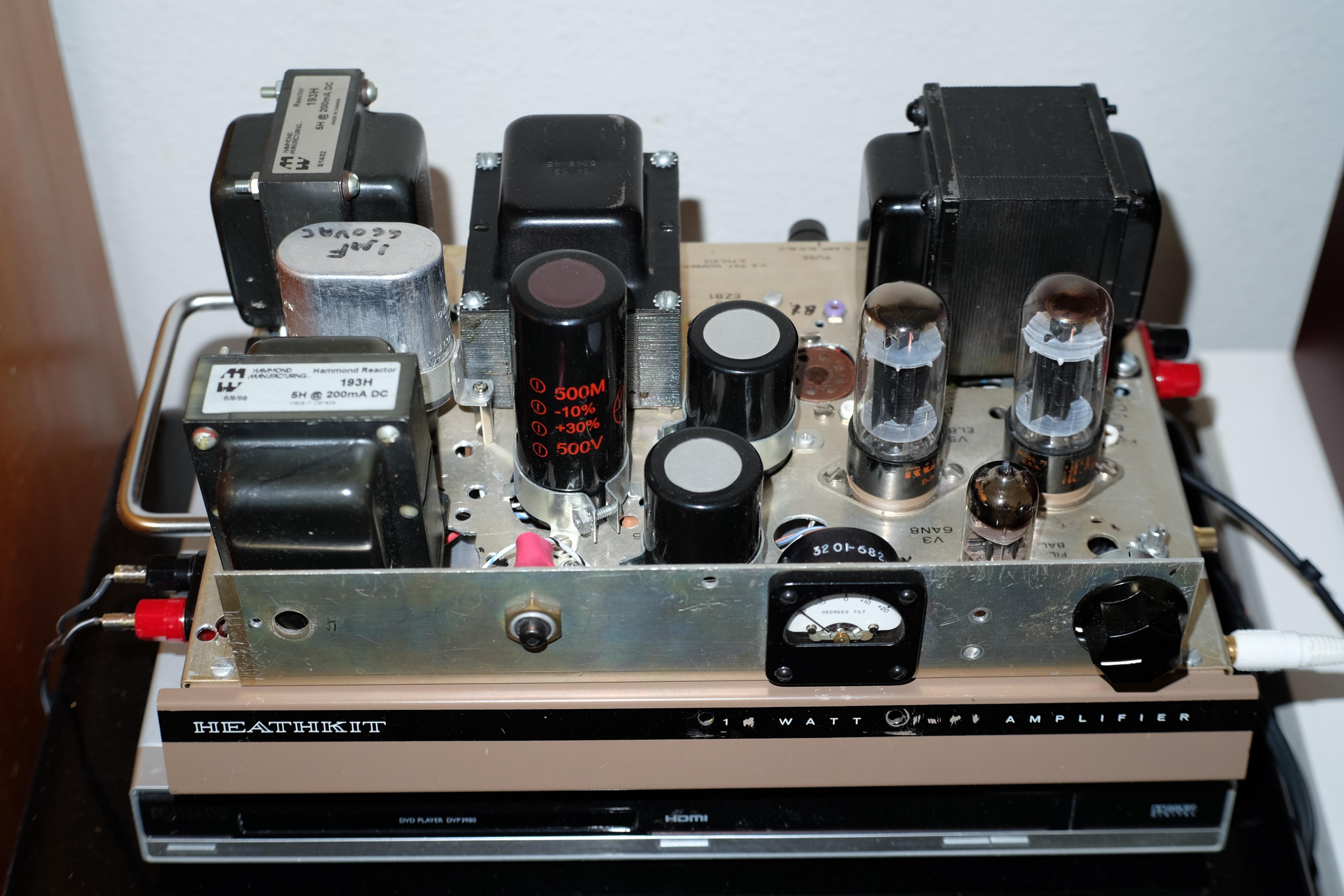

This is my only remaining self inverting push pull amplifier.
It has a 6C45pi triode driver, and two 6CK4 triode output tubes.
The constant current sink for the 6CK4 cathodes is a 200mA 5H choke, in series with a resistor to get the quiescent current I want.
The 5H choke was the best I had for that application, it was better than the 100mA 20H choke I had (the 20H saturates at bass frequencies).
The constant current choke needs to work all the way down at Bass frequencies (When used as B+ filters, chokes only have to work at 120 unidirectional alternations).
There is a 25 Ohm pot, the wiper connects to the constant current sink, the ends connect to the 6CK4 cathodes, so the plate currents can be matched in the Fisher 500 push pull output transformer. That keeps the OPT core from early saturation.
6CK4 tubes were selected to be close enough so that the 25 Ohm pot can 'finish' the DC current balance.
Sorry, the power transformer and chassis are all that remains of the original Heathkit amp.
(Nobody ever took an old 49 Ford, pulled the engine, and the rest of the running gear, and put in a V8, transmission, beefy suspension, radial tires, and differential to match) Right?
I am listening to the amp I described above, that you see in the picture.
The CD is of Rebecca Pidgeon "The Raven" Chesky JD115 on an Usher S520 2 Way Loudspeaker, 2 feet from my ear, next to my computer.
Sounds good to me.

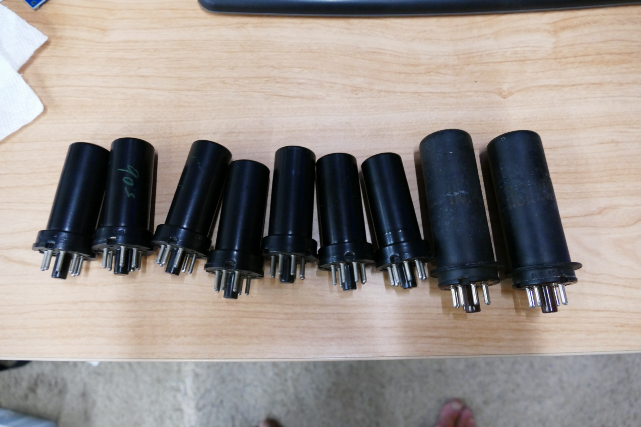

Those are metal 6V6's. The 6L6's are taller and fatter.
I blew up several dozen NOS metal 6L6's in high school electronics class, all furnished by the USAF. The teacher even bet me that I couldn't make the outside metal envelope glow red. It stunk up one whole wing of the school, but I won that bet.
I got a box full of metal tubes for free at the Dayton hamfest a few years back. These are slated for MetallicAmp, a guitar amp that is All Tube....No Glass! I'm leaning towards two independent output stages with a pair of 6V6's in each. I can get 30 watts per pair from these easily in AB2. All 8 have been tested at this level after I verified the design with some old glass RCA's where I could watch for hot stuff.

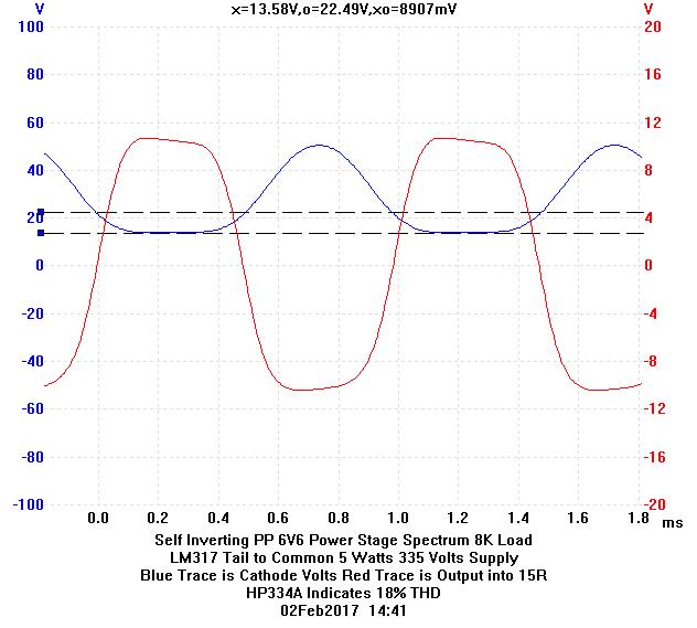

One "advantage" of a self inverting push pull amplifier is that as long as you do not drive it into clipping, it is all Class A.
Somebody says, Only Class A?
How much power does it put out in Class AB?
I tell them it puts out 2X the power in AB as in A.
The same peak voltage out, but 100% clipping, a square wave, hence 2X the power.
I have to remind them that I only listen in Class A on that amplifier.

I have been criticized by some for "ruining" a "priceless" old Heathkit amplifier.
Just do not tell anybody that I have a Dyna Stereo 70 that has been a mainstay test bed for many push pull, single ended, DHT, Beam Power,
and Pentode amplifiers (Mono-Block and Stereo too).
The (ugh) Steel chassis and Power transformer are all that remains of the old ST70.
Well, I did keep the Dyna output transformers too.
I took one of them and re-stacked the laminations, E's, Air Gap, and I's. It is currently on another Heathkit chassis, it is a single ended KT66 with the screen tied to the primary's center tap (50%). Not Beam Power mode, not Ultra Linear Mode.
But there is a screen switch, I can use 50% mode, or full Triode Wired mode.
More fun to try silly things.
