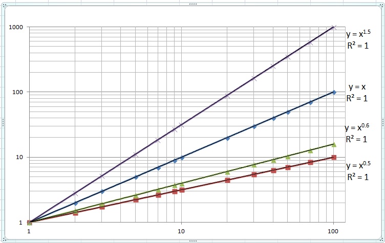

If I remember correctly, a 25 Watt incandescent light bulb is very similar to a ballast.
It has a very unstable resistance, depending on how much voltage you put across it.
Sez who? Here is an example, a 40W tungsten incandescent bulb compared to a 250R resistor on the same scale. Resister is a straight line while a tungsten filament lamp increase resistance as the temperature rises.🙂
But stable at operating temperature. Otherwise our lamps would be randomly flickering. They don't.🙂

A 5% 1000 Ohm 25 Watt wire-wound resistor at standard temperature, resistance will be from 950 to 1050 Ohms.
If it dissipates 0.0 watts, or if it dissipates 10 Watts, the resistance will change much much less than an an additional 5%.
I call that a stable resistance. Stable resistance within its power dissipation limits.
In my amplifiers, I generally use a 3:1 to 5:1 rule. I use a resistor that has a power rating that is 3 to 5 times the power that it will dissipating. Cool, man.
A 25 Watt incandescent lamp, as I said, is not a stable resistance. The cold resistance is one thing. The resistance when it dissipates 25 Watts is another thing.
Now try 10 Watt dissipation.
