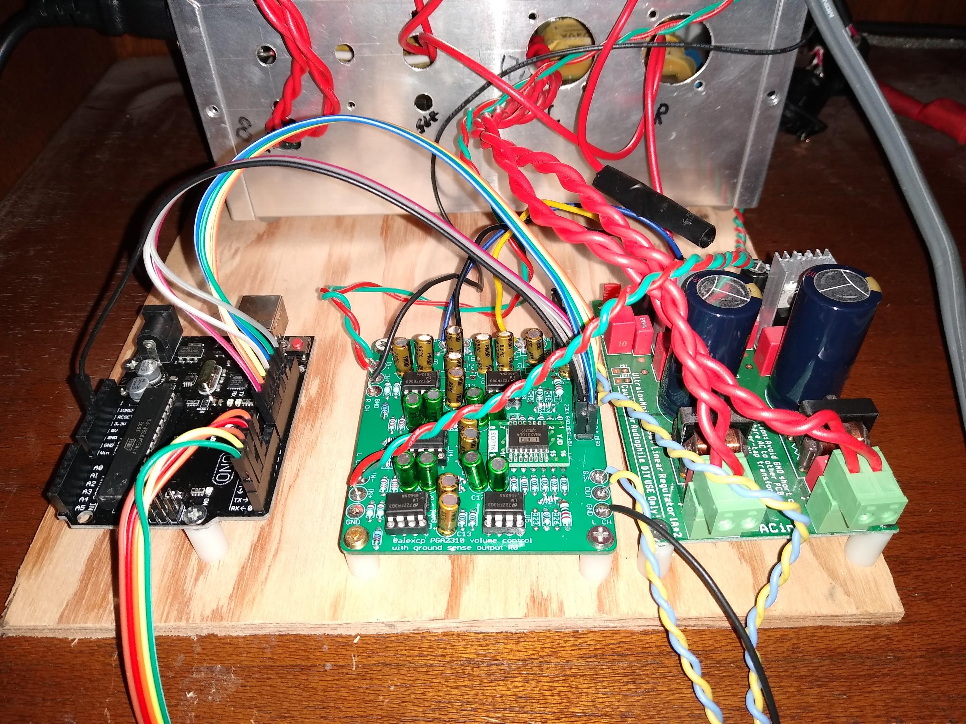

I have two of the PGA2310 boards and have built one. The sound is great and I see that much of the bass that appeared to be missing previously was probably a dac/amp mismatch. But over the top of that wonderful new sound is some serious static.
Twisted pair opus to PGA2310 board via balanced cable. PGA2310 to Truepath amp via ground sensing single ended connection.
If I unhook the ground sensing wire from the Truepath and just connect the grounds directly the static goes from horrible to OK but something to work on.
I hauled out my cheap USB oscilloscope and amp on or off makes no difference. The signal looks good into the 2310 board. On the attached screenshot, blue is the input and red is the ground sense output. Both channels had similar behavior.
The actual 2310 is one that I got from a forum member that he was not using. It is the surface mount variety and I used an adapter.
I have tried the arduino controller with both the built in 5v and a usb power supply and it makes no difference in the noise.
Any ideas?

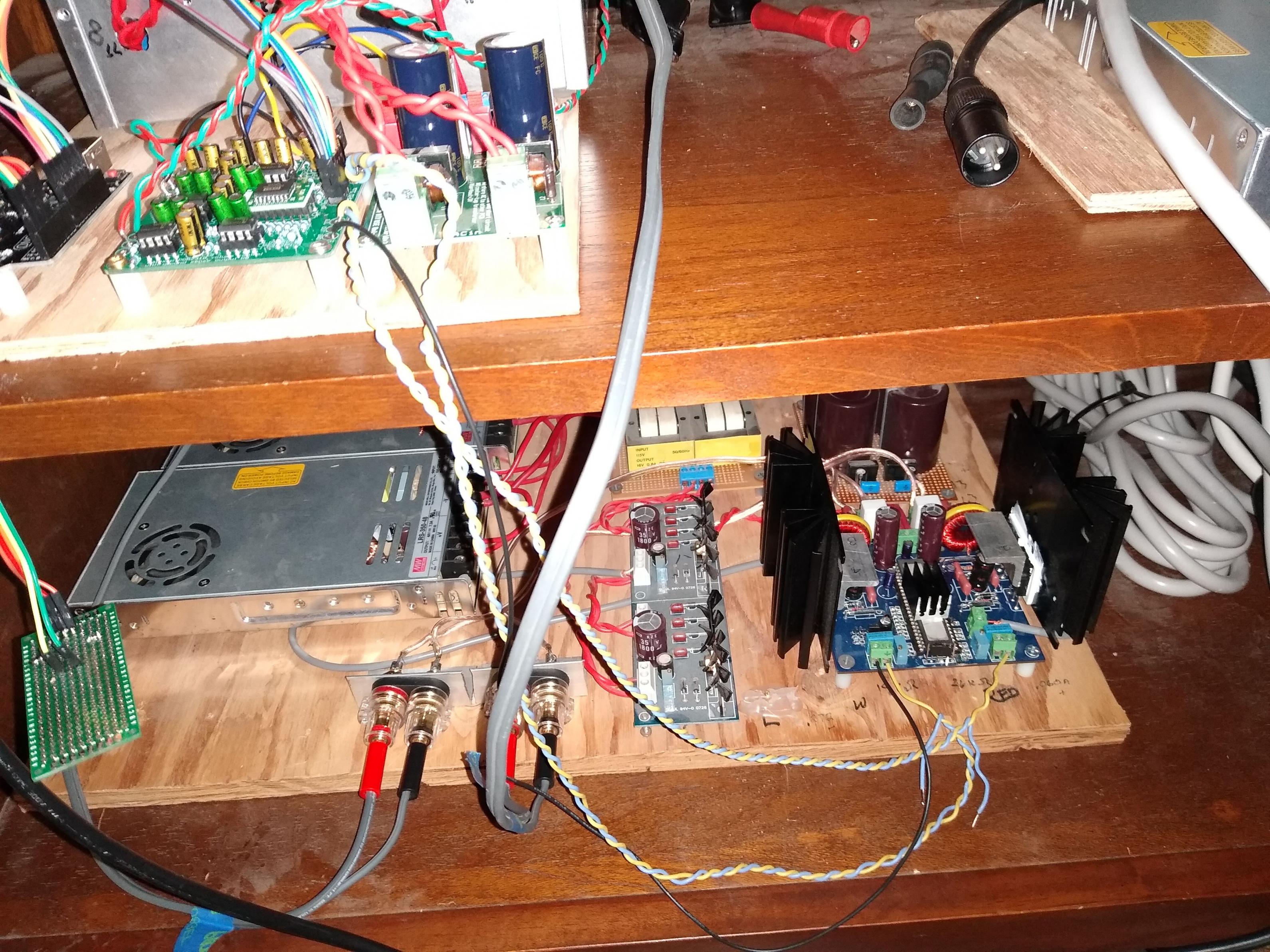

I will keep plugging away at things and try your suggestions. I have included some photos, I just have things screwed to plywood now. Truepath is powered by two LRS350 Mean Well SMPSs. Opus and volume board use linear supplies. I looked at the power going into the volume board and it was very clean. Also, I forgot to tell you the noise level does not change as I adjust the volume. Opus direct to Truepath worked fine for years and was very quiet (I used 2 Truepaths bridged to use balanced Opus output).
I was kind of hoping you wouldn't ask for photos of my setup 🙂 it is kind of a cluster right now. I will work on this in between about a thousand other things that are more important, so I might be a little slow responding, but I appreciate the help.

Thank you for the photos - the setup looks very neat to me 😉
Looking at those twisted pairs connecting the volume control to the power amp, I think they may present enough capacitance to the output opamp of the volume control to make it oscillate. The cable capacitance between the output and ground cancelling input creates frequency dependent positive feedback for the opamp, which may lead to oscillation. One remedy would be to replace the twisted pair and a separate ground wire with two lengths of shielded cable, one for signal, one for ground sensing. These two signals are not a balanced pair, and separate shielding will dramatically reduce capacitance between them.
Also, may I ask for one more clarification: when you were taking the traces with your scope, where did you connect the ground clip of the scope - to the power amp's ground or to the volume control's GND pad? If you connect the scope between OUT and GND pads on the volume control, you will see the sum of your audio signal and the ground cancellation signal. The correct way is to connect the scope in parallel with the power amp's input.

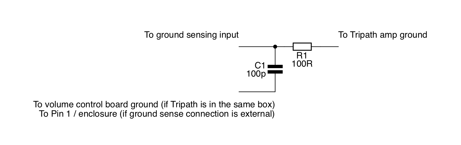

I did some additional simulation and testing on an actual ground sensing output stage with both NE5532 and LM4562. It generally confirmed my guesses from the two posts above, but also indicated that the problems I thought about are probably not likely to occur in a reasonable setup such as yours.
The test setup consisted of a volume controller with the output of one channel configured for ground sensing. I connected three unreasonably long (~10ft/3m) unshielded wires to the ground, output, and ground sense input pads of the channel in question.
I realized it makes sense to mount R26/R48, the 22ohm resistor connecting the ground sense input with the ground. This input is meant to be low impedance, so this resistor should be there in both balanced output and ground sense configurations. Testing was done with R26/R48 in place.
First, I tested an NE5532 (typical GBP=10MHz). I did observe more noise with long unshielded wire at the input, but there was no obvious RFI problem or instability. NE5532 could be made to oscillate in 100s of kHz range if the ground sense input was connected to the output with a capacitor in 1..10nF range directly at the board's pads. Caps smaller than ~1nF did not result in oscillation, although with values in 100s of pF, the phase margin was probably reduced.
Second, I plugged in an LM4562 (typical GPB=55MHz). I observed RFI in MHz range, which I suppressed with an RC filter as described in the post #86. With 10ft wires, there was an intermittent oscillation (with and without RC filter), also in MHz range, dependent on the mutual position of the wires and on whether the far end of the ground sense wire was connected to the far end of ground wire. Replacing the unshielded ground sense wire with shielded eliminated instability.
Third, I cut my long wires to a length similar to what I see in your photos, about 20in/50cm, and saw no sign of instability or RFI, even without RC filter and unshielded wires.
Note that I did not observe anything similar to the ~40kHz signal that was clearly visible on your scope, nor could I make the board oscillate around that frequency with either opamp. I would guess that that signal must be specific to your setup. (What is the switching frequency of your Mean Well SMPS?)
When you have a chance, please let us know what you found in your setup.

Alex, Mounted 22 ohm resistors in R26/R48 positions. That did the trick, sounds great, low/no more noise.
Thanks for the help. It really shows that directly wiring the Opus to the Truepath was not optimum. Still a lot for me to learn.

Fantastic! I am happy this is resolved. I will update the documentation to reflect that the 22ohm should always be mounted. Cheers!
