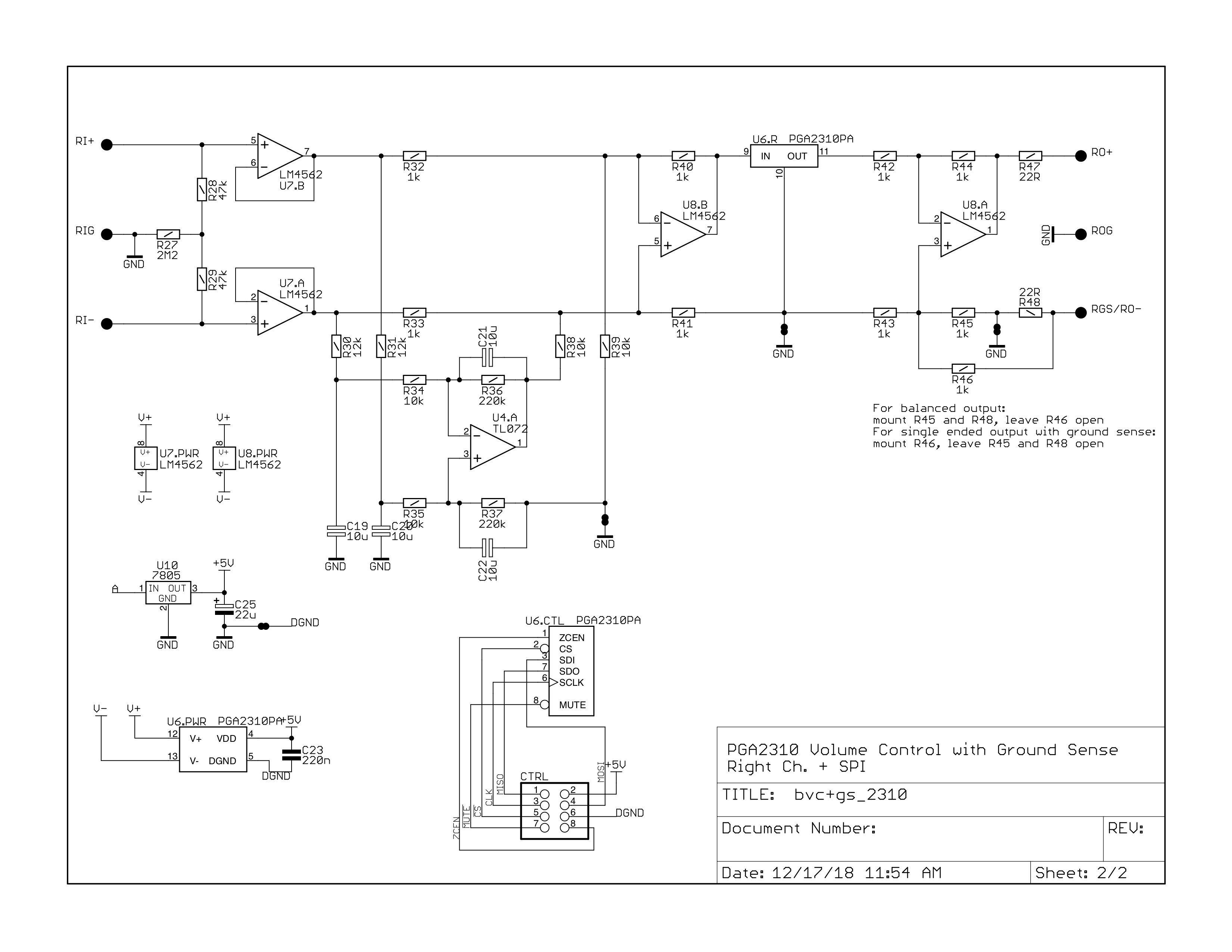

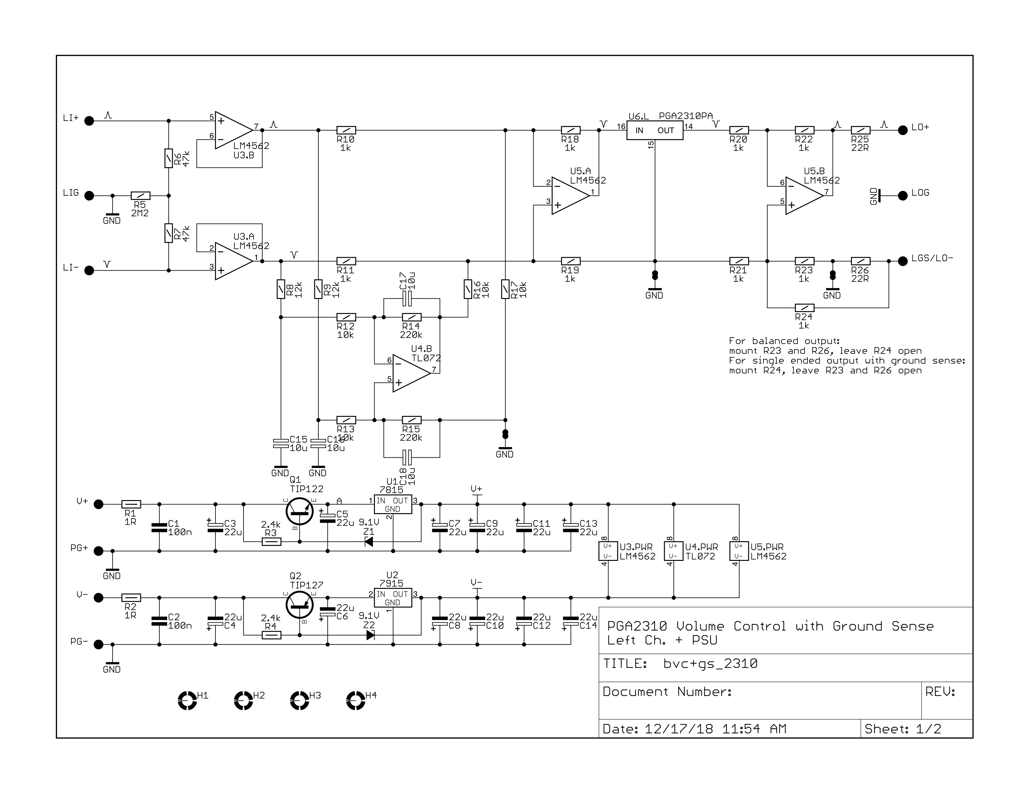

PGA2310 board schematic and BOM
I was asked to publish the schematic and the BOM for the PGA2310 balanced volume control board from post #3. The schematic is attached. The BOM is available as a shared project at Mouser. Note that many parts can be substituted, e.g. the opamps included in the BOM are LM4562, but other dual opamps can be used, e.g. NE5532 or even TL072 (that one with a lowered performance); other brands of electrolytic caps can be used as long as they have the same diameter and lead spacing; voltage regulators and transistors can be replaced with those you may have, etc.

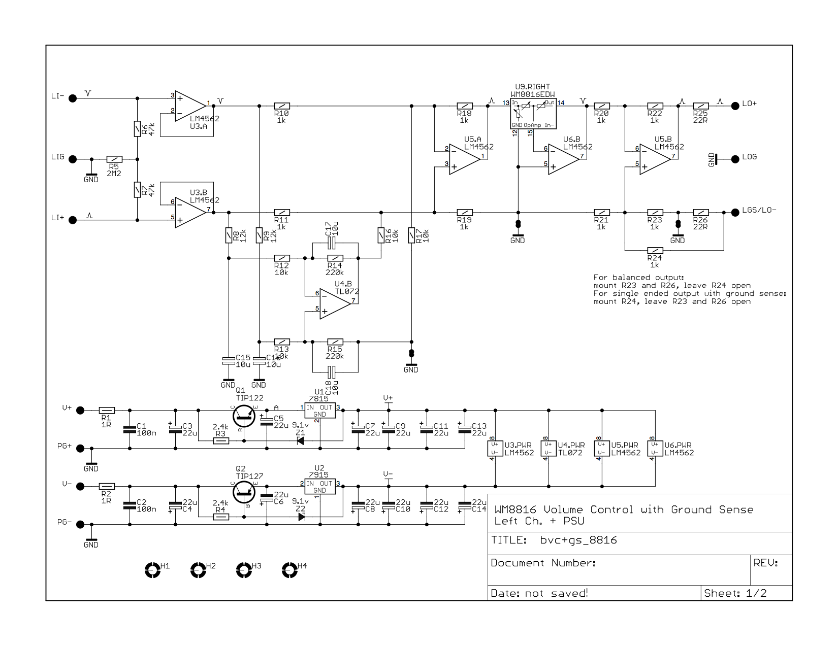

Why so many opamps
The schematics posted above raise questions on why so many opamps for a simple volume control, and why just not limit yourself to one, or better no opamps at all?
The question is valid, and of course, alternatives exist - see, for example, post #27 above.
In the attached schematic, however, each opamp has a role:
  • U3 together with R5,R6,R7 provides high (2.2Meg) common mode input impedance and reasonably high (~100k) differential mode impedance. Besides lighter load for the signal source, this helps to mitigate the imbalance in the source's output impedances on the "cold" and "hot" wires.
  • U4 compensates for the DC component of the input signal, as well as for the DC offset that is created by U3's input currents flowing though R5.
  • U5A is the difference amplifier, which calculates the input signal as the difference between the "cold" and the "hot" inputs.
  • U6 is the volume control proper; its gain is controlled by the WM8816.
  • U5B is the ground sense output stage that allows the following stage (say the power amp) to be referenced to its local ground (that is, to have a single ended input) without creating e.g. ground loops.

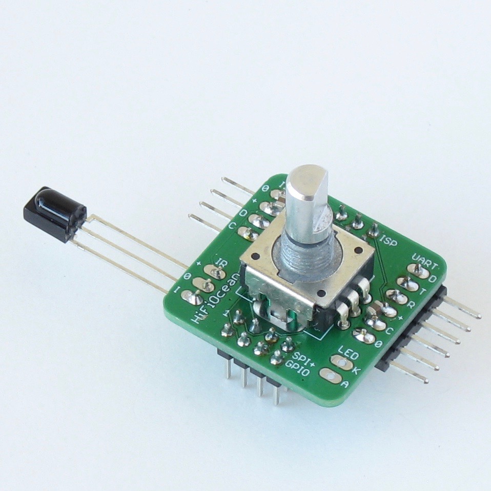

How to control a digital volume control
Resurrecting my own thread.
Having built a bunch of various digitally controlled volume controls (with PGA2310, WM8816, MUSES72320 and DS1882 above, plus an unpublished relay switched attenuator I made a while ago for my implementation of Mauro Penasa's MyRef C), I am struggling with finding a good way to provide a good "universal" front panel control.
In terms of firmware, it is relatively simple. I already have a rotary encoder controlled hardware/firmware prototype (post #25 above) that:
  • Controls any of the above mentioned chips (separate firmware for each chip)
  • Can be controlled with an Apple remote (aluminum or the original white, not the latest black touchpad type) and supports remote pairing
  • Keeps volume setting when the power is down

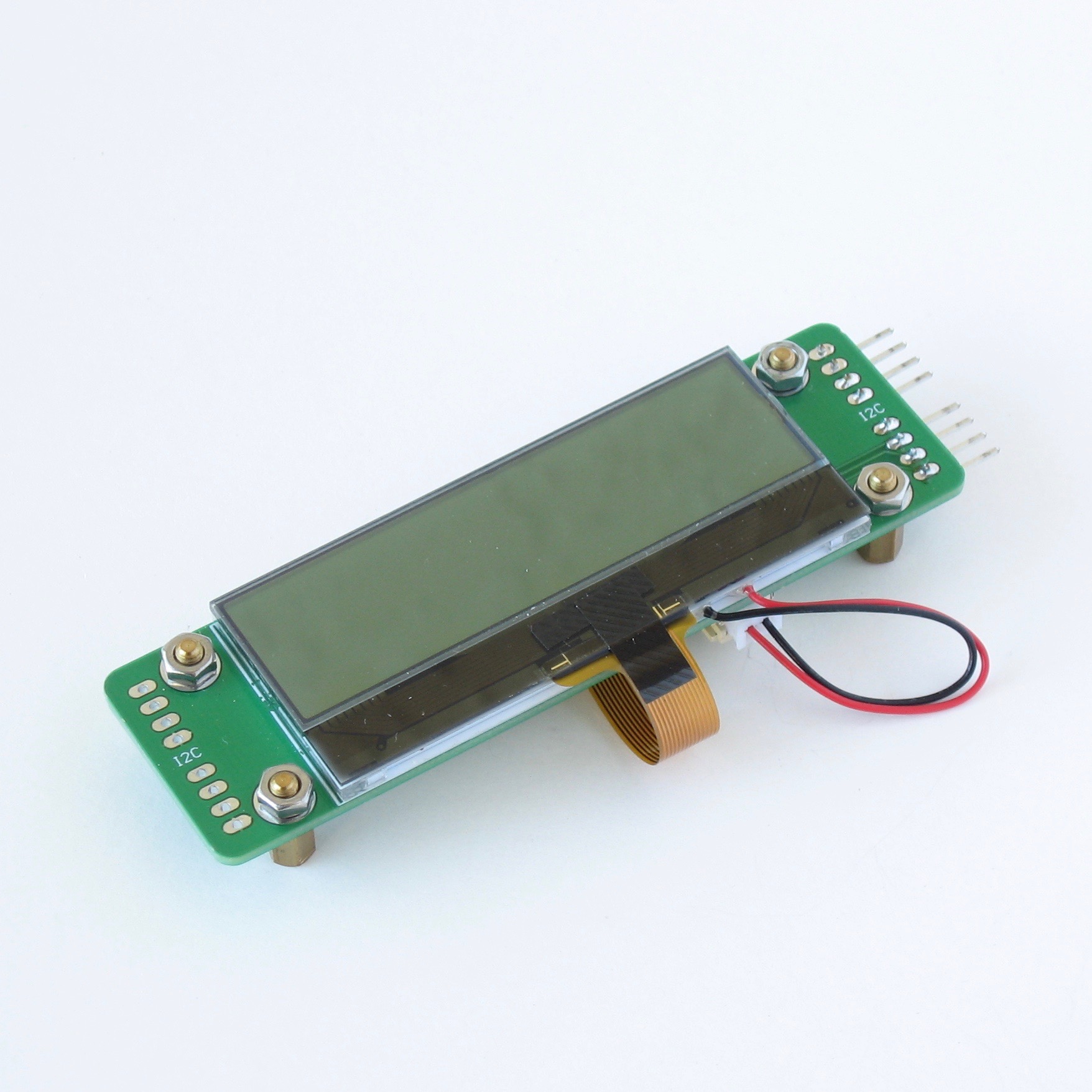

  • Supports an optional I2C connected 16x2 display (any with Adafruit's backpack or the one on the photos below) to show volume setting
  • Can be powered by any of the balanced volume controls discussed above
  • Fits, together with the display, into a 40mm/1U high enclosure
  • With a little more coding, a second board can easily control input selector relays and use the same display
What I am struggling with are the form factor and mounting options.
I want to get away both from prescribing the mutual positions and sizes of front panel controls and from designing and fabricating a separate control PCB for every project - I don't want my (or your) amp to look like someone else's!
My prototype is designed to hold on to a rotary encoder, which attaches to the front panel with its bushing and a nut. It is a flexible solution, it can be placed anywhere on the front panel, and it only needs one hole. It works if you connect it with a flat cable to one of my balanced volume controls. It even resembles a regular pot if you piggyback on it my DS1882 board (although it requires power supply unlike a regular pot). It is fairly compact at 1.1x1.1 inch, close to the size of a (better) pot.
However, using the encoder's bushing is not the only way. In fact, cheap encoders often have no bushing, and those having it may have no anti-rotation lugs. They are designed to be mounted on a PCB, not to have a PCB mounted on them. Adding mounting holes requires bigger boards (1.35x1.35 inch or 35x35mm seems to be the smallest size that can mount around a 30mm/1.2inch knob), as well as provisions (studs of tapped blind holes) on the front panel. The latter can be provided by e.g Schaeffer/FrontPanelExpress, but at a cost.
Also, using a rotary encoder is not the only way. A simple (linear) pot is another. It dispenses with remote control but provides a more "natural" feeling with stops at the minimum and maximum volume.
I have been thinking and prototyping but have not settled on a better solution.
In your view, what's a good universal digital front panel control that would work well in your project?
