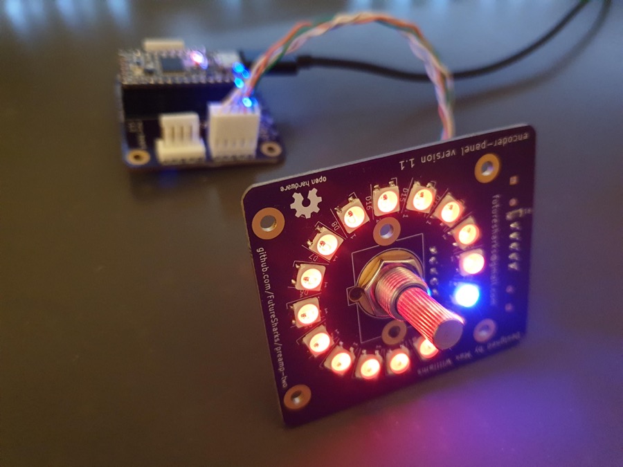

The current look I am working to in my project is the late 80's digital theme. In that case the panel buttons would be tactile switches only if there will be any, however like the real equipment everything is done using the remote in practice anyway.
Furthermore - with displays - a point of contention for these projects is where the information is coming from. Sure your volume control knows the volume setting, but if a user then wants to show information like track time from media server XYZ or FOTM service box ? The user really has to take responsibility for making that bridge. You can only go so far with your model cases before it becomes frustratingly unsupportable and inconsistent in quality.
Exact feelings here. I like the little board attached to the rotary encoder

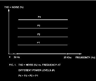

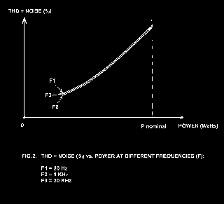

Moving from subjective performance to engineering, the major factor seems to be distortion - although not only the THD+N @ 1kHz. For example, Vladimir Lamm of LAMM Industries, a successful maker of expensive hifi gear, suggests, based on his primary research, ideal distortion measurements (see pics below), which focus on distortion as a function of frequency and volume, as well as on distortion spectrum. The special PCB layout in my balanced volume controls is specifically designed to control HF distortion. (BTW, measuring THD+N @ 20kHz is useful, but if a soundcard is all you have, a two-tone test - say, 19kHz+20kHz - is a good proxy.)
But that's not new, nor peculiar to him. Though not typically published, any audio developer will have done distortion vs frequency and level tests. It's quite easy to do with modern test methods. But those test results are not published because they comprise a rather large amount of data that really can only be charted on a 3D graph, which is hard for the typical consumer to assimilate, hence the published single-figure THD spec, easier to understand, but also meaningless.
The tests and measurements are objective, the audibility of the results are subjective. Particularly so if one considers that the audibility of harmonic distortion products depends on the specific spectrum of the distortion products AND how they may be masked by the musical signal. For example, there is ample evidence that suggests relatively strong amounts of even-order distortion products are necessary before they reach audibility, yet lower amounts of odd-order harmonics are objectionable, though even that is a gross simplification.

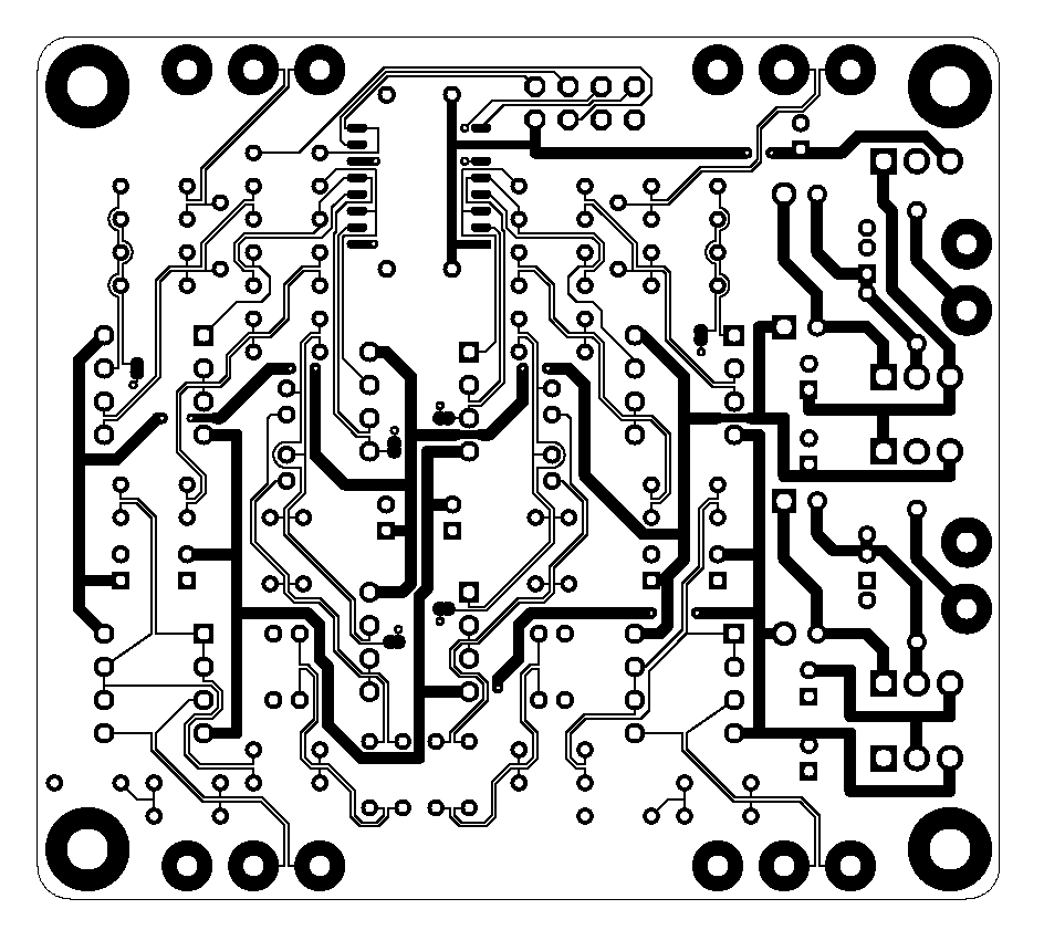

Please elaborate on how a PCB layout affects HF distortion.

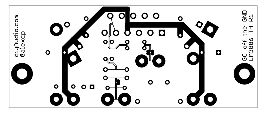

Errors in the feedback loop are construction dependent, and here is where the PCB layout and routing become crucial. Noise and non-linear currents from e.g. power supplies couple into signal and feedback loops, and coupling increases with frequency. To deal with this, I explicitly treat each signal as a pair of wires routed together and place all components in pairs, thus minimizing the area between the signal and its reference. This way, any interference affects both signal and the reference equally and becomes a common mode signal, which LM4562 with CMRR=120dB rejects.
BTW, I previously applied the same construction technique to LM3886 based power amplifier with excellent results.
