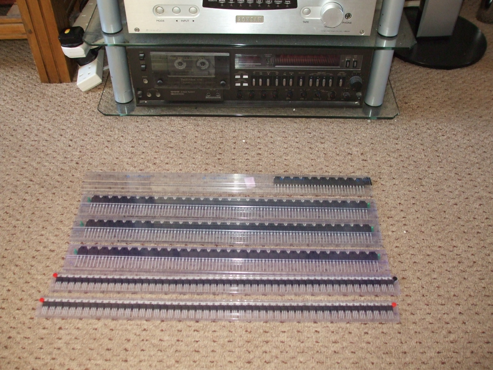

Balanced F5 question
Matching is compulsary for a balanced amp.
Or it is not balanced.
Rather to build a regular F5 with them.
An N channel and a P channel typically deal with the different halves of the sine wave and I believe these can never really be matched correctly. In a balanced amp with unmatched parts, will it be any different? My understanding is that matching is more for current sharing and dc ofset, but they are not sharing current in this config and Im not sure how much offset I would need to deal with.

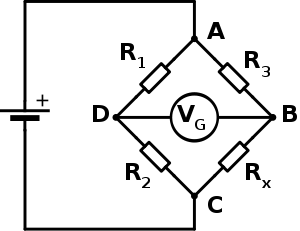

Matching resistors wheatstone Bridge
Well busy now got same dudas to match

As to resistor matching, this is how I do it myself (see attachment). But feel free to do it your way.

PS My source says MPC74 +/-5%. I have no problems getting quad sets to much less than 0.5% for a batch of 40.
  • Power Resistor Matching.pdf

I thought I would bring this up because some people might be frightened off to build this.
I agree the N devices need to be matched to each other and the P devices need to be matched to each other. However I don't think it is absolutely critical to get perfect matching between N and P. If that was the case Nelson would not use IRFP devices which are not perfect complementary devices to start with.
Even the Toshibas which are better are still not perfect complementary devices.
So could either Papa/Patrick/Juma/Zenstar, comment about how critical all of this is.
This project should be about encouraging people to participate in it, rather than scaring people away.
It would be nice to put things into perspective for people, rather than just saying you need perfect matching.

current matching between all input jfets is a must ;
EUVL's combined source resistor/different Idss - as tricky bonus , for fun and builder's pride
current matching of same polarity of outputs is a must
current matching between polarity of outputs is splitting a hair , but can be fun if you like it
using THD meter and Papa's trick of additional source resistor in appropriate place in output is a cherry on top of cream pie ( and poke in the eye of our usual overengineering .... and above hair splitting :rofl: )
