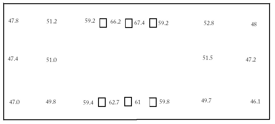

Finished testing of the MF35-151 heatsinks.
Air temperature was 22.1 degrees.
The small rectangles represent the position of mosfets across the heatsink.
Applied Voltages and Current were +/- 26.1V and 2.6A (135W).
Obviously between the mosfets the temperature is quite hot but further away the temperature drops off a fair bit. If there was a way to spread the heat across the heatsink better than we might be in busines.
Also, once the heatsinks are conected to the top and bottom plates and front and back plates the temperature will come down further.
Yes 67.4 degrees is far too hot in my opinion also.
However toward the edge of the heatsink the temperature drops below 50. If we can spread the heat uniformly across the heatsink then we shoud be able to get the temperature to below 60 near the mosfets.

I haven't tested the MF35-151, but empirically it seems like it should be limited to 100W.
You might get a little lower temperatures if you were able to line the devices up 1/3 of the way up from the bottom six in a row, but I still don't you'll get comfortable temperatures at 135W without a fan.
the PCB will determine the device spacing.
Certainly the top devices are far too high up for optimum cooling and that is why we are seeing the top row temps way above the bottom row temps.
What happened to the approx. +30C over ambient "rule of thumb"? The "put your hand on it for at least 5 sec."? Personally I can hold my hand on 65C for minutes. It looks to me like the outer extremidies are about 55C. I agree speading the load is more effectively using the sink. Hence, I prefer the long board (DiyAudio boards) configuration myself.

With mica isolators you're at around 1.6 C/W junction to sink. At 22.5W per device on a 65C sink (at the device), that's right around 100C at the junctions. That should be OK, but most people will find your sinks way too hot to touch. Silpads will be a little higher thermal resistance and therefore higher junction temperatures.

I'm not sure about that. Once its connected together you will also see an increase in ambient temperature, that in my opinion, will negate whatever you gain by this adding more aluminum mass, even with agressive number of cooling holes.

Don't get too excited. Look at the measurement in detail.
The average temperature over the heatsink is 57°C. Minus 22.1, then divided by 135W gives 0.26°C/W.
And that is exactly according to Catalog (0.21 x 1.3 correction factor). So don't blame Conrad.
Our task is to spread the heat out evenly so that there is no 20°C over the area of the sink.
How, don't know yet. Give it time.
And you have to look at the entire picture -- what is the final junction temperature.
