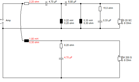

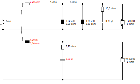

I'll tell you what I know about diffraction and bafflestep, Nigel.
Let's take a typical closed box 8" bass plus 3/4" tweeter speaker like my current crossover project:
599660d1487267698-restoring-monitor-audio-r300-bookshelf-speakers-monitor-audio-r300-md-resurrected-cabinet-jpg

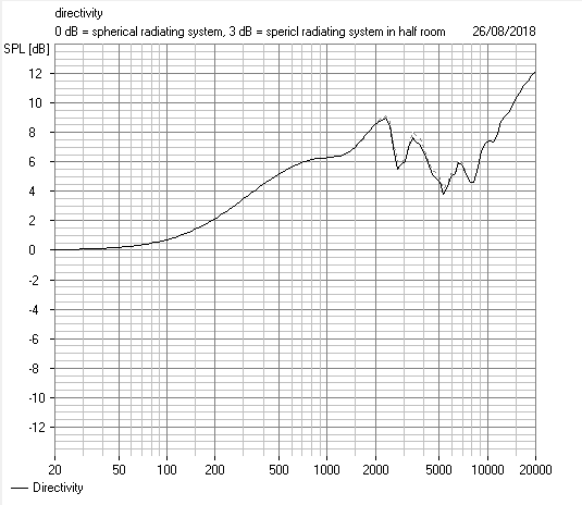

It's the nature of waves like sound that they are affected by nearby surfaces and edges. What happens with this speaker is that below 300Hz, the waves find their way in all directions, even backwards. Above 300Hz, most of the sound finds its way forwards. The directivity plot is all about diffraction effects. You can see the 6dB rise around 300Hz.
This means the higher frequencies actually sound louder in the forward direction than the bass. Actually 4X the power or 6dB loudness. This is a bit like a car having 4X the energy at 60mph as 30mph. Strange but true.
There's a bit of effect from the wall behind. If the speaker is close to a wall, the bass is a bit louder, because there is a reflection back.

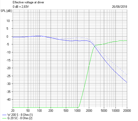

Bottom line is I had these speakers working nicely to my ears, but a listening friend asked where the bass was. I decided to boost the bass a bit to get nearer what people are used to.
It was easy enough to adjust the bass coil up, and the shunt coil down so the bass was louder relative to the midrange. Strictly speaking, tweeter level needed taking down too. Notice that electrically I only apply 3dB of bafflestep. The rest of the theoretical 6dB is built into the bass unit and the room acoustic.

It's a very vague correction really and it confuses the heck out of most people.
The usual method is the big bass coil:
attachment.php
You really need a simulator to do it this way.
The other way, rather unfashionable, is to use a passive bafflestep adjustment, here 1mH and 2.2R for about 2dB.

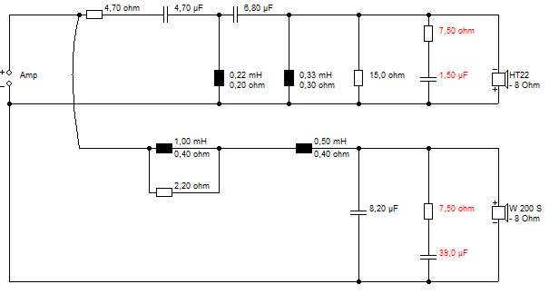

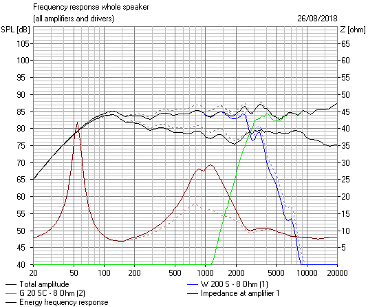

I'd like to try that tweeter myself. I'm using a ferrofluid SEAS 19TAF/G metal 19mm currently. But this unfussy 3kHz crossover for the well-behaved 8" is excellent. I think it would work with your drivers with a bit of tweeter attenuation. As long as the tweeter is flattish, the 4th order filter dominates and most stuff works.
699668d1535298754-baffle-step-diffraction-bafflestep-circuit-png
Always room to fiddle around for fine tuning. It's why you have to listen to a speaker no matter how good the sim.
