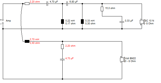

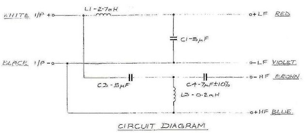

I'm sure Nigel would be very pleased, and I would be interested, if you could knock something up for his Volt BM220.8 and a SEAS 27TBFC/G H1212-06 in that VituixCAD thingie of yours.I don't have to listen common speaker concepts, but it is fun part of the project and might give some experience for the future. Unfamiliar concepts need listening and tuning for studying how simulation should be.
Take you 10 minutes wouldn't it! You can try my circuit if you want a point of departure. It sounds good, IMO. 😉

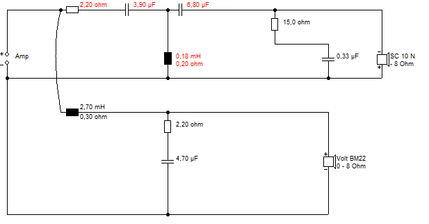

Nigel, I had a brief look at your Volt BM220.8 and particularly the Scan D2905/9700. Doesn't look to me like the 88dB Scan goes loud enough for the 90dB Volt bass. The Scan has a particularly horrible 32 ohm Fs impedance too. Because there is so little wiggle room on level, you can't do the usual resistive tricks to deal with the Fs problem either.
That SEAS is indicated here. Or something else near 91dB. I think the circuit above I showed you will work with a 91dB tweeter and your Volt without modification.

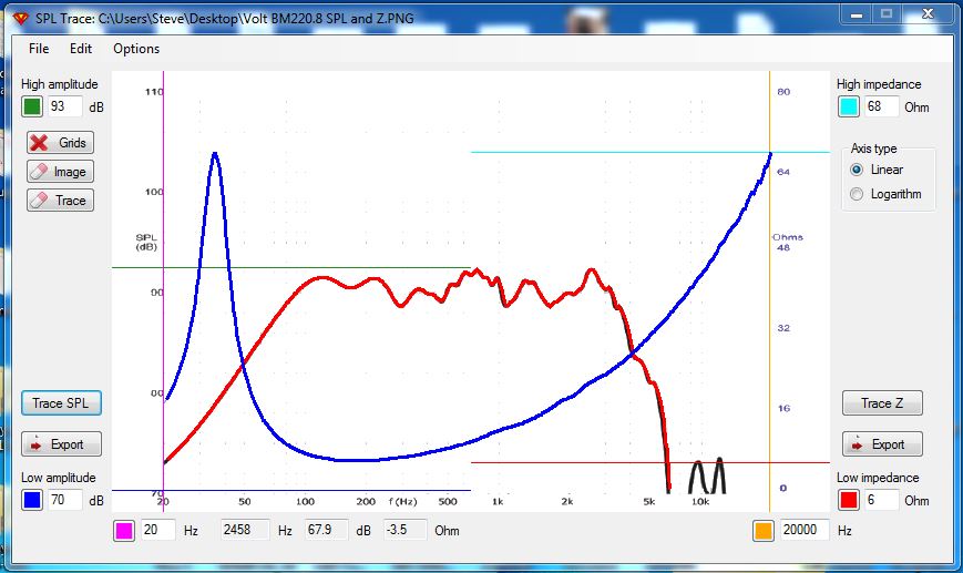

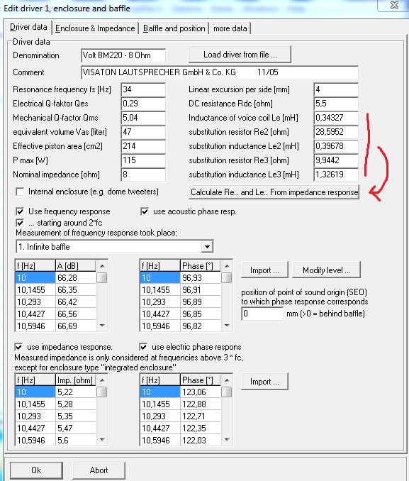

I ran into problems with this Volt BM220.8. It has a rather troublesome peak around 700Hz. Maybe a surround issue. I really don't know what I am doing with SPL Trace in VituixCAD. I really just wanted decent FRD and ZMA files for Boxsim. Not sure what gives with phase and acoustic centre either. This is where I am so far on any old 91dB tweeter. Just using that old reliable Celestion tweeter filter. Haven't tried to import the SEAS files yet.
Am I doing the SPL trace right? Below is just before I export the two files. I know as little about VituixCAD as you do about Boxsim, so lets help each other.
From user manual: "Phase response is calculated automatically as minimum phase. Program estimates slopes of frequency response extensions below and above visible range."
That is: Acoustic center of minimum phase response is 0 -> you need to estimate what is the distance from baffle surface (or other reference point) to acoustic center of driver and set that value to distance (Z) coordinate of driver in crossover simulation.
If XO simulator you are using has FR slope estimation and minimum phase extraction, you can copy responses from SPL Trace in "raw format" with Edit
-> Copy raw SPL/Z. Data has traced frequency+magnitude points only.
Thanks for your input Steve and Kimmosto. Yes I would love an expert to sim my selection as I am a complete novice. I thought buying a kit of parts and then designing my own cabs would be easy. However, after reading various posts I have realised that this is not the case, when it comes to crossovers. I will be procuring a mic and measuring software shortly to enable me to do the job right. In the meantime, a close assimilation will do just fine. attached is a drawing of my front baffle.
Many thanks, Nigel

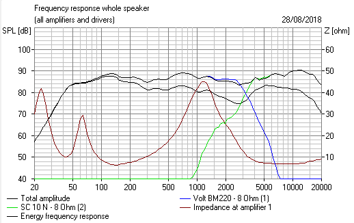

I'm not too sure about this at all, Nigel. And Kimmo wasn't much help. Maybe its a bit too much change to go from paper cone to polycone. I've been playing some more with the software, and there is some severe difficulty with the acoustic centre of the bass when I import the FRD and ZMA from the Volt graph. It seems to work if I move the bass 50mm forward from where I thought it would be.
I have a feeling I have got something right now, and I am suspecting the below bass circuit might be better. It's still quite a poor response with the Volt BM220.8, but I can't think how to fix it without a lot more components.
It's the peak at 700Hz that is difficult. The tweeter circuit ought to be OK with the 91dB SEAS 27TBFC/G anyway. The bass circuit looks familiar enough. Often used, as in the KEF Celeste III, below. I just don't have the modelling to be very sure about all this. It's not wildly different from the 1.8mH/8.2R plus 4.7uF circuit, just takes the midrange down 2dB.
Your 30cm baffle should be OK. I used 25cm. Not much in it.

Thanks for your efforts, Steve. I needed a starting point and your advice is welcome. I’ll keep you informed as I go along but it will take me some time.
I think you have enough to have a go at this.
I would. The cabinet should be easy enough, and I think you can go to Wilmslow Audio for boxes and crossovers here if it is all too difficult.

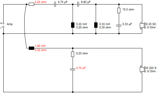

Whatever. The topic here has segued into getting Nigel's 8" Volt speakers working. I don't know an awful lot about polycones. Lots of cone damping, an' all that.
My current 8" paper cone effort is really working splendidly well. I definitely didn't do this in VituixCAD. Look at that lovely impedance! I just don't know quite how to do this with the Volt unit. And none of you monkeys are helping either. True. 😱
For the interested student, that Visaton W200S-8 might as well be any old 8" paper bass. The Morel MDT29 aka CAT298 soft dome is actually amazing me with its musicality on a good filter. I underestimated it. Superb. 🙂
