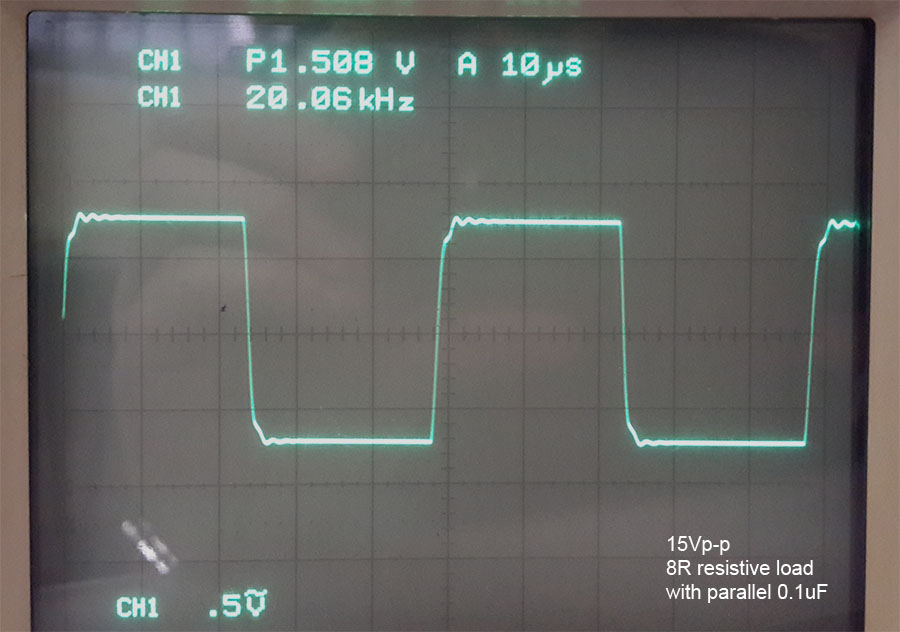

Tried R18 and R38 at 1k, output the same
tried anti-parallel 1N4148 diodes Q12,Q3collector, output the same,
or should it be Q2,Q1 collectors ?

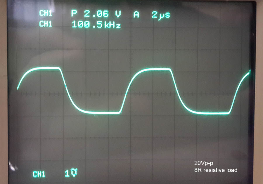

At 20khz 100Vp-p output SR=50V/us if I measured correctly.
Tried 100nF cap parallel to 8R resistive load at 20kHz, is this test important ?
Is ringing allowed in this test or should it result in clean square wave on output
Lol put 100kHz square wave input, while talking at same time to friend, turned amplitude close to or maybe into clipping, and oscilloscope waveform goes flat line.
Blew two output transistor 1 NPN and 1 PNP, desoldered them and working again.
posted pictures below of waveforms.
Regards
