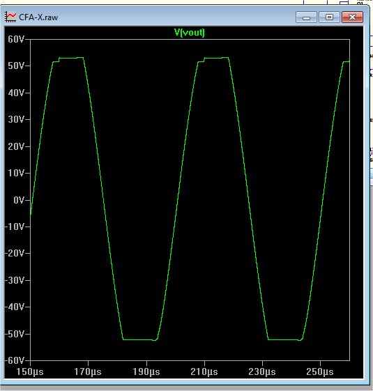

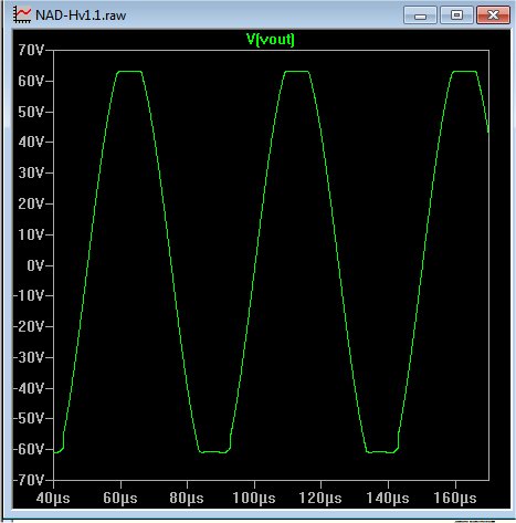

bad clipping
CFA clipping ...
Below 1 is VSSA clipping behavior . Member Bimo also reported the input
pair getting quite warm during high power /clipping.
I think his build is a hybrid VSSA/hawksford. No smoking amp , but CFA's
tend to be "sticky" .... but don't exhibit saturation like a VFA.
NAF built the NADservo (NX) .. hasn't reported any hot devices.
(below 2 ) it also sticks ... but not as much.
3 different VAS pairs (models ) show some sticking, but generally it
is of a much smaller magnitude and very symmetrical. The real amps
also show minimal "bad behavior" and never let out the "magic smoke"
PS - the symmetrical VFA leach is much worse and both saturates AND sticks
with the same VAS as the VSSA .... the topology must determine this behavior.
OS

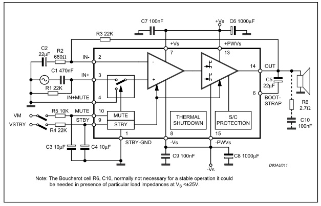

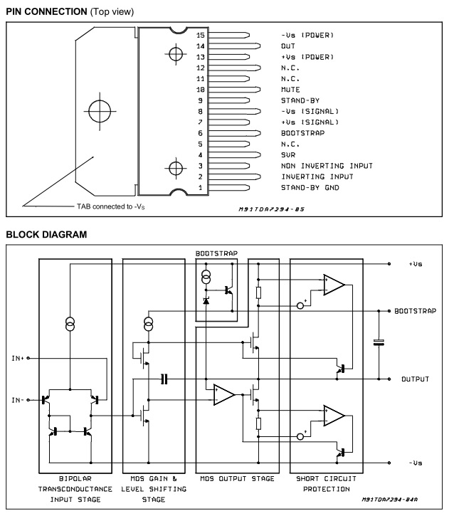

For example TDA7294 has separated pins for output and signal stages....has anybody tried different/variable supplies for output and signal stages ?.
As per the clipping indicator discussion going on elsewhere, this might be an interesting way of gauging the sonic impact of variable degrees of clipping for a given signal level.
Ditto gauging the sonic impact of differing combos of power transformer capability and reservoir caps.
How bad is a 'high headroom' (ie, small transformer) output stage supply vs a more capable output stage supply within the condition that the input/driver stages run from clean/stable supplies ?.

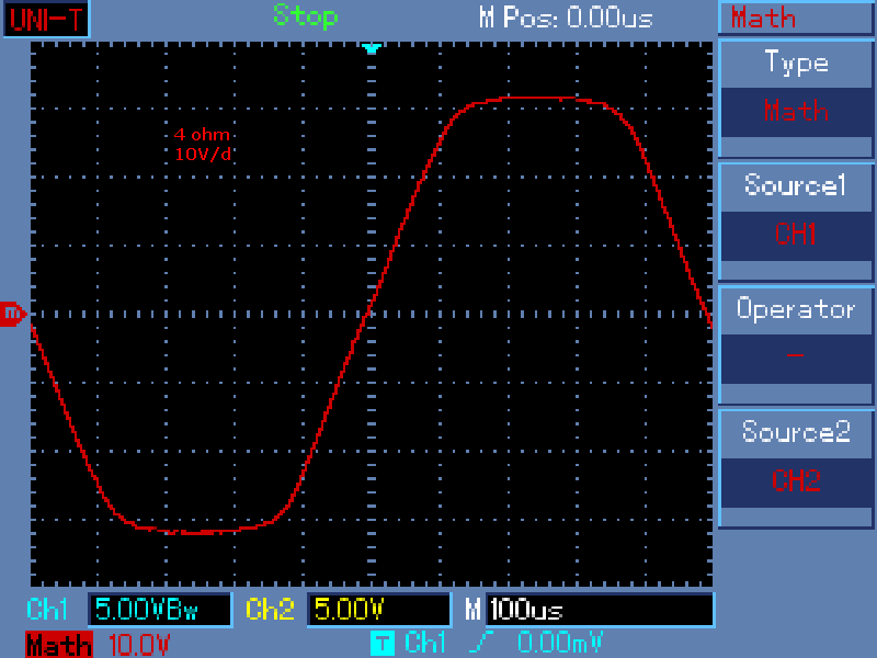

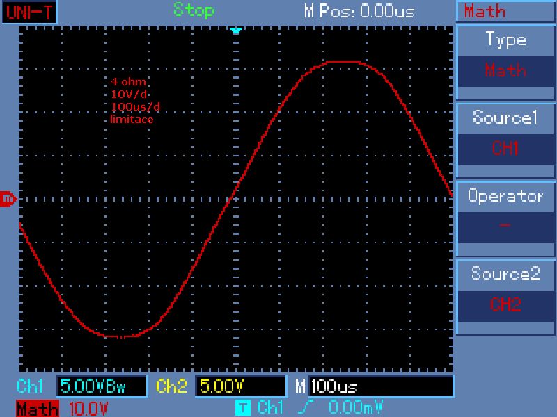

Clips like this, then. Anyway, even with same rails there should be no problem with clipping. I like 'strong' VAS, I use VAS idle current up to 30mA with on-demand ability.
Agree with Pavel on this, still wondering if there is better results to get from a slightly higher regulated voltage for VAS.?
