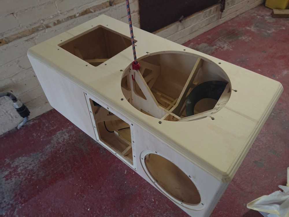

Using NX NASTRAN for the FEA. Optimised for modal response and minimising external panel deflection in the <400Hz range with global positive / negative volumetric pressures . Above that range I'm hoping there should be enough damping to take care of any spurious bits of energy. And the bracing will get exponentially ridiculous to chase the increasingly inaccurate higher modes.
Doing the "knuckle rap" test is very impressive to me, high pitch with fast decay. A long way from many commercial PA / Hifi cabinets!

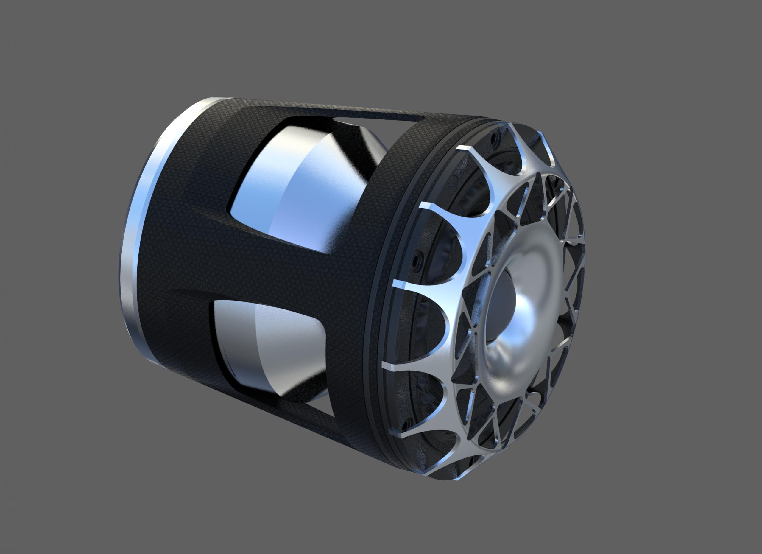

That's a serious pack! (Is that a Keyshot render?). How do the cells fit in, and why the shape? Does it interface with other parts?

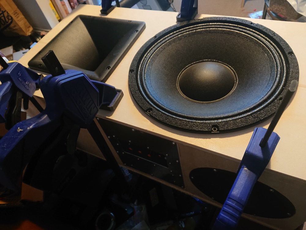

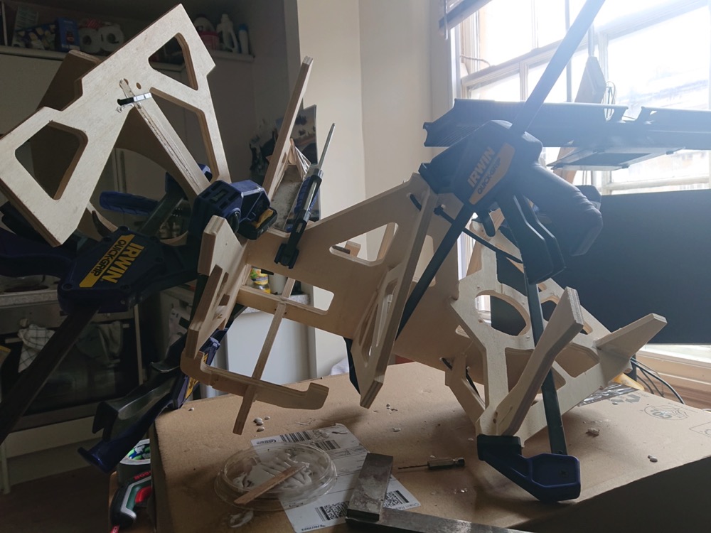

Been pulled away from projects over the last couple of months, so progress has been slower than I'd like. Also the electronics has been a PITA to get correct. Many revisions to get the noise out of it, reducing idle losses and the switching between power supplies working well. The final schematic is shown below with the images
Need to fix some of the staining now, before I set the PU over the top. 18mm chamfers have worked really well visually I think, and also help to maximise the volume for the given circumference.
Then *finally* I'll be able to use it!

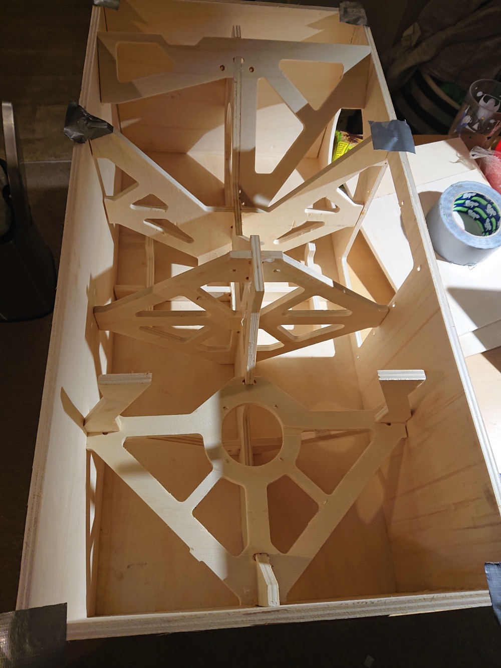

That brace is full jet fighter! Looking very good; excellent work for sure. Nastran definitely takes modeling to the highest degree. So I'm guessing you used negative pressure to look at the bracing under buckle to chase down waste? I wish I could do some advanced sims but I'm using LISA FEA which is bare bones and dealing with a complex mesh is almost unbearable. So I'll mostly fire it up to do AB comparisons for displacement and von Mises with dumbed down geometries.
On the battery stuff, that's correct, I'm in the Solidworks/HSM and Keyshot world. The current design is really just an evolution from many many designs, probably in the hundreds at this point. If you cluster the parallel cells and group them you can more easily manage routing. The main problem with packs is always the need to have separate wiring for the bms, so that's usually the biggest headache with layout. In this case the cells just drop in like they would with any regular "Energizer" type gadget. There is a similar top plate that provides connectivity, but in this case everything is very beefy, 1/8" copper plate with special wave-disc springs that put 5-10lbs of pressure on each cell ( through the floating plates) which have a 45deg. annular contact surface. It happens to be a round pack because I'm hashing out ways to do an integration with the Purifi driver; so, Purifi coax with the crossover, TCP3255, and battery. That's not a sure thing, but I just keep moving backing and forth on different utilities, integrating them a little more each time. The last pack I started on IRL was last year, a 1U rack mount 8s8p. It took almost a year of very intermittent tests to get the drilling operation perfected, but then there were still the dreaded routing issues to deal with, so I'm still working out those challenges and also doing things that will make construction easier.

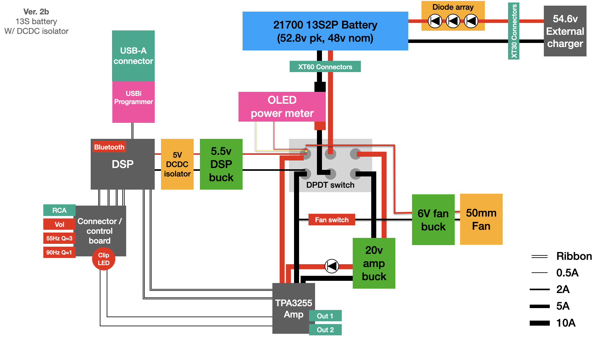

Pretty advanced stuff! box progress looks great, is the 20V buck for some kind of low power mode for the TPA3255? (but on the diagram the DSP is shown unpowered in this configuration?)

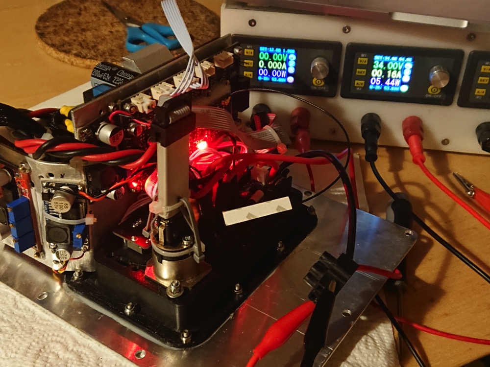

I've been doing consultancy for months taking up my time. I hope to have a test board for my ir4301 bridge amps on aluboard soon which should approach 500W 4ohm capability to have a higher power/more efficent option than the TPA3255 (IR4301 has significantly lower Rds Fets).

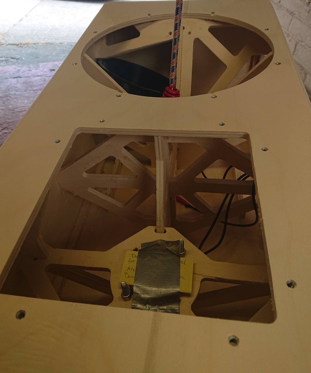

Yeah, exactly. You can see some extra little braces added in to help with buckling. The process was incredibly iterative, I think I ran maybe 60 cases. Each time adding or removing mass to increase stiffness or take it out where it wasn't contributing - until I realised I was spending far too long on it lol (I should really learn their structural optimisation tool). The NX/NASTRAN workflow is very fast when setup, and their meshers and solvers are generally very reliable (so long as your models are good..)

Cheers! Yeah, the 20V buck is for the low power (5W system idle power) mode. The high power is about 15W, so limits the battery life a bit. Currently at high power it looks to last 6-12hrs, and the low power is around 24-48(!) hours.
The DSP is actually connected, as the current reverses up from the amp to the "off" section of the DPDT switch. I have lost the ability to automatically switch the fan when in the high power mode though, still trying to figure out how I can do that in a nooby way..
Yeah, consulting is a total time suck (even if the pay is great). Ended that last year and went into a comfy full time role to have a bit more free time.
Looking forwards to this little board. Would mean the battery could run at full voltage and I wouldn't have to worry about frying the poor TPA3255! Pushing the datasheet a bit with the Vsupply.

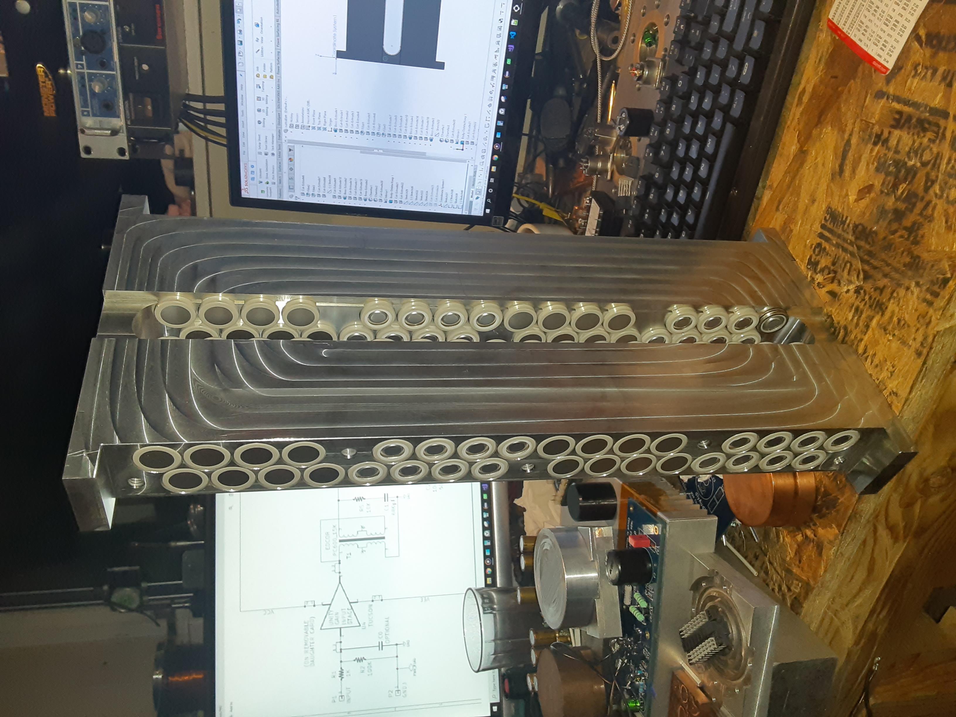

Just finished the schematics for the IR4301 demo board and have 10 of the aluminum boards already. Ultimate idea is 8 channels of DSP (sigma studio) and 16 of these aluboards that mount using a cutout and castellated pads. Will do a single channel amp board (possibly just this demo board if it works well) as well. All schematics layouts etc. will be given away even if I'm selling finished boards as my objective is the proliferation of battery sound.

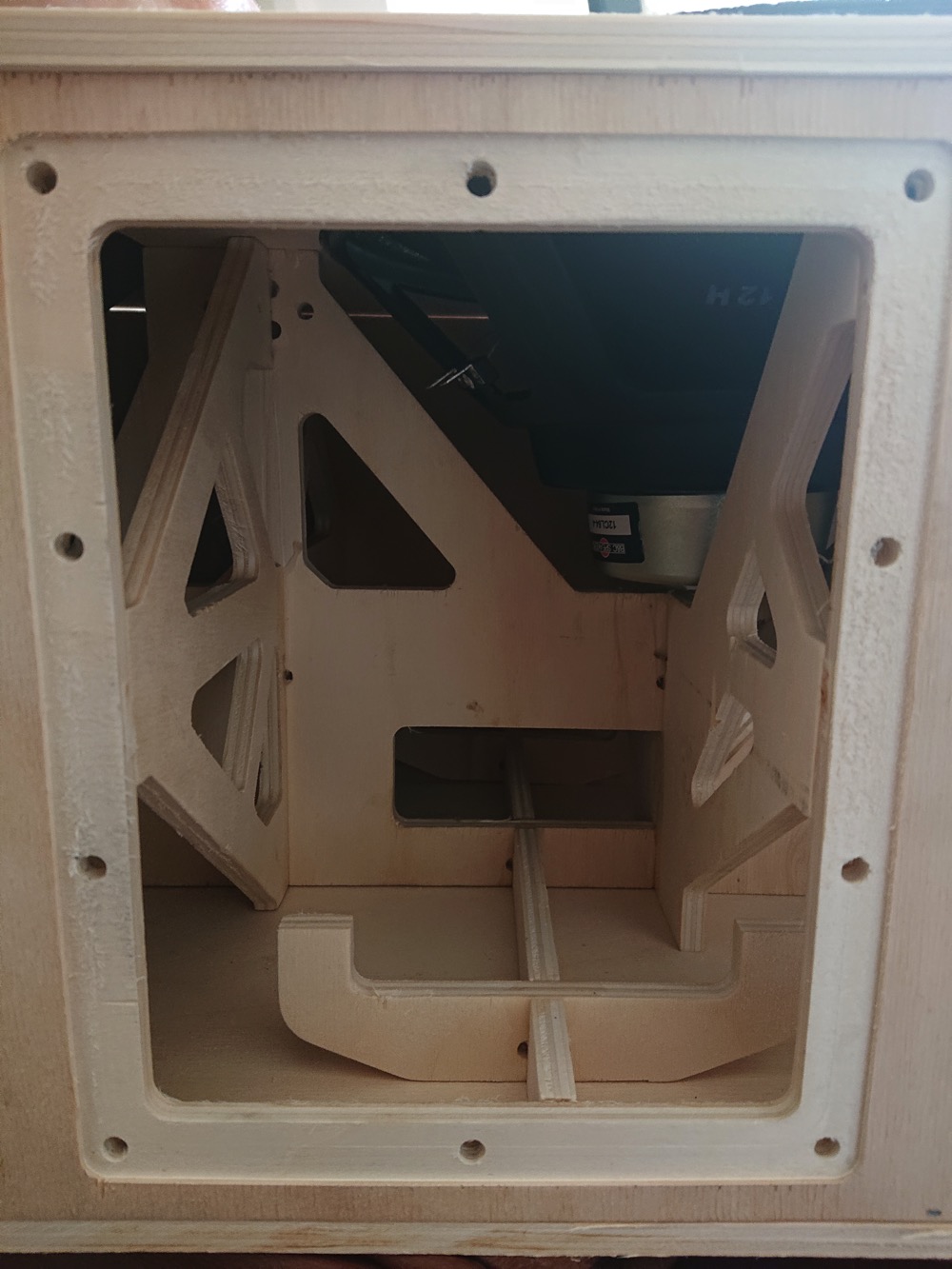

Been a while since I've posted. Managed to finish the 'box and it's been out a fair bit in the Welsh countryside, house parties, etc. Aesthetically it’s definitely on the crude side though, and won’t win any beauty awards.
Sonically, happy with how it (eventually) turned out. With enough iterations of the DSP, the sound is well balanced across the board. Quite directional still, but really does sound “full” outdoors and bigger than it is. Of course, not on the scale of a larger PA, but it does drop down flat to 50Hz now, and can really thump out at enough volume for my / our needs. The integration between the 12” and the 1” seems really nice, with a wide response sweet spot around 10-50deg off axis.
The ‘box targets drum and bass at medium SPL, but also drops low enough (with additional EQ wound in) for dub or more bassline dependant genres. It also seems happy with techno & house, with the 12” tight enough for the faster impulses. Less intensive genres such as jazz or vocal also work well. There are some issues with sibilance and harshness with female vocals in the upper ranges, I think that’s mainly down to my handling of the CD horn in indoor vs. outdoor spaces. To be worked on one day. The 105mm (50hz tuned) port is based on an elliptical profile has been noiseless, even with a theoretical peak velocity of 33 m/s.
The power systems work really well. It has two internal rail options - direct from battery at 54V peak (48V nominal) or through a buck to supply the amplifier at 20V. I have rinsed it in both and the tradeoff between power or battery is invaluable. In most scenarios the 20V is more than enough, giving plenty of ‘tactility’ and SPL within a 5m radius. Above that, or if you would rather dance than talk, then the 54v (48V nominal) gives another 9dB or so, but with twice the idle power draw plus the extra power to the woofer.
The battery life is around 10-14 hours for full tilt @ 48V rail, or around 40-60 hours for the 20V rail (estimated, never made it that far yet). The battery was swapped to a 13S2P 21700 pack, which at 420Ah is really overkill. Although, voltage drop is a non-issue - with the maximum average draw being around 60w (no clip) or 120w (into clip, but audibly OK) at 54V.
The psychoacoustics module is one that I haven’t figured out a happy place yet. I have it set up to increase harmonics 35-55Hz, giving more “weight” in that band. Sometimes this works great (especially given that dropping below 50Hz in half space is tough for this), but it can sneak into the audible distortion area with some tracks. Disco seems to be a problem particularly - no idea why yet.
The electronics has continually and painfully evolved over time (my electronics generally follows a “figure it out as you go” attitude). Below is the latest ‘schematic’, the only real outstanding issue is that the OLED power monitor keeps on blowing its XL7005 driver (?). The MOSTFET soft-start circuits I built are going well though, and stops the switches welding themselves together after <50 cycles. The fan keeps inductors and chip temps in line, and only kicks in with the 48V mode (where it’s on all the time).
Probably due some TLC over the winter. Looking to fit a proper recessed wooden baffle and replace the PITA power meter with a better solution. LEDS from the GPIO pins seems sensible. Maybe also take 50mm off the height of it too if I find the time.
