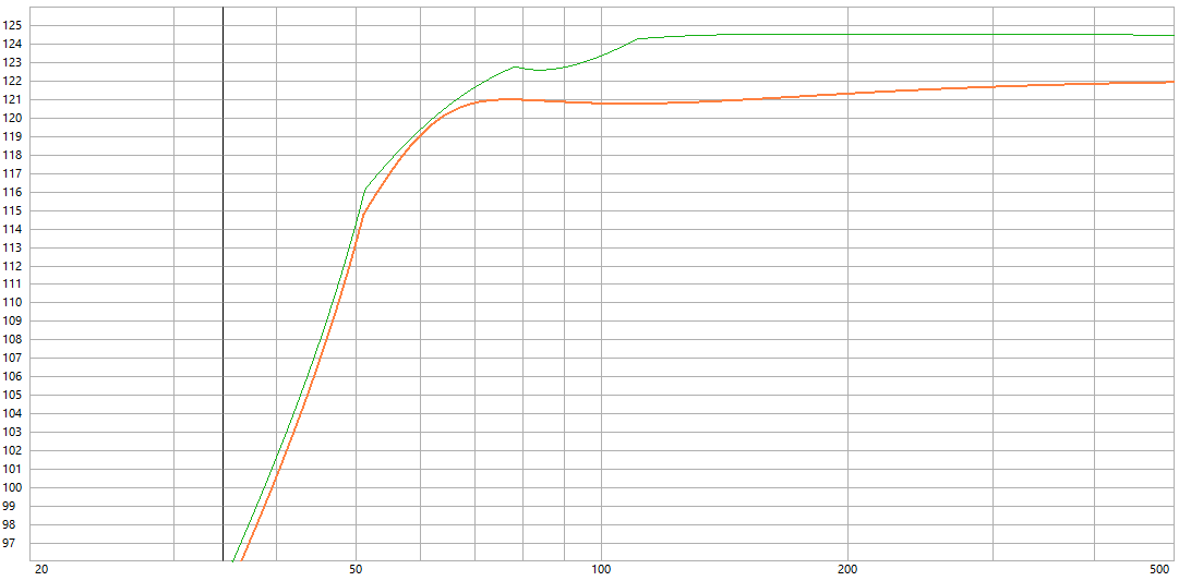

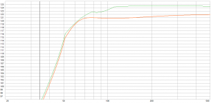

Given that the two systems have more or less the same efficiency around the 60hz LF corner (attachment is 1x12 and 2x10 scaled to the same power) then I would probably rather go with the simpler and ""tighter"" solution, forgoing the 70Hz+ efficiency gain (which will ultimately see less LF boost to hit the equal loudness contours or thereabouts, and will have a slightly smaller impact on battery life).
.. Although, the 12CL64 does easily take the full 600w before even touching Xvar in 45l/60hz.
The question is: Is it worth going for a higher power IRS2092 mono block with a 70v boost converter with a virtual ground? Alongside a little TPA3116D2 @ 20v for the HF section.
Do I need the SPL (realistically), is it worth the extra complexity and decrease in battery life.. !

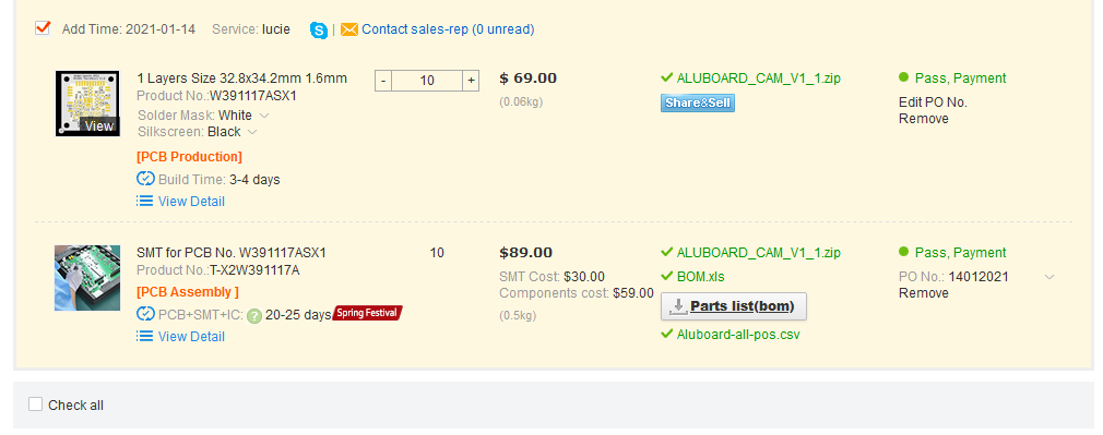

On my amp front I have delays due to Chinese new year on producing my prototype to test if I can get these tiny chip amps to a higher power level by bridging them and running them on an aluminum board. I'm using IR4301 to try and get the cost and size as low as possible per channel. I am targeting 500W into 4ohm (internally bridged amp) but in the further future I would like to make a discrete add on bass amp module.

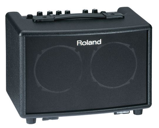

I think it's hard to beat the following, Roland AC33. I am so impressed with this unit. I bought it to do some busking gigs. I flew it to another state to play guitar instrumentals at a church wedding in fact - filled a pretty big space.
One can mix an instrument and a vocal, ie two channel. It also has a 1/8" jack on the back with settable level so one can play along with recorded music. I bought a simple bluetooth receiver mounted on an 1/8" plug so I can play my phone through it.
The battery pack on the back holds 8 AA cells, is very high quality, reliable. and is most well executed mechanical design I've ever scene in a portable piece of equipment.
Perhaps you have no use for the "Chorus" affect but the reverb is superb and the unit is stereo to boot. Ohh and it has anti-feedback built in - quite indispensable for live music I'v found.
I know it's not a "makers" product but you could use it as a benchmark for comparison. They often can be had on the used market for less than $250.00.

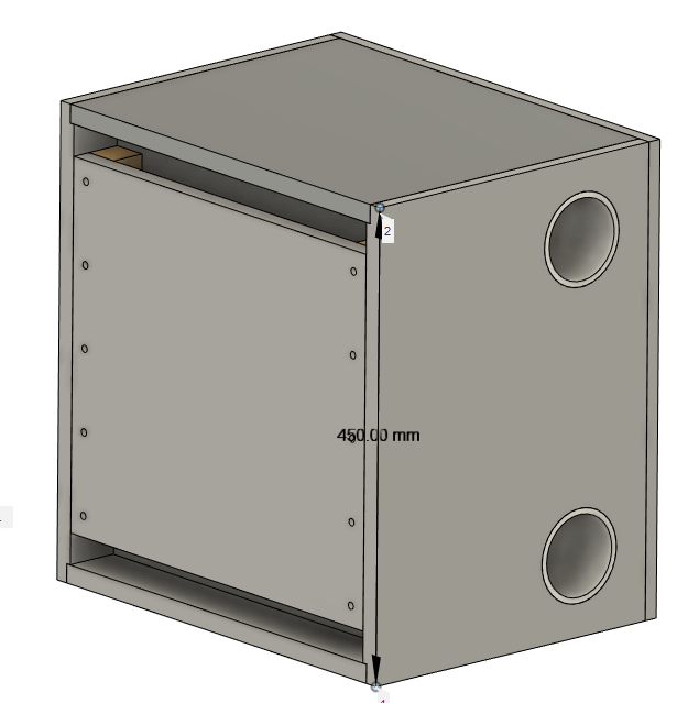

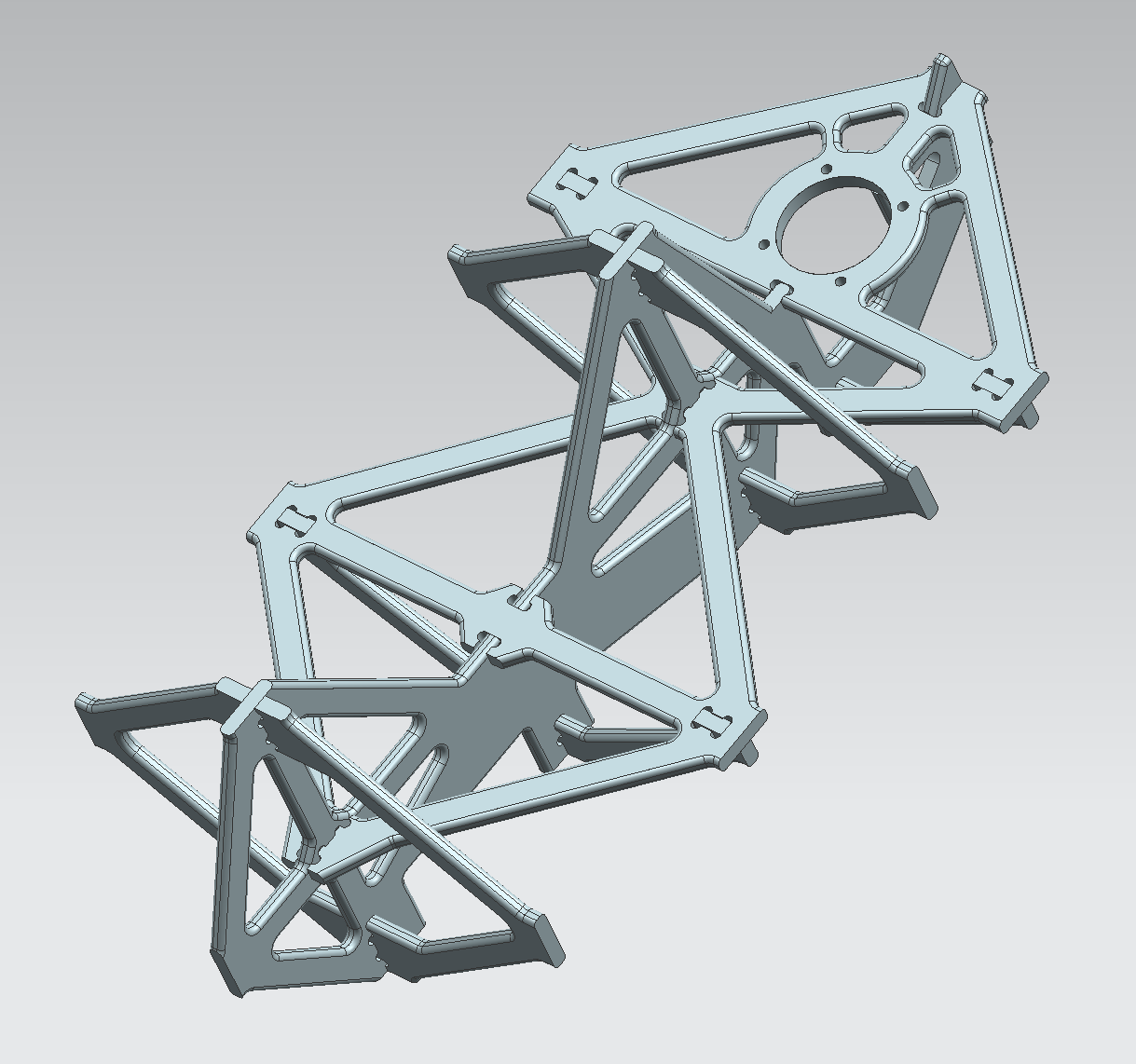

Been chipping away at the structural design of the unit here with the 9mm poplar ply.
Managed to achieve global stiffness and modal response performance "equivalent" to a 35mm birch ply box or 20mm with basic internal bracing. Could go further in FEM to reduce mass, but realistically there is less than 100g of optimisation left.
Slightly back to front, the internal bracing is an initial subassembly, which the enclosure is then built around. With overbuilt external panels and a trimmer to take care of tolerance - I'm hoping it'll be a piece of cake to build!
A ton of details to work out now - but happy with the overall structure strategy.
have you considered making the back and sides out of curved laminated ply to increase sitffness?

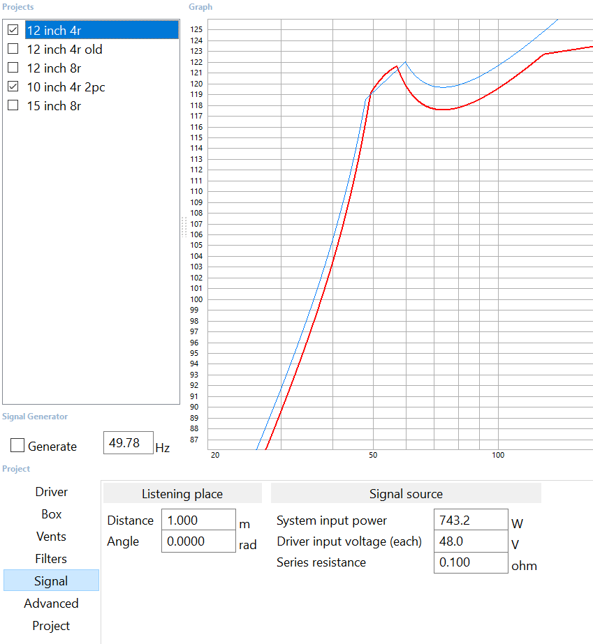

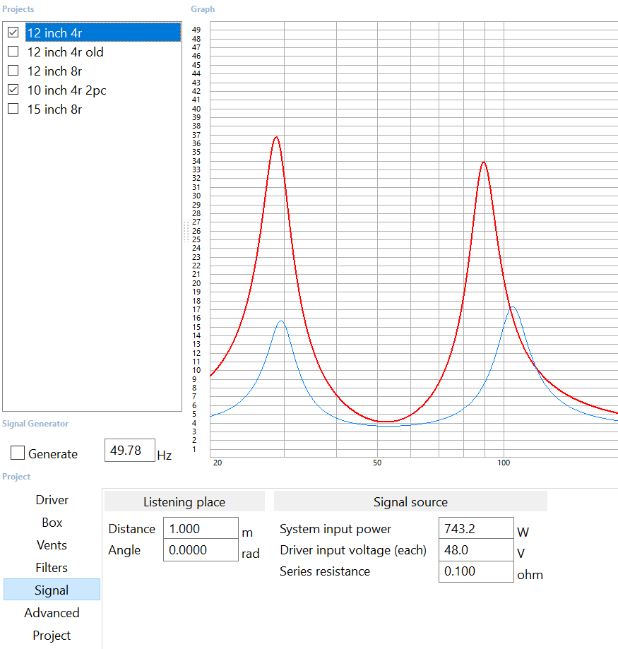

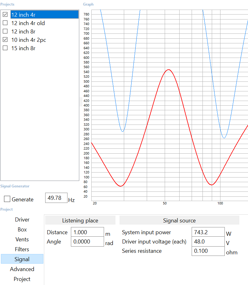

Getting a little mixed up where with calculating power.. Seems I have been underestimating the effects of impedance on the output.
I have been entering values into 'system input power' (280w@4r off TPA3255 datasheet), but it seems that entering 'driver input voltage' should have been done instead.
In this case, with 48v (Assuming there's a small drop from 50v supply), the system input power goes up to 743W (see attached).
Is this correct? If so, that makes my 80mm ports woefully undersized (vent velocities up to 50m/s!) and the excursion also goes through the roof away from port tunings (over XVAR above and below tuning frequency).
Good news is that maximum SPL increases significantly, and the 15CL76 (if I can shoehorn it in) becomes a viable option even. Otherwise, the two 10s may be reconsidered.

The "System Input Power" in WinISD refers to the loudspeaker system, not the total amp+speaker package. It is calculated from the stated Driver Input Voltage and the driver's predicted minimum impedance, whatever frequency that occurs at. Driver Input Voltage is therefore equivalent to the amp's Output Voltage, rather than it's supply voltage.
So, if your design has a Zmin of 5 ohms at 300 Hz, but doesn't drop below 6.5 ohms in the subwoofer region, the calculated input power may seem unexpectedly high.
In your case, 280W @ 4R is an output voltage from the amp of 33.46V if my arithmetic is right - might that have something to do with your 743W seeming so high?
HTH,
David.
Hi David,
Cheers for the reply,
I'm not sure it still makes sense to me though, electronics has never been my strong suit!
So, the 743V is derived from the Re: 3.1R, which works out with me.
However, if the datasheet dictates that the amplifier puts out 280W@4R does this mean that the amplifier with a PVDD: 50v only has an output of maximum 34V?
This doesn't tie up with what I am reading online for BTL amplifiers, whereby the full input differential is on the output, minus O/P losses. 😕
