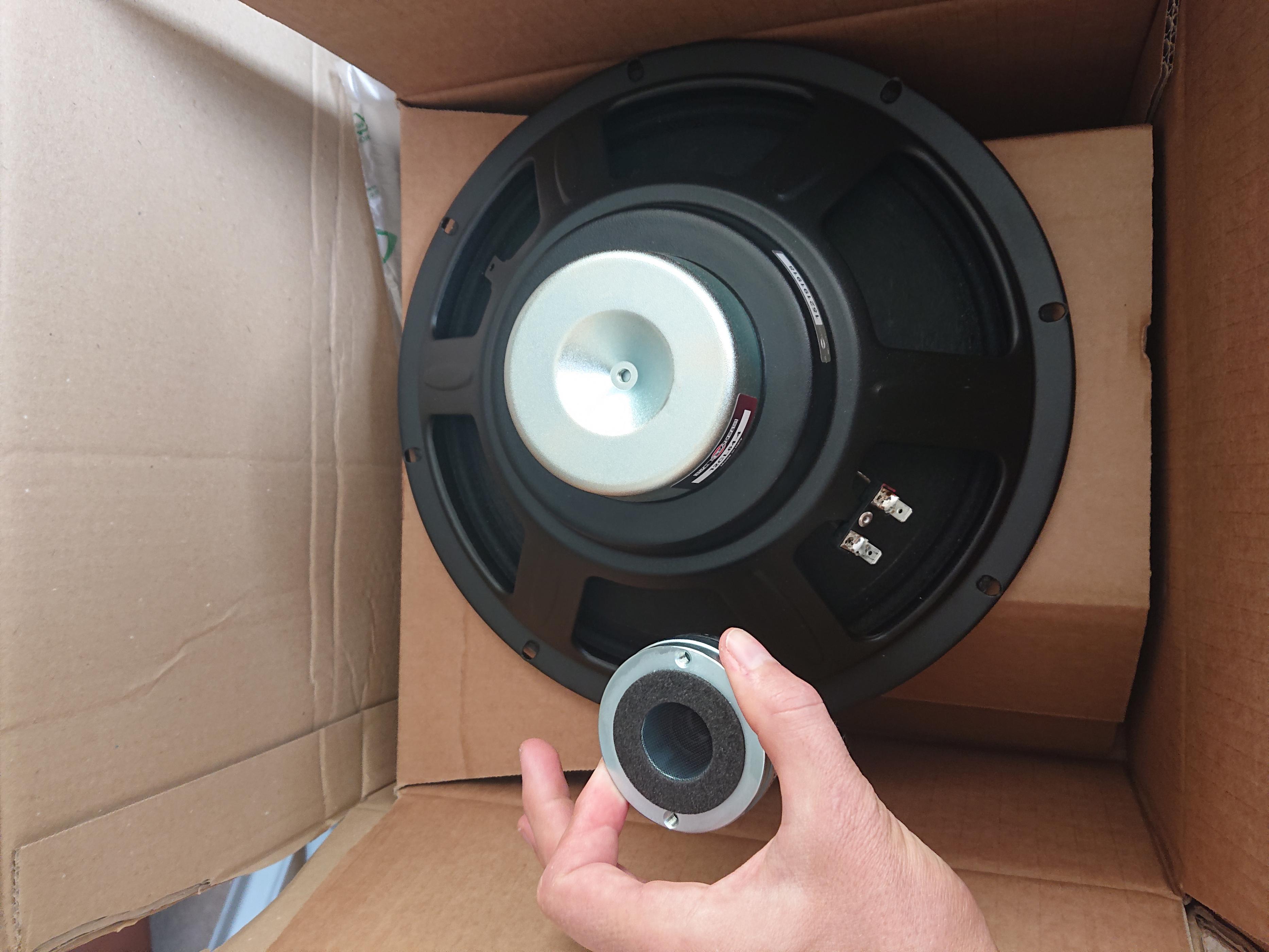

Oh, and these arrived. The 12" is hilariously light, and the 1" is simply minuscule :deerman:

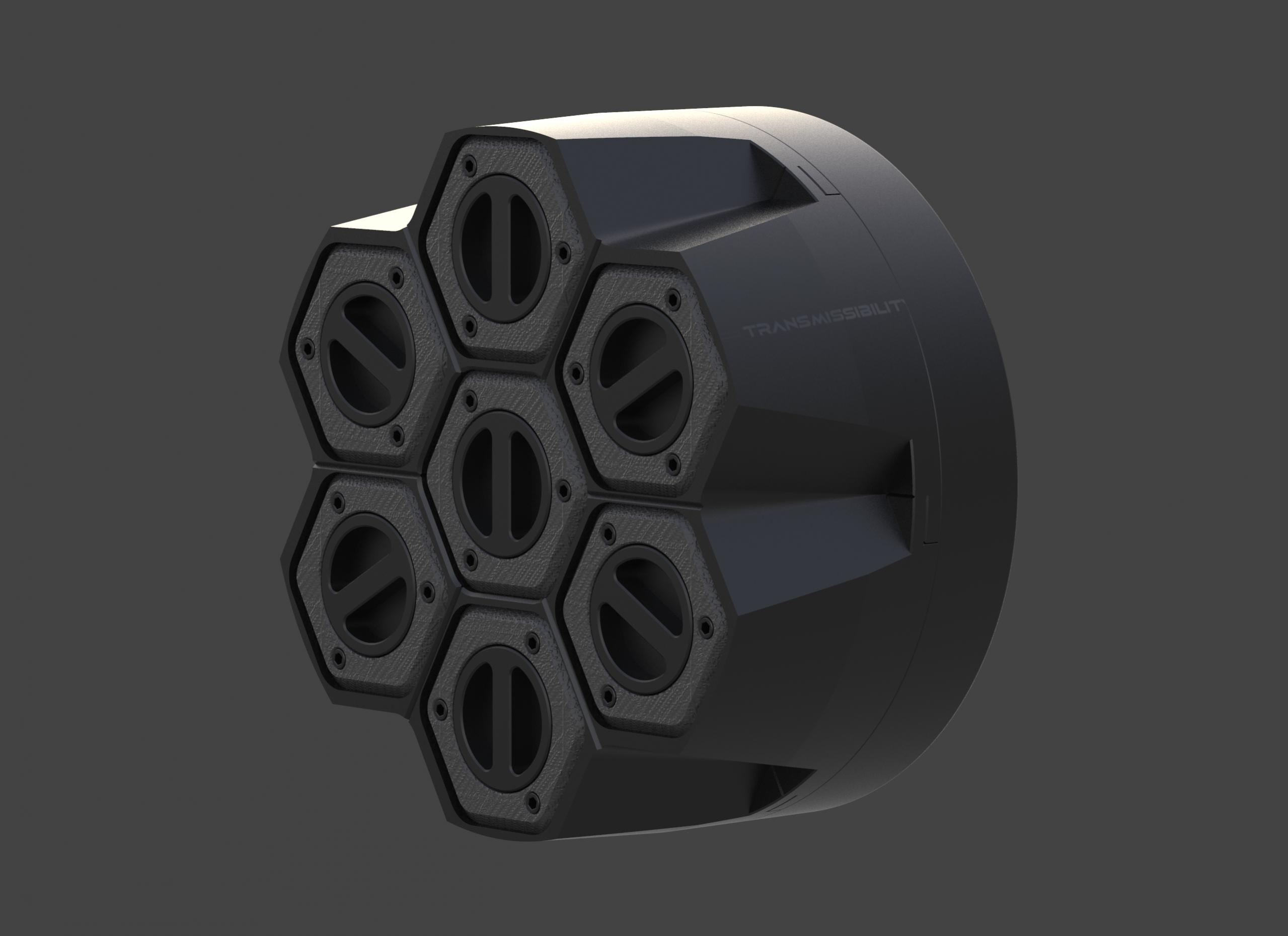

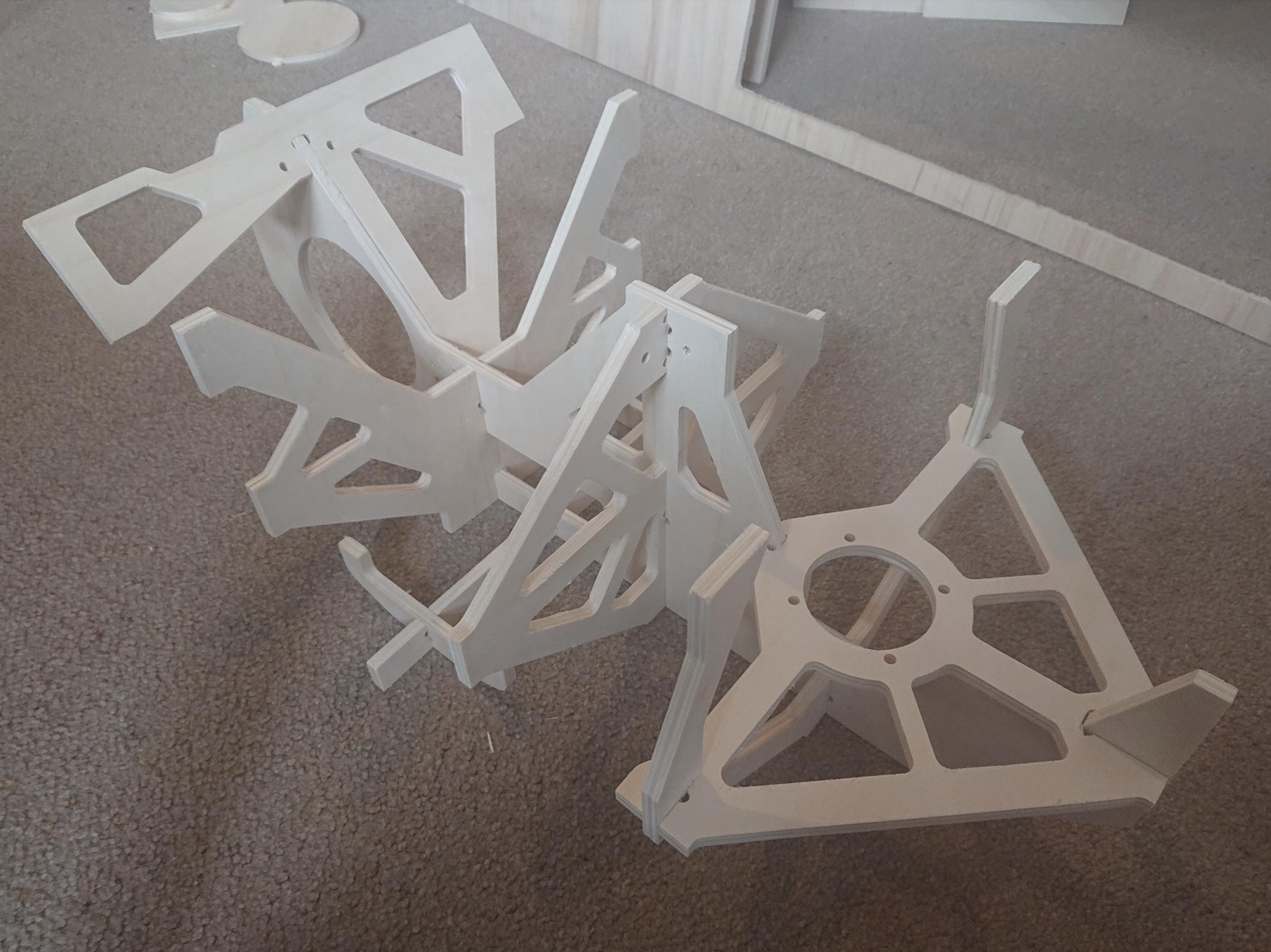

Bit of an update since it's been a month..
Design and FEA modelling has been finalised. All parts have been CNCd / 3D printed & sheet work cut+formed.

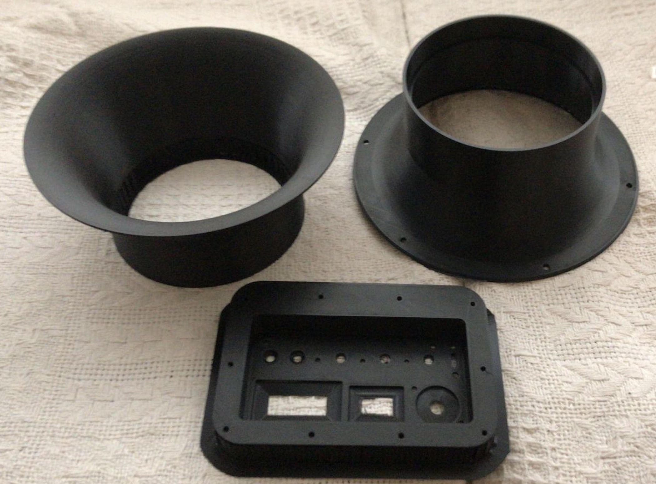

Attached a couple of images of brace subassembly, elliptical port flares and connection plate. Will try to get a screenshot of the full design CAD up at some point too.

Exactly, based off a different white paper but same approach.
Velocities are in the mid 30s, so hoping to keep flow profile sensible on port exit, minimising losses at high output. Will be interesting to measure the effectiveness.
Mid section is straight pipe (less flow critical) to enable length changes.

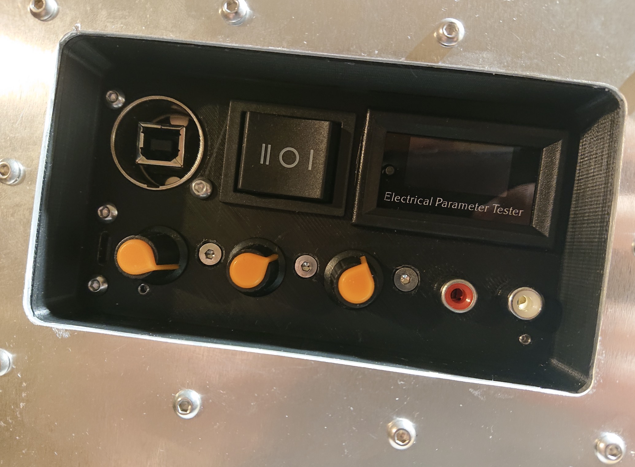

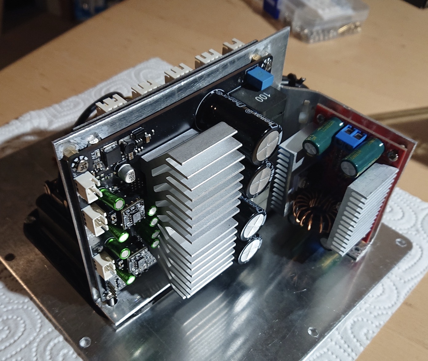

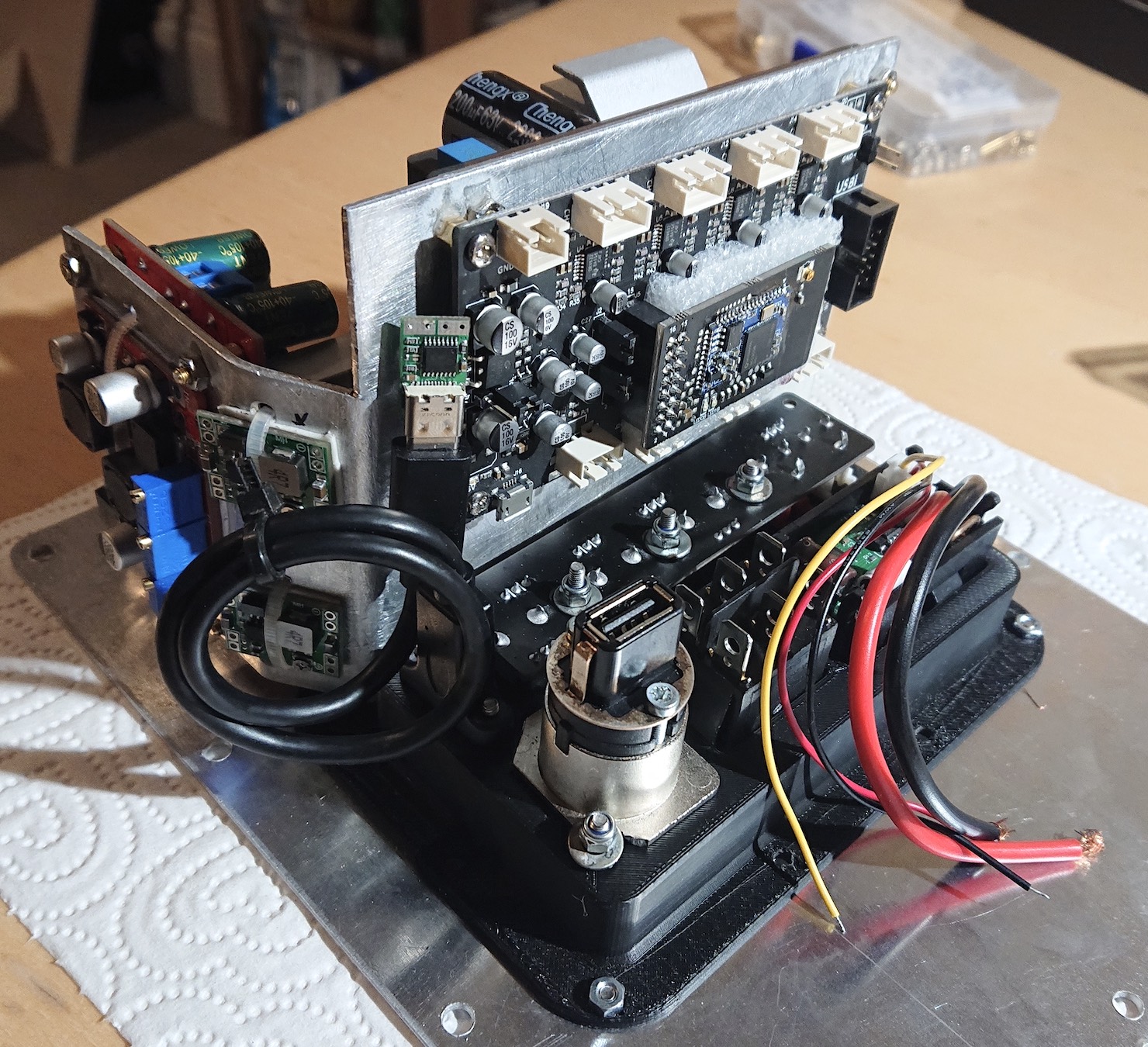

Bit more progress today, dry fit of the electronics is good (except for the poor USB panel mount connector).
Some neatening to do and a fan to add (to operate at full voltage) before it's buried under a sea of wires.

ah very neat. Your using the 3E boards and a boost converter from 12V? I found in use the 3E boards run cool.
I'm not sure how your generating the 5V for the USB charge port (presuming that's what it is?) but I had an issue with a board from aliexpress designed for ebikes for USB power that instead of generating 0V and +5V from the battery actually made +60V and +65V. This caused one of my DSP boards to blow up when I used the converter to power it (as it was connected to other circuits referenced to 0V).
This is an interesting project if you wanted to had field reconfiguration for the DSP programing (change EQ etc.): [SHARING] TCPi Interface for Sigma Studio, using ESP8266 or ESP32. - Q&A - SigmaDSP Processors and SigmaStudio Development Tool - EngineerZone
The battery pack is 43V (37v average). The I/O/II switch on the panel toggles between a direct connection to the battery or via the boost to up it to 51V.
Not entirely sure if anything unwanted will happen when switching over - fingers crossed for no fireworks.
Have stressed the boost with a 100W dummy load, and it seemed to run quite cool. Efficiency was an impressive 97%ish. The fan is more based on comments I've seen of the 3E TPA3255 running at 50V getting quite toasty.
The USB is for the USBi stick to connect to internally. They are both USB-A so makes it super easy for connections. I've toyed with the idea of having the USB-C power reversible - but keen to avoid (any more) scope creep haha.
The ESP option looks clever! Maybe I'll add it on in the future - cheers for the link!
aha I see I have the lower voltage TI chips that get less hot (TPA3251?) due to lack of TPA3255 availability when I built mine.
With my 3E amp boards they have a surface mount white LED that flashes to show clipping, if you wanted some more feature creep you could route that signal to an external indicator.
Ok, the build is progressing.. And it makes noise! I have tuned the port by impedance, good news is that I could accommodate the change in the design and it's a nice 30mm shorter 🙂
But I have hit two snags that I don't seem to be able to overcome:
1. The LED when connected to CLIP_OTW and GND, with a 47R current limit resistor always seems to be powered on slightly? And when it is supposed to clip / light up, instead it dims slightly? Changing resistor value doesn't seem to change behaviour weirdly.
2. I am getting a bit of a racket from the module when its bluetooth is active. Here is a video. It's worth mentioning that the noise floor is great when the BT isn't working. Also disconnecting the various DCDC converters and running off battery doesn't seem to help.
Not sure what else I can do for the bluetooth. Disconnecting the BT module and using the RCAs solves the problem.. But that's not an ideal solution !
Ok, so an update on the electronics:
1. Turns out the CLIP_OTW is a pulled high for OK logic output, so obviously unsuitable for driving LEDs!
I have replaced the on board SMD LED with one on flying leads and replaced the tiny SMD current resistor, but it only has source of 1.6V from FET and barely turns on the 1.8V Vf of the LED.
If anyone has any bright (gettit?) ideas of how to easiest get this LED to function that would be fantastic. I guess either to feed it higher voltage (perhaps the 3,3V generated on board through a separate transistor), modify the existing FET or circuitry, or to find a lower Vf LED (impossible it seems).
2. Major bluetooth noise is avoided by using the USB input instead. Seems that there's something in the on board 5-12v regulation circuit that is responsible for it.

@zerokelvin99 really fantastic looking work, especially the bracing. What FEA package and what's your setup strategy; are you looking at pressure vs. displacement?
