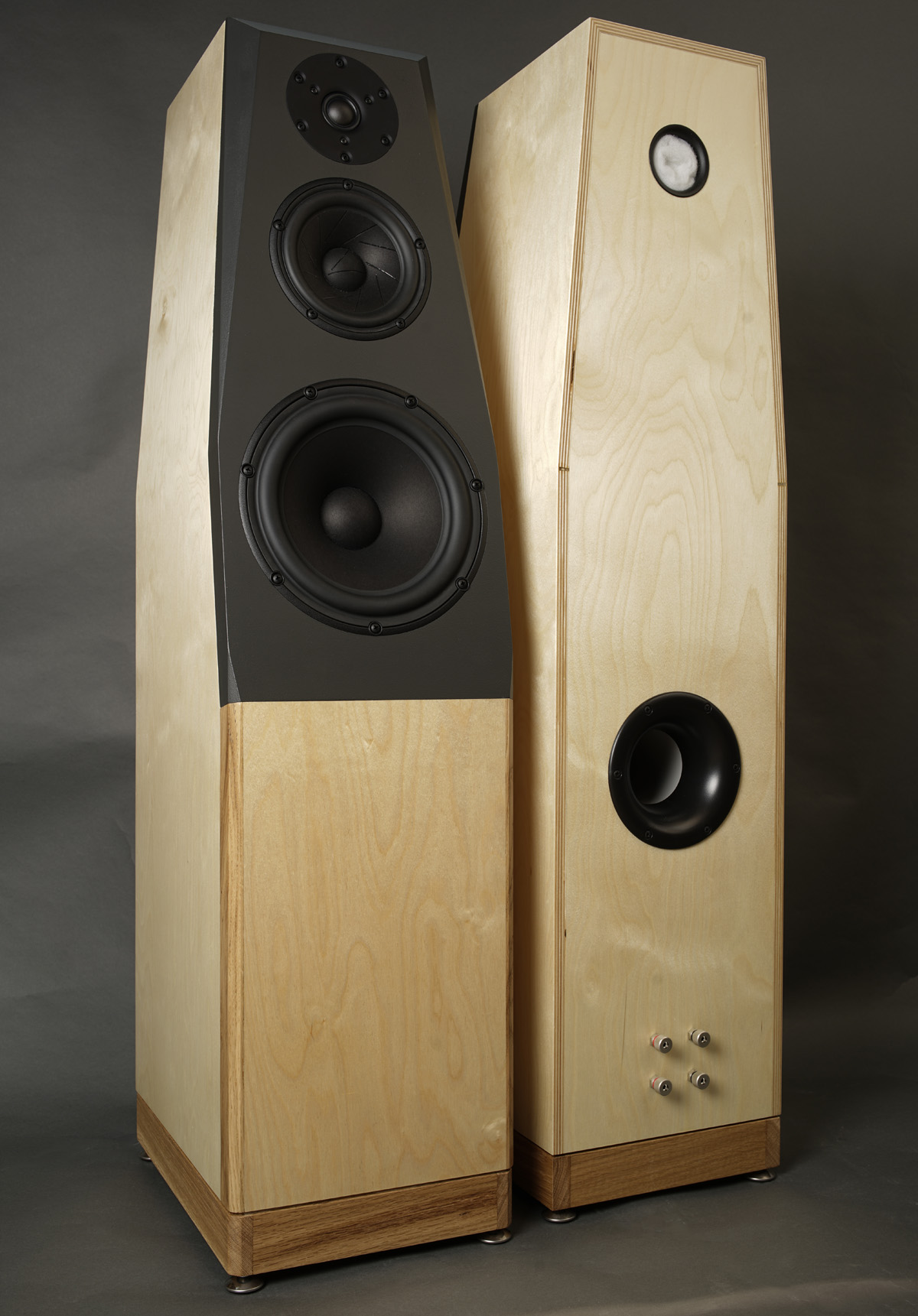

I was a bit confused by the whole "back to the root" thing centered about a certain middbass in a two way. It just didnt compute for me how to honor the latters with different drivers in a 3 ways. Are 2x6" or single 8 inch time-typical for your youth?
I must have missed something or miss-read sorry!
3 ways with real bass drivers were typical of my younger years unless you lived in a small room or had a limited budget. Friends bought Dali 2 and Dali 3 but they were sensible choices. Not what we drooled over.
A classic back to the roots but updated to todays standards and theory would in my opinion be "the monkey coffin speaker?" that came out of a very active thread here on diyaudio last year.

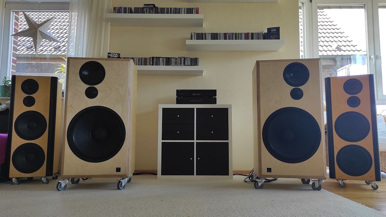

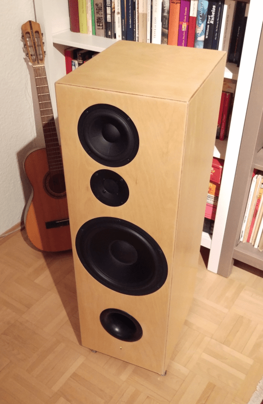

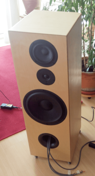

I once build these fat boys few years ago with Faital 18FH500:
They were nice and dynamic, but I never needed and used the extensive headroom. Luckily I was able to sell the cabinets and woofers together for a fair price.

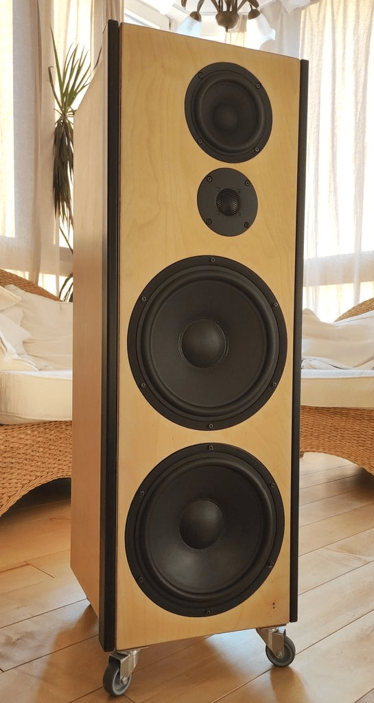

The other speakers beside are my "Scandinavian Connections" I'm working on since 2015 iteratively, They are my refencences and will stay forever, usually placed in my home office and sometimes in my living room, e.g. for comparisons.
View attachment 1261781 View attachment 1261785 View attachment 1261780

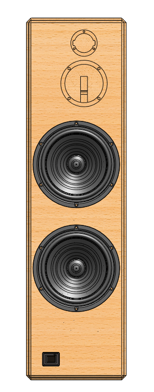

With the MkV iteration I won IGDH DIY contest in 2019, on the right is the current MkVIII with 2x 26W Discovery in 65l CB, SB15NBAC and Seas TAC/GB on Hypex FA123, woofers an mid with bucking magnets, mid an tweeter with serial notches on breakup resonances. They are electroacoustic microscopes and can do the dissapear trick impressingly well, very insensitive to placing playing confident in my 40m² living room as well as in my 11m² office without getting boomy. Hard to beat for my taste and the best speakers I ever build and had.

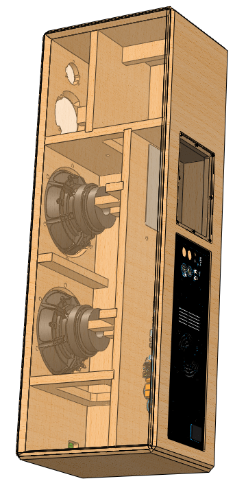

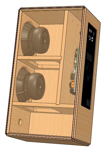

I already have some Idea that points exactly in that direction, but this may come some day as another project with Bliesma T25A, Kartesian Mid120, Hypex FA503 I already own and use in my main living room system, planning also with 2x 22W Discovery in CB for the woofer section to get more dynamic headroom than now but keeping the speakers compact:
View attachment 1261764View attachment 1261765
This would be another option I'm pondering around as an alternative to the CAD concept above for my living room main system. I'm thinking about "The Base" with two Faital 10RS430 in a very compact ~50l CB housing, the mentioned FA503 and a 4pole Speakon connection enabling the use of various tops with different driver combinations.

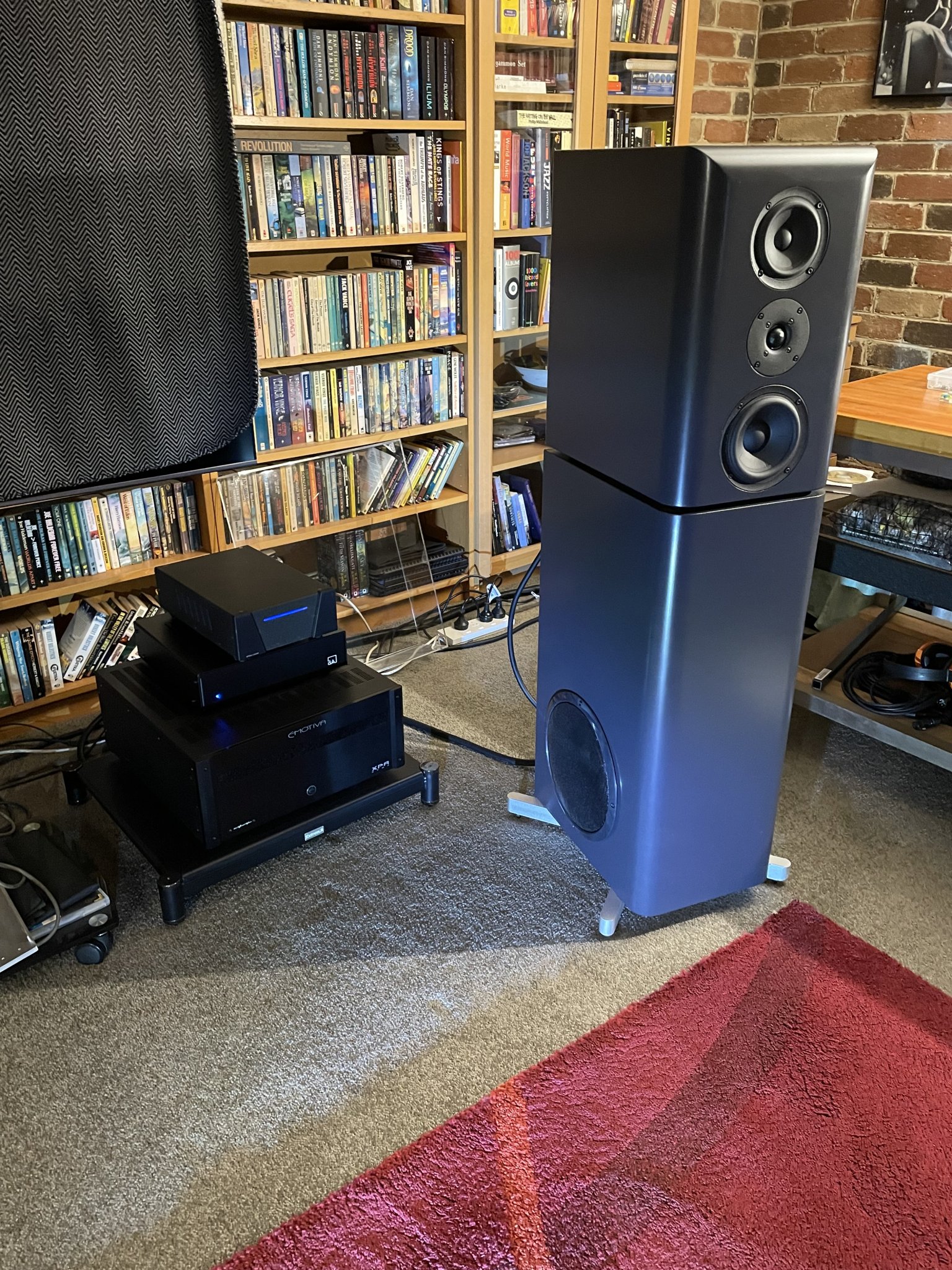

Consider a modular build approach, separating the bass/midbass from the mid/tweeter……reduced resonance bleeding into the mids and highs and easier to control bass cab enclosure resonance with the shorter panel lengths. More manageable to build, finish, move and set up. The mid/high seperate enclosure also allows for less costly and troublesome prototyping if you decide on different drivers with different sizes……even down the road for a total redo…..only redo the top.
A few iterations with various SB Acoustics drivers in the top box before settling on the final choice. Active crossover with DSP.

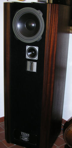

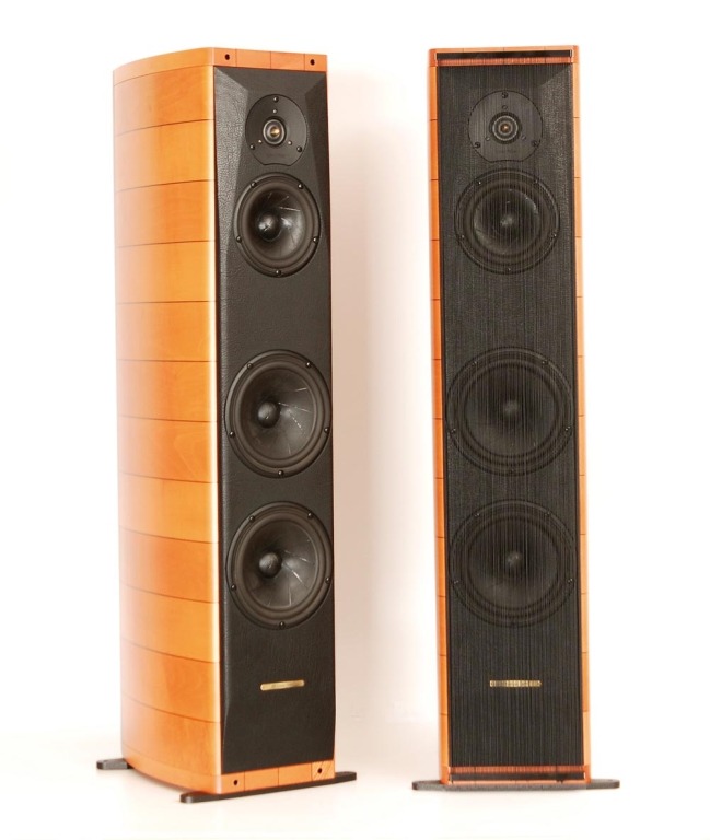

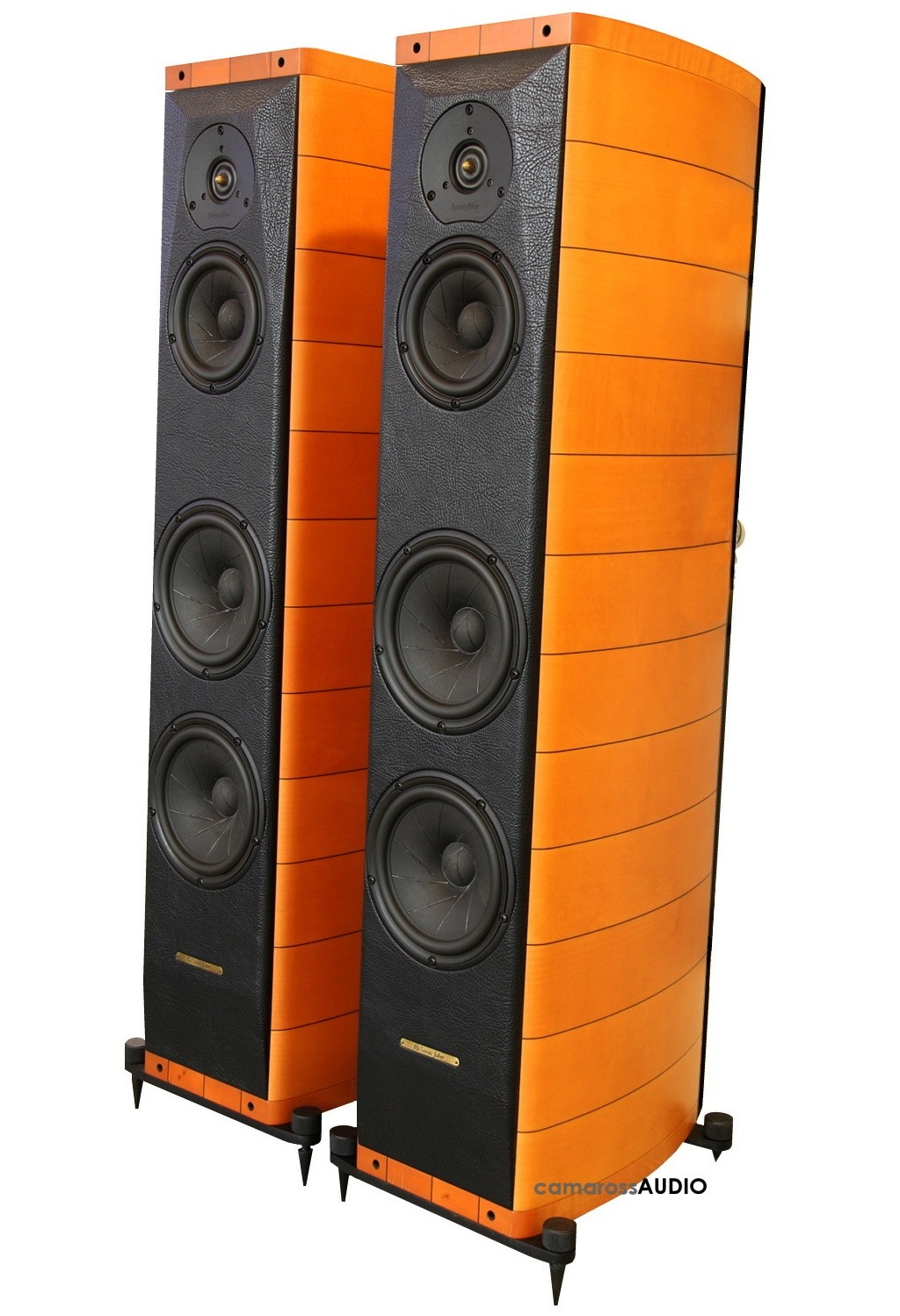

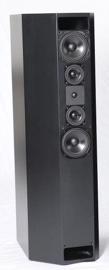

No. Typical for my youth is something like this, could be found in every middle class household living room back then, and in the rooms of friends and classmates who have attached some importance to their stereos:
Typical reference speakers in the magazines were e.g. like these:
But my personal "back to the roots" is aiming more to the sound of that 15W/XT LR2 2-way from my 1st post, not so to the general looks of speakers from that time...

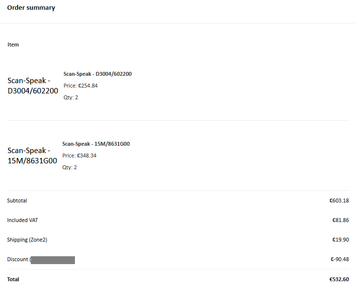

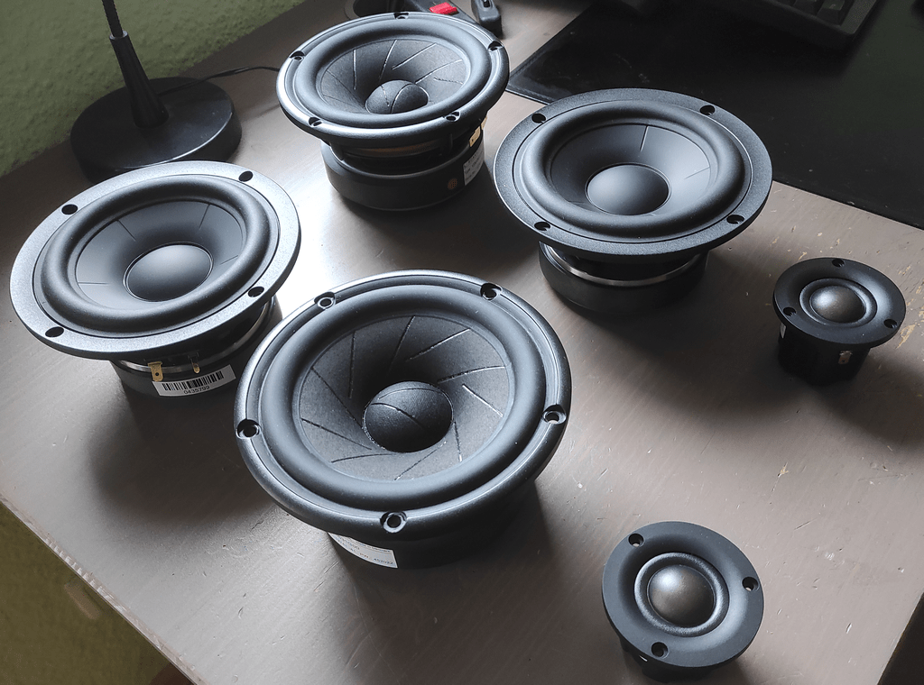

Was able to make a good deal yesterday, so mid and tweeter are fixed now:
https://compacbel.be/ has lots of Scan Speak drivers for reduced price at the moment (not often the case), and I subscribed to the newsletter that gave a 15% discount code additionally.
Nice drivers:

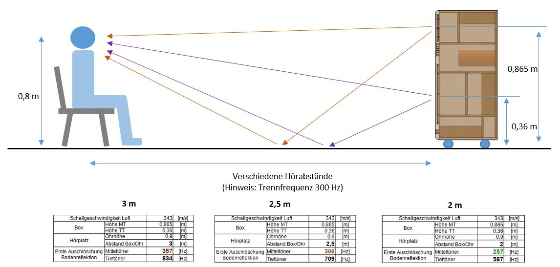

Consider a modular build approach, separating the bass/midbass from the mid/tweeter……reduced resonance bleeding into the mids and highs and easier to control bass cab enclosure resonance with the shorter panel lengths. More manageable to build, finish, move and set up. The mid/high seperate enclosure also allows for less costly and troublesome prototyping if you decide on different drivers with different sizes……even down the road for a total redo…..only redo the top. I could state with full confidence that you’d likely never feel a need to redo the bass section of the Dayton drivers.
I've been mulling over a lot now how to proceed, and the modular approach comes more and more in favor. 👍
I have some speaker in my living room that could be replaced, as I already thought about upgrading it with 2x 8" woofers + new floorstander enclosure. I would take the Hypex FA503 then and integrate it to the woofer section, with a 4-pole Speakon to connect and supply the mid-high units also active.
I could try nicely flavoured tops then: 🙂
1) a smooth one with the just delivered D3004/602200 and 15M/8631G00, back tiltet and more narrow, faceted baffle. If I want, I may later buy a R3004/602200 to compare the dome vs. ring radiator type.
2) a clear one, when I just put my standmounts with Seas DXT and SB15NBAC35 onto the woofer section enclosure and take the passive xover beside. I have a TAC/GB here in another speaker, that is a drop in replacement of the DXT mechanically and could be a nice experiment. I would also like to build an ASR Directiva R2 enclosure for the drivers by time.
3) a dry one, with the T25A and Kartesian Mid120_vHE from the donor living room speakers, on a wide, rounded baffle. Eventually I can make the rebate of the mid compatible to Bliesma M74 type, outer diameter is the same. When I might have some money in a few years or so for them, I may try a M74A or M74P for ultra clear or ultra dry sound. Or I just try another T25 flavor like S, or B when available again.
4) Would be great if the woofers run up to ~1kHz, then I may try just putting a cool looking larger horn with 1" compression driver <1kHz on the woofer section.
...and maybe more, but this should fit my hobby ambitions for the next years.

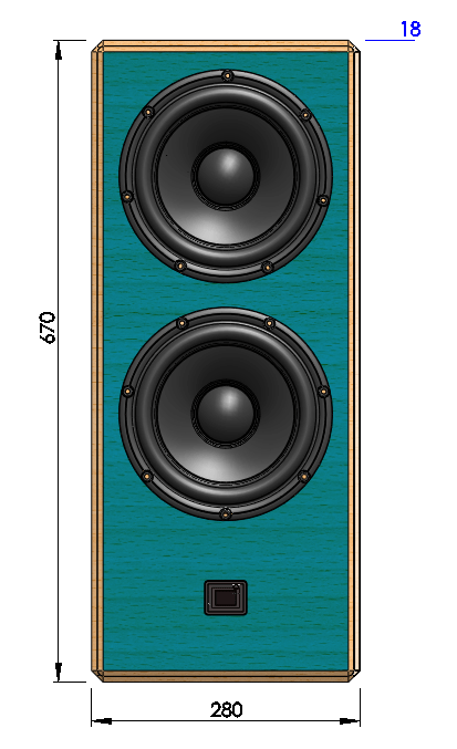

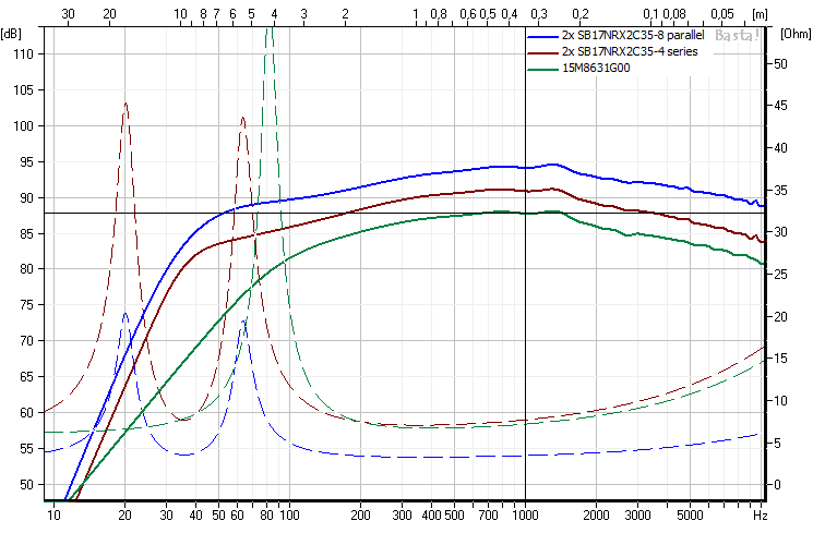

For the woofer section I decided to take 2x 8" 8 Ohm parallel in 40-50l CB for both. Past experiences with different woofer size classes in my living room let me think this should be pretty enough and can go really loud when you take capable drivers. Planned with 2x 8" for the upgrade of the donor speaker in the living room also. 500W of one FA503 channel shall than be enough to push a pair.
TheBase may look like this:
Had following woofers on my list, the best 8 inch woofer thread also helped me alot:
Value class:
Dayton RS225
SB Acoustics SB23NBACS45
Scan Speak 22W/8534G00
Failtal 8RS350
--> would take the Scan Speak. I like the 26W very much, and the 22W has nice measurements and simulates well. Price here is 100-120.- €

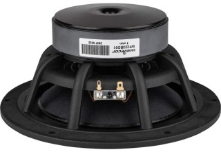

Performance Class:
Scan Speak 21W/8555-10
Wavecor WF223BD02
Dayton RSS210HO-8
SB Satori WO24P
Visaton TIW200XS
PHL 2730
--> Wavecor is favourite, shows flawless measurements in the german DIY hifi magazines, really wide range and low distortion, very high Qms. Price is around 240.- €

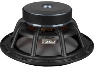

The 8857 is worth every penny, and is the best 9" class driver I've listened to. It was used in the Cantilena by Rick Craig and Paul K. Marvelous woofer it is.
Cantilena is with Morel 2" middome or? So xover to the woofer was around 800Hz-1kHz? Good to hear the Revelator can deliver that, would enable the option with the horn! Also HH magazine recommends usage up to 1k in accordance to their measurements.
@tktran303 : The 26W/8857 may be also great driver but no, the overall enclosure shall be sized and designed for two capable 8" in 40-50l CB and a chamber for the Hypex. That shall be the right overall woofer system size for supporting smaller, single mids and 1" tweeters, and for my needs regarding living room application.

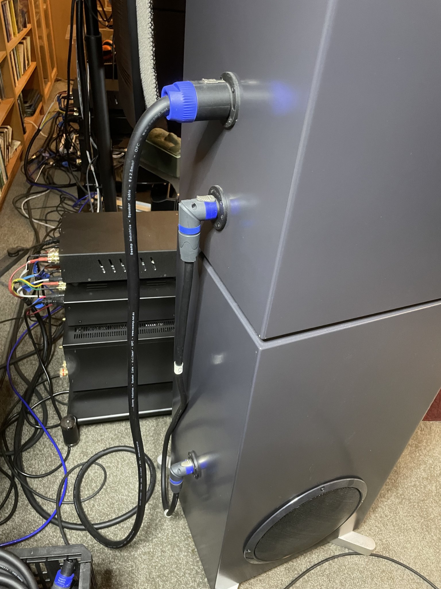

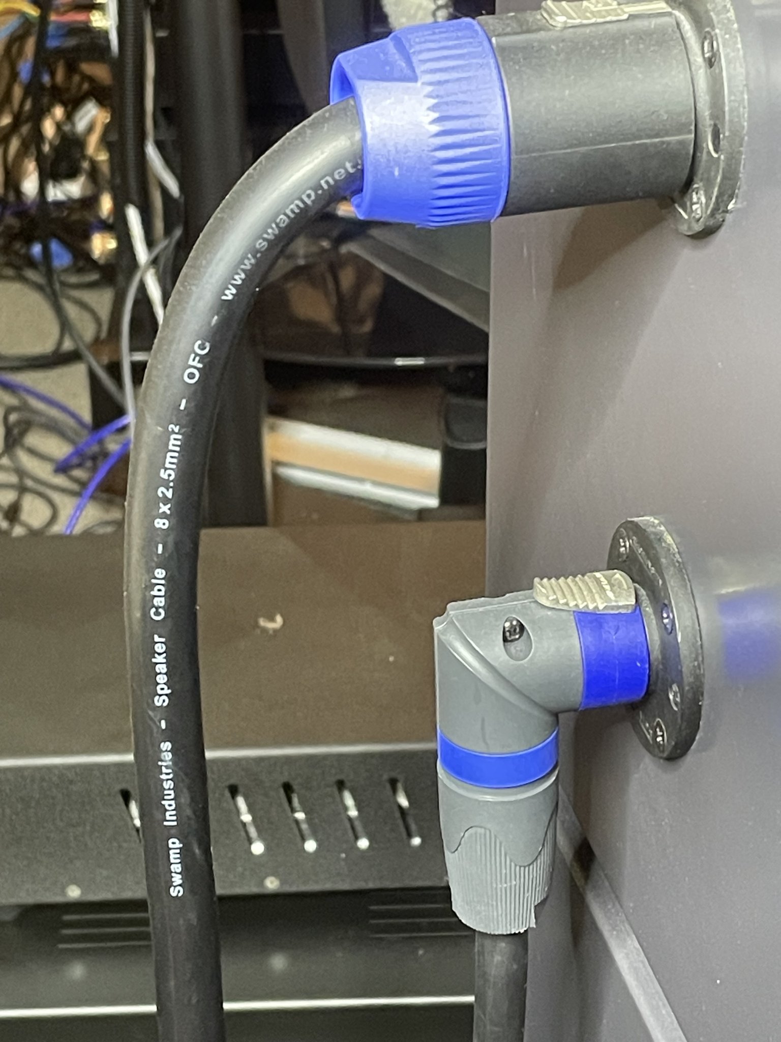

@Kwesi
8-pole speakon connectors are a great solution for 3 or 4 way active speakers. Decent quality 8-wire and 4-wire cables are readily available from Live Sound and PA suppliers.

I already own the driver sets for the 3 possible top enclosures I listed:
1) D3004/602200 and 15M/8631G00
2) Seas DXT and SB15NBAC35
3) Bliesma T25A and Kartesian Mid120_vHE
Target is to put them all in (different) small enclosures < 8l easy to store and exchange.
I also already own the 2x Hypex Fusion FA503. Therefore the modular approach with a separate woofer enclosure with the Hypex and 2x 8" to "serve them all". Just change the little top part (Speakon connection) and select/upload another Hypex setup.
So the gerneral concept is decided, woofers are missing and have to be selected and ordered. Enclosures have to be build then, of course.
