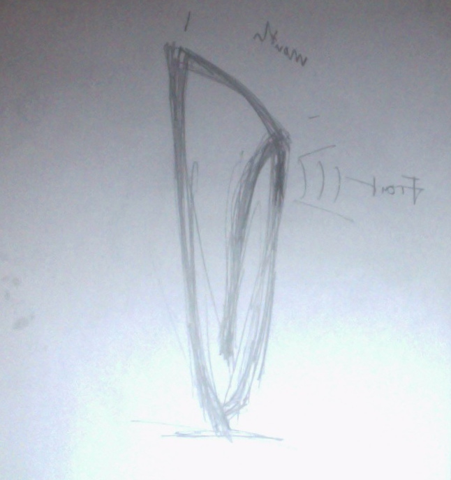

sorry, I can't unreverse it (mac photo booth😡)

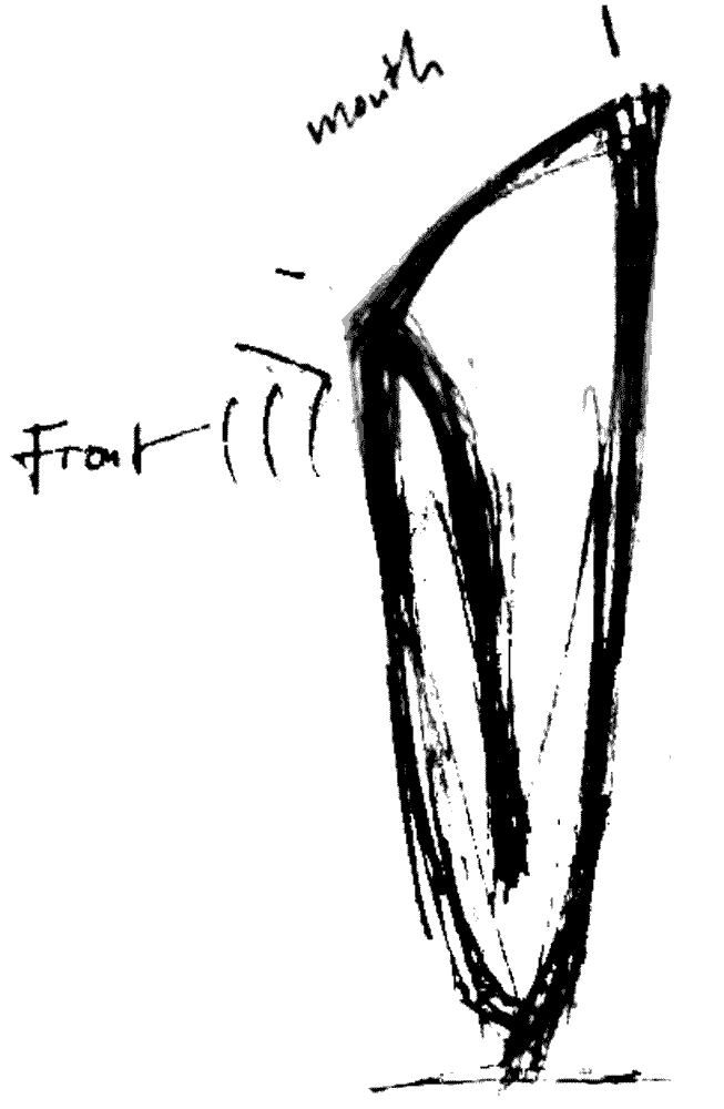

Godzilla, this is the rough shape i had in mind a couple of days ago

I'm either very sensitive to time smear or the single fold (rounded) with a slanted vent spews out a lot of rubbish. Was pretty heavily stuffed at one point which helped but murdered the output. Hitching the whole thing up on legs so the vent was closer the ceiling did help but still had quite a few substantial dips that would have needed more eq tweaks then I'd be willing to use.
If you feel you're especially sensitive to group delay, why are you playing with back-horns? Of all the vented enclosure types, they are the hardest to minimise the effects of GD in.
Just ruling out feckless design. I don't particularly want to use woofers to get the driver low so trying one more with a double mouthed rear firing horn, then I will have to use an mltl crossed to subs around 80hz.
I thought it may have just been the driver but I borrowed some fe166's and made an MDF haruna and still had the same problem.
