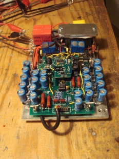

What a beast.... ...settled the switching frequency around 310kHz... to care about all the details I described prviously and at least it seems to work OK now. I had quite some struggle during my small signal measurements. It seems to be possible to kill the IRS20954 if the comparator stage is delivering disturbed signals. I killed the IRS20954 two times during measuring the small signals. In both cases the power stage remained perfectly fine, but the IRS20954 was dead. The lower driver stage was defect, short between LO & VCC. I do not like this sort of failures... causing some doubts regarding reliability.
Hm, what else do I not like?
The selfresonant topology is nice and simple. But in case of heavy clipping or short disturbances it tends to lock up. A huge capacitor for VS-VB is improving but not 100% curing the clipping behaviour, right now I am using 10uF.
...thinking about the second chanel. With the experience from above I am not really willing just to reproduce a second full bridge.
I am thinking about a different PWM system and also I am thinking about the IRS20955. It has a longer blanking for the OC detection, 450ns instead of 200ns.
Furtheron it is also offered in dual inline package, which is much more repair-friendly. Removing defect SMDs is always stressing the PCB and killing the entire set up already after 5 defects... So I prefer the dual in line for the R&D work.

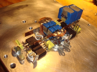

ChocoHolic said:Furtheron it is also offered in dual inline package, which is much more repair-friendly. Removing defect SMDs is always stressing the PCB and killing the entire set up already after 5 defects... So I prefer the dual in line for the R&D work.
If you don't have or have access to a hot air rework station removal of SMDs without damaging the board can be rather difficult. 5 repairs on the same spot is really good without hot air! With proper hot tools I've been able to replace 80 pin micros upwards of 10 times without any visible damage to the PCB.

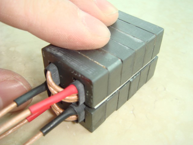

Two more points for discussion:
1.
My current output filter consists of coupled inductors 2x4.5uH acting like 1x18uH, 2x1.5uF to ground and a 5 Ohms+4.7 uF filter damping circuit....
It provides less than 2db ripple and f3 above 30kHz at all normal loads. Means no load ... to 4 Ohms.
The remaining HF output ripple is about 2x1.5Vpp if the full bridge runs at +/-55V.
If I measure the impedance of my Dynaudio speakers, I can find a 5.4 Ohms impedance with 12° inductive phase shift at 310 kHz. This means I would have something like 0.7W HF ripple losses in the tweeter. This will probably not immediately kill the tweeter, but it is already an unpleasant 'bias heating'....
What are your expiriences in this regard?
2. In general if we supperimpose two signals with slightly different frequencies this will add up to an signal with an envelope that shows an beat of f1-f2.
If we imagine class D amplifiers... left chanel running at 314kHz, right chanel running at 310kHz... then i am wondering if this could lead to an audiable f1-f2 beat...
Any experiences with that?

ChocoHolic said:If we imagine class D amplifiers... left chanel running at 314kHz, right chanel running at 310kHz... then i am wondering if this could lead to an audiable f1-f2 beat...
It sure can. How audible the beat frequency is depends on the extent of the interaction between the two circuits; physical separation, radiated immunity, susceptibility to EMI, power supply configuration, and wiring are some of the main points to consider.
ChocoHolic said:Two more points for discussion:
1.
If I measure the impedance of my Dynaudio speakers, I can find a 5.4 Ohms impedance with 12?inductive phase shift at 310 kHz. This means I would have something like 0.7W HF ripple losses in the tweeter. This will probably not immediately kill the tweeter, but it is already an unpleasant 'bias heating'....

u r right
i have a damp working at 700Khz and +/-50V ,
if i btl it, the power is very high,
i use fets can working at 20A (one fet),
and i use a 1000w sw-power .
so the max power output is close to 800w.
but i'm not have a full test now, is busy this days.
i'm drawing a new pcb use 40A FET, can working at +-80V or +- 90V, is a test board for high power output .
but i think i will let it runing at 400-500k.
if mutichannel, 380k,430k,480k,530k, i think is ok,
