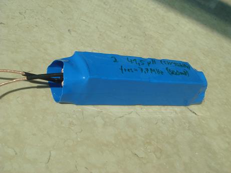

Currently I am working with slightly above 100kHz, but the switching behaviour and losses are pretty OK and so I am thinking about stepping up to 300...400kHz and enable the design for full audio bandwidth.
My current output choke is far from any optimized design.
I just quick & dirty used some excess ferrite scrap in my assortment. Means the core is a stacked 15xEF25 resulting in a huge Ae of 750mm^2 .
This geometry is unfortunately resulting in a quite unpleasant ratio of wire length per turns vs Ae and with this in unnecessary high Rdc and lowered resonance frequency compared to an optimzed design. Also overall size is large. ....but well using up what you have....
Instead of a bobbin I bundled the wires with an insulating sleeve inside the core.
The air gap is 2.2mm. Number of turns: 10
Wire: HF-Litz 150x0.1Culs.
I also examined solid wire, but the eddy current losses of the leaking field from the air gap heated up the choke about 10C already from +/- 3A/100kHz idle current in the filter. Now with this litz there is no self heating at idle situation at all.
Rdc is around 50m Ohms.
L is about 42uH.
Resonance frequency of the choke is 7.7MHz.
Saturation is theoretically somewhere around 60A (not measured up to now).
For optimization I am thinking about an ACP cut core which allows 3-4 times more flux density than ferrite and still offers reasonable HF-core-losses.

ChocoHolic said:Currently I am working with slightly above 100kHz, but the switching behaviour and losses are pretty OK and so I am thinking about stepping up to 300...400kHz and enable the design for full audio bandwidth.
Switching frequencies as low as 200-250kHz will work fine for full audio bandwidth (i.e. up to 20kHz) and will probably allow your design to operate more efficiently. Very nice project by the way. Thank you for sharing with us 🙂

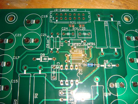

Hi ChocoHolic
For D8,D9 you said
For D8,D9 you said
What do you mean here? Aren't GNDs connected together?GND connection of D8 is at Power GND, but should be clean signal GND. Reroute manually...
GNDs are connected together, you can see it in the picture of the PCB, GND side.
But you always have to take care with GND.
You must make sure that all signals are referencing to the same potential and if you run high currents through signal GND tracks then the GND potential is depending on the position were you connect to this GND track.
Any error signal on this track is adding to the audio signal and most accidential add ons do degrade the behaviour.
...it's just about controlling which paths do which currents take...
Simply assume that any copper track is series connection of many small R and L, with additional parasitic capacitances to any close track or component. ...so don't believe GND = GND...
Have a look to several threads regarding different GND routing philosophies.

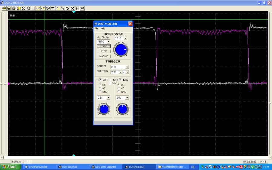

Well, nevertheless some more infos from the last days.
I was pushing my proto to something like 320kHz and had to reduce the gate drive resistors to 5.6 Ohms ...uhhh now dv/dt in hard swithcing condition is around 5kV/us. Right at the specified limit of 5.5kV/us for my MOSFETs. Output filter choke was reduced to something around 10uH.
The triangular inductive ripple current of the output filter is really nice to provide perfect ZVS in idle condition. 😎
Also I had to strengthen the IC supply, driving two 150V/60A/32mOhm MOSFETs at 320kHz is demanding some current....
Furtheron I noticed that the required driver currents are depending on the MosFet load.
In ZVS condition, Uds has already reached zero, when turning on. So Ugs can be pulled up quite easy. Almost no Miller plateau. But if the output load is high and no ZVS anymore, but hard switching... Then Uds is ramping down due to turning ON process of the MosFet. The driver has to deliver the additional charge for the drain-gate capacity and must draw this from the IC supply.
Different from ZVS condition, during hard switching the Miller plateau is becoming quite strong. So already here you can see that the drivers have to deliver longer high currents to turn ON the MOSFETs.
In ZVS the charge for the drain-source-capacitance of course also has to be delivered, but then it is delivered from the load circuit and the MOSFET driver does only conduct it through the freewheeling diodes of the driver output or sink the charge to GND or VS respectively . Means this charge does not cause any stress
to the IC supply.

Hm, in real life I am observing one additional effect.
Besides generally increased current consumption during hardswitching. I always see (also at no load and nice ZVS), that the IC is consuming more current during positive signal half waves compared to negative halfwaves. This might be related to IC internal structures, which might need more supply current for HIGH state and less supply current for LOW state.
And during the positive half waves we have longer times HIGH state and shorter times LOW state.
Sorry, no screen shots this time. All lost in my dead laptop... 😡

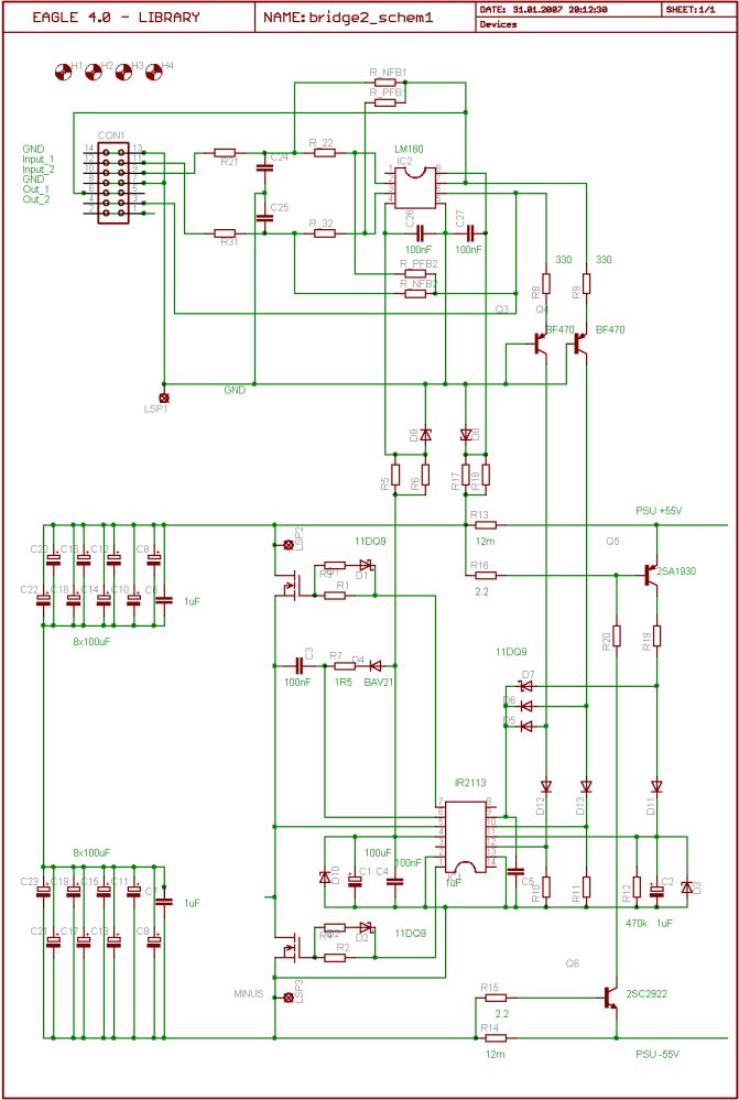

I got annoyed and had the feeling that the IRS20954S would be oversensitive...
So I set up an trial design with the IR2113 according the attached schematic.
For these trials I settled the resonating comparator with local feedback and let run the power stage without feedback in order to get allways a PWM signal, even if the halfbridge shuts down or shows interuptive action.
With overall feedback it is hard to figure hard if the oscilator was in trouble or the power stage in case of interuptive operation.
Further design considerations:
- Q3 and Q4 are forming a fast level shifter.
- IR2113 logic tresholds are a fixed percentage of the logic supply voltage. Means if the supply voltage is drifting different from the logic signals, then timing will move some ns.... (of course only, because the edges of the logic signal also need about 20ns transition time from LOW to HIGH.). D5 and D6 are settling the logic supply, while D12 and D13 are making sure that the logic signal are not higher that the logic supply. Actually this configuration always results in logic signal = 100% of logic supply.
- Q5, Q6 are sensing overcurrent and trigger the shut down of IR2113.

Didn't you say that it was working with 800w in to 2 ohm load, how did you came to that it is oversensitive? Maybe it would if you would use 4060 and oscillator.
Findings with IR2113
- Error of the level shifter is neglectible. Nice.
- The IR2113 propagation delay is specified as max 150ns. In reality I found 180ns. Not nice.
- Propagation delay matching is specified as max 20ns. In reality I found about 10ns. Not so bad but needs adjustment. In my case a 10pF cap in parallel to R10 gave good matching results. If you need high precision with IR2113, then you will always have to do the adjustment for each individual IR2113 sample.
The attached screen shot is showing both IR2113 output after I had adjsuted the timing.
