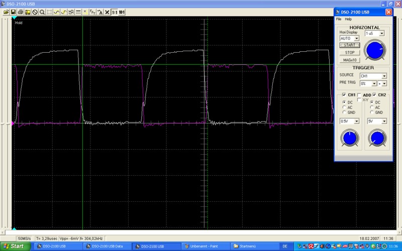

OK... Summarizing my findings:
- Due to only 200ns blanking of the OC detection you must bring up the gate drive voltage up to about 10V within 200ns. This is determining the slowest allowed switching speed. And I found that with this the current commutation does take place in round about 20ns.
I cannot measure this at high currents due to several restrictions of my DIY equipment...
But you can see the necessary information also from the gate drive voltage. Current commutation at hard switching must take place in the time frame, after Ugs crosses the MOSFET treshold voltage and before the Miller plateau (neglecting the internal gate resistance of the MOSFET).
Red: Uds of lower MOSFET, 50V/grid , 1us/grid
White: Ugs of lower MOSFET, 5V/grid, 1us/grid

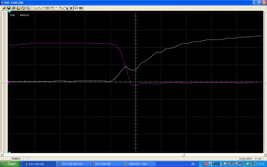

...if we zoom into the details, we can see that the related times are short... hard to say exactly, may be about 20ns...
Means at 50A ==> di/dt = 2500A/us.
Means every nH causes a 2.5V voltage spike.
Means about 1V spike for each mm wire length.
Red: Uds of lower MOSFET, 50V/grid , 100ns/grid
White: Ugs of lower MOSFET, 5V/grid, 100ns/grid
That's tough.
And please note this is already the slow switching version....

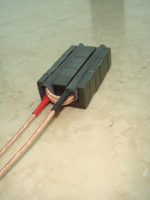

Hm, ... here some pics of my new output inductor...
A 6xEF25-scrap design.
