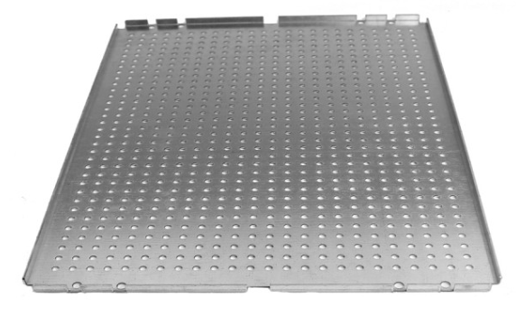

Since the cooler is not being sealed in any way, but simply sitting down, it's good to know that you've achieved some interesting results by simply dissipating the hot air escaping from the entire lid of your amp and from the slits on it.
However, if the cooler is not sealed then the air that comes out of the slits is almost exactly what comes out normally and furthermore the cooler will also suck air from all the lateral space, which means poor cooling efficiency.
If you place a single fan (on the amp cover or elsewhere) you will get most likely a negative pressure inside your amp and then all the smallest openings in the case will suck-in air at high pressure because the fan itself will force it out of any existing holes or slits.
All existing openings will soon be covered in dust and will shortly affect the effectiveness of the cooling.
Unless your amp has a surface area resulting from the sum of all existing openings and slits that allow an adequate volume of incoming air flow equal to that of extraction.
In any case, filtering the air remains an essential factor.
By the way, I just imagined to calculate the free surface of all the holes (compared to the fan's air volume flow) of an internal base (or even of side bulkheads) like this,
which in any case if not filtered (the holes) from the outside would quickly fill with dust due to aforesaid negative pressure.

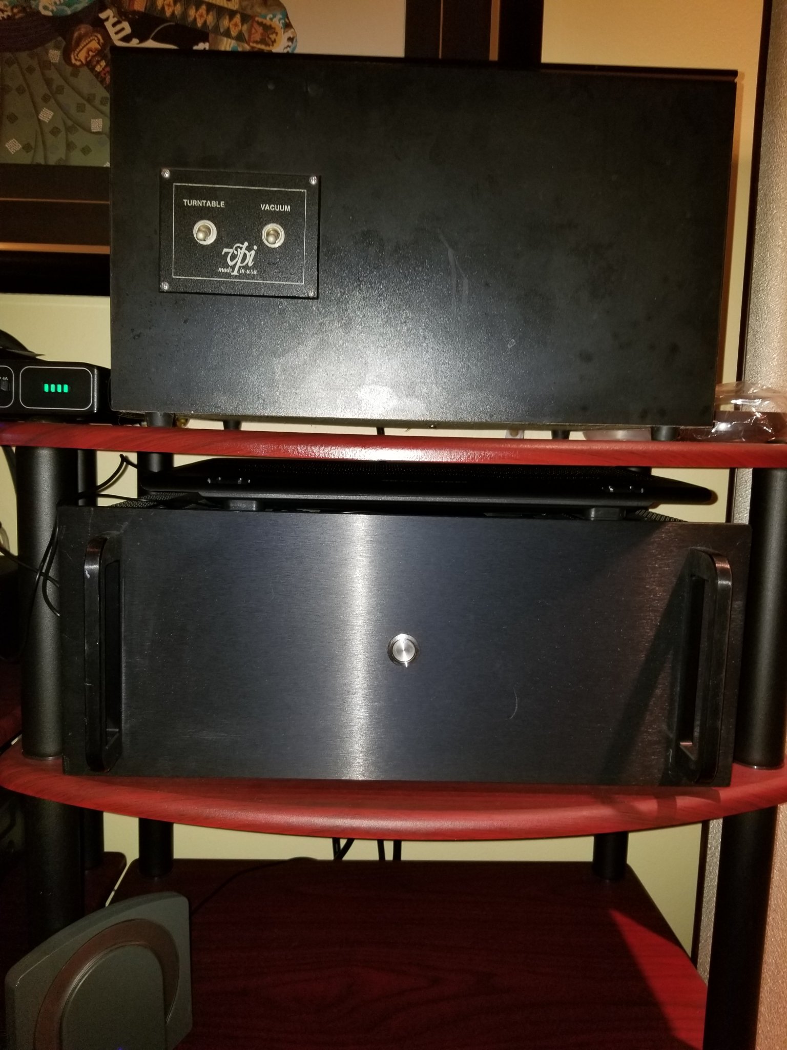

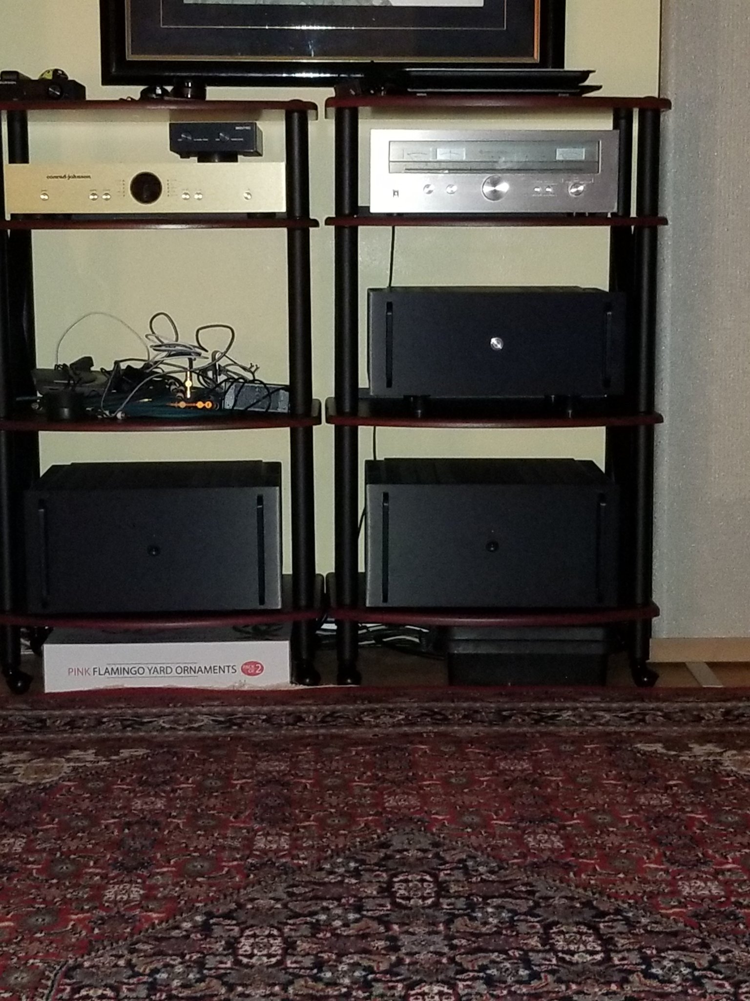

Ok, ready for Phase two.... amp racks are rebuilt, the bottom shelves are now a full 12".
The A2s are on the bottom shelf, the Sissy on the next up, to the right... the Macho SIT will go next to it.

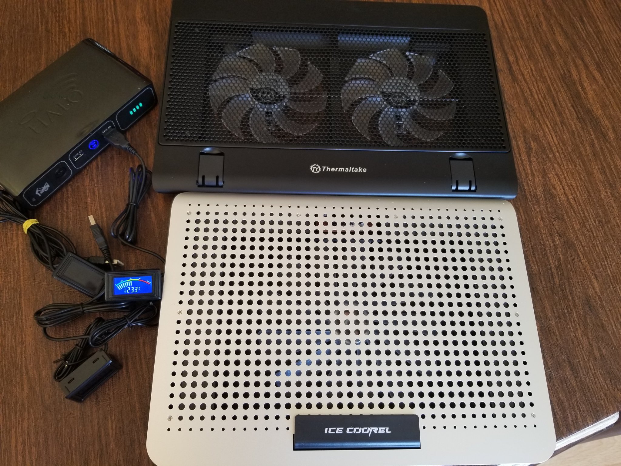

Got two different lap top coolers and three of them temp sensors.
Time to wire the rack and start burning things up.... ( a metaphor in this case, hopefully not the real thing.... ).
Oh, in case you wonder, the boxes under the rack keep the robot vacuum from messing with the wiring.. besides, we like Pink Flamingos.

OK. some preliminary numbers with the SissySIT.
The amp has about 1 1/2 inches below and about 3 1/2 inches above. The sides are all open so the heatsinks have a place to vent. The left ( from the front ) heatsink faces other an A2 amp about four inches away - turned off for these tests. The amp covers are the standard Modushop Delux design, with three rows of cooling slots on either side of the plate.
I used two laptop coolers, one with a single large fan, another with two smaller fans. the coolers were set on top of the amp, centered front to back and side to side. Tried the highest/lowest speed settings. The highest setting for the two fan affair was barely audible from 12 feet away when there was no signal Otherwise you didn't hear at all.
For these tests, three temp sensors were used: (1) for the room temp; (2) for the left heat sink 2/3rds of the way back, towards the SIT proper and (3) over one of the cooling slots about middle of the way over one of the amp boards. For all measurements, I allowed at least 30 min for the sensors to stabilize. I also took measurements with the FM tuner playing rather softly in the background and with some real music.
The bottom line is that with plain static cooling, I think this rack configuration allows the SissySIT to run cool. It's about 5C less than it was with the previous rack which only allowed about 1 inch below and 2 inches above.
What surprised me the most was how sensitive the heat sinks were to the amp cavity cooling down. That means the side heat sinks do heat up the internals of the amp... perhaps a thermal barrier between the inside of the side heat sinks and the amp cavity would help shed the heat to the outside better?
I'll take more measurements today... but here's some...
Notice too how the 2 Fan Hi managed to take out almost 6C from both the cavity and the heat sinks.
Room C | Heat sinks C | Top Lid C | |
Idle, no Fan | 25.4 | 50.5 | 41.1 |
1 Fan, lo | 25.4 | 49.7 | 40.5 |
1 Fan, hi | 25.7 | 49.6 | 40.1 |
2 Fan, lo | 25.8 | 46.5 | 40.1 |
2 Fan Hi, | 25.6 | 45.4 | 34.9 |
2 fan Lo, | 26.2 | 47.5 | 37.8 |
2 fan Lo, louder music | 27.2 | 48.5 | 39.2 |
