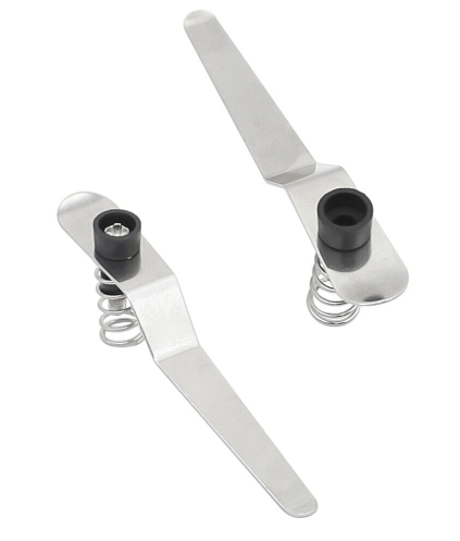

I don't know what kind of tape to use because I don't want to leave a sticky mess afterwards.
I've sometimes used microscope clips for temperature sensors placed between the heatsink fins using a screw itself of the amp cover.
Since the sensors are cylindrical they often slip out of the clip while you are fixing them, but it can be done.
That's awesome.... where can I find them... do you know what they're called.
It looks like I could "spiral" them into the cooling slots...
Worst case, I guess I could make my own clip and use the screws holding the amp cover to keep them in place and provide the elastic tension to keep the thermo sensor in place.
They are the clips that hold the slide under the microscope lens (slide holder).
https://www.amazon.com/jiulonerst-Stainless-Specimen-Biological-Microscope/dp/B07S3G473F

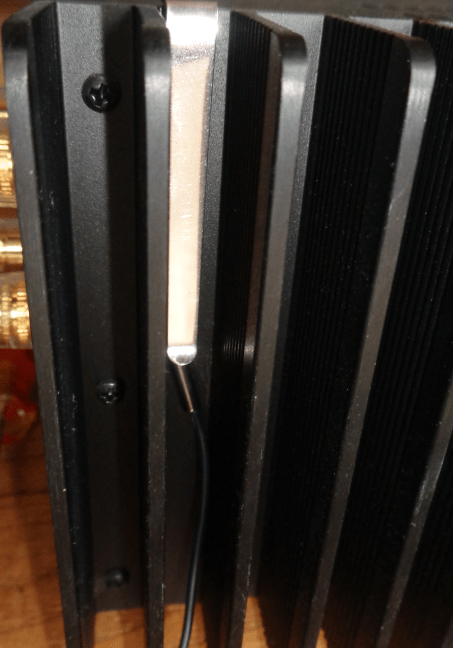

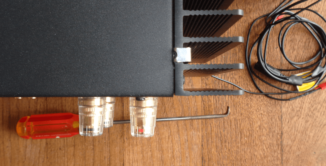

Edit to add some pics and the following:
As you can see in this case I didn't use any screws and I bent the clip to fit it perfectly to the heatsink by tightening it under the amp cover.
A tool such as a screwdriver with the tip bent at 90° is useful for lifting the clip inside the fins of the heatsink.

That's very true:sly:, but my solution is much more effective since the sensor is cylindrical and so small and its cable is not very flexible and therefore if it is not pressed forcefully against a flat and smooth part of the heatsink it provides an unreliable and inaccurate temperature detection. :cheerful:
