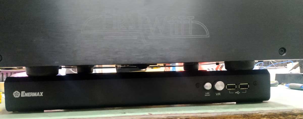

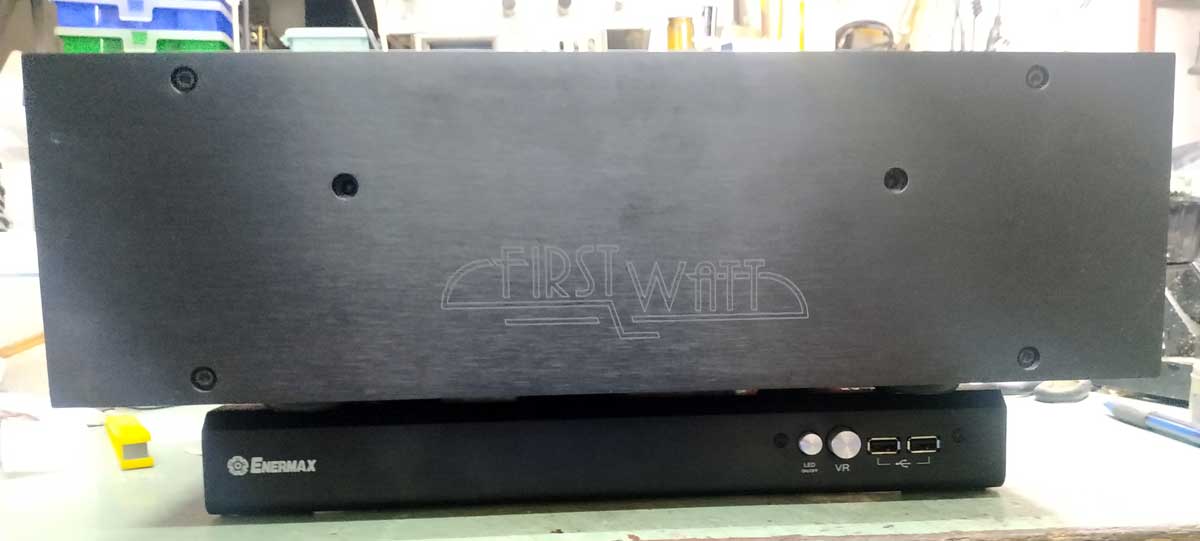

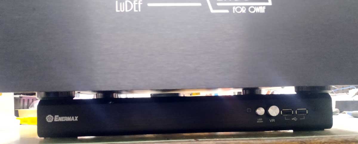

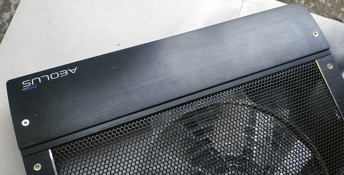

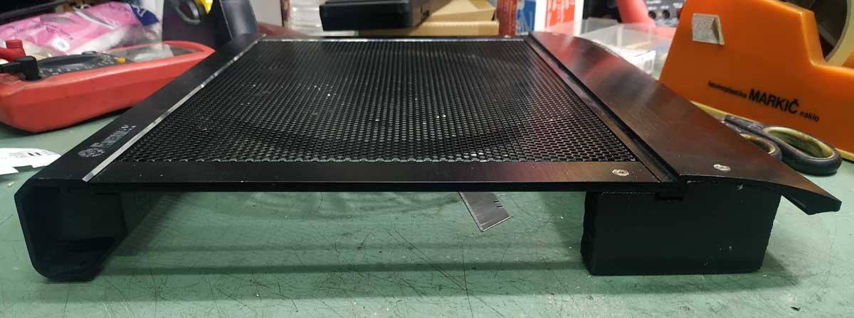

I've just found that Enermax Aeolus series, if found cheaply ( possible) can be accomodated easily for this purpose
probably needing trick or two to ensure better support for amp, but suprisingly sturdy, all metal construction
have a pair (one "Pure", one "Premium"), SH for less than 10E, will post pic or two as soon I make necessary tweaks
easy peasy

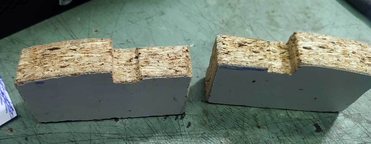

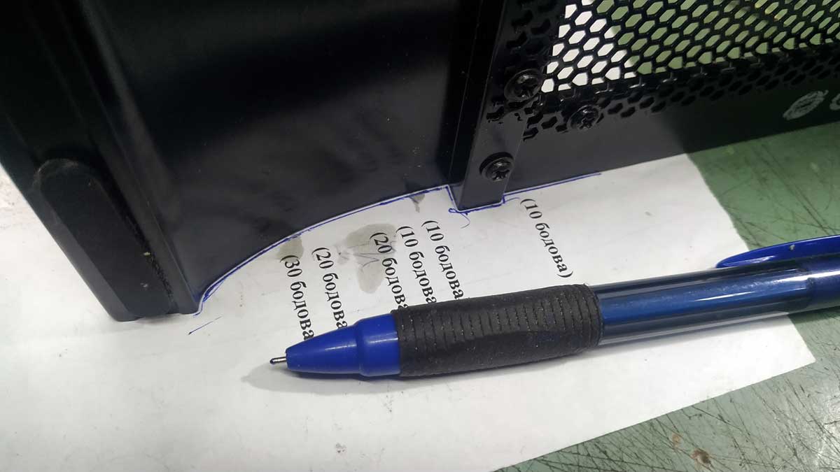

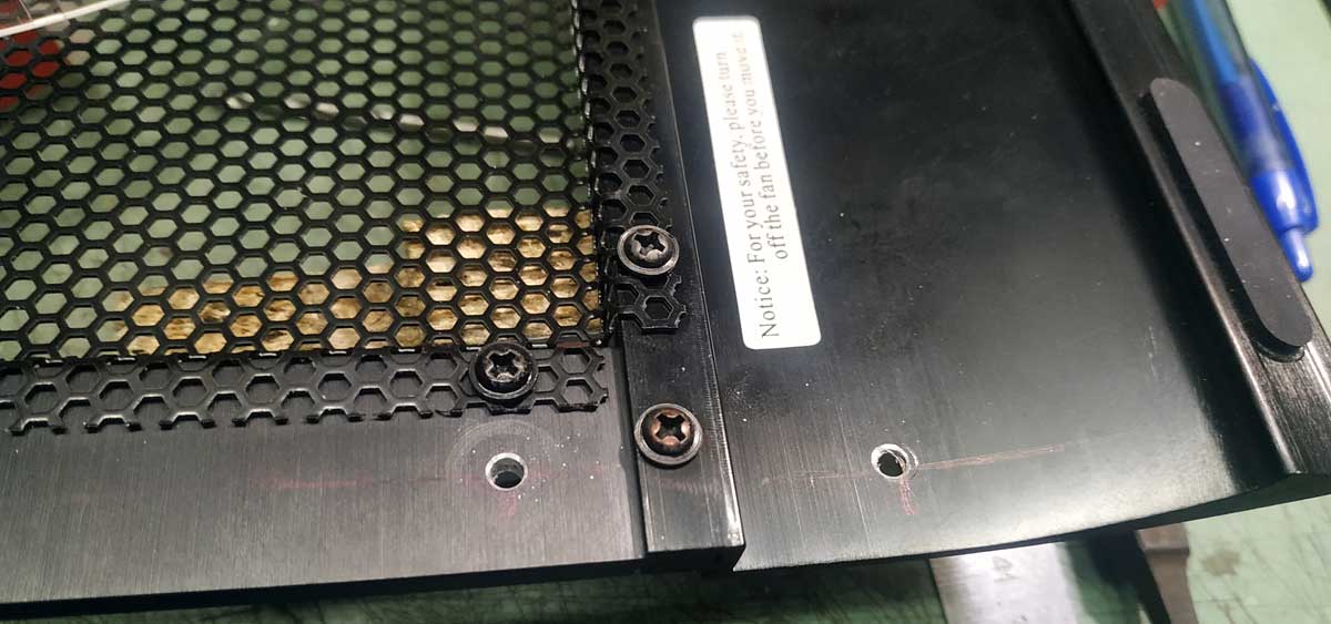

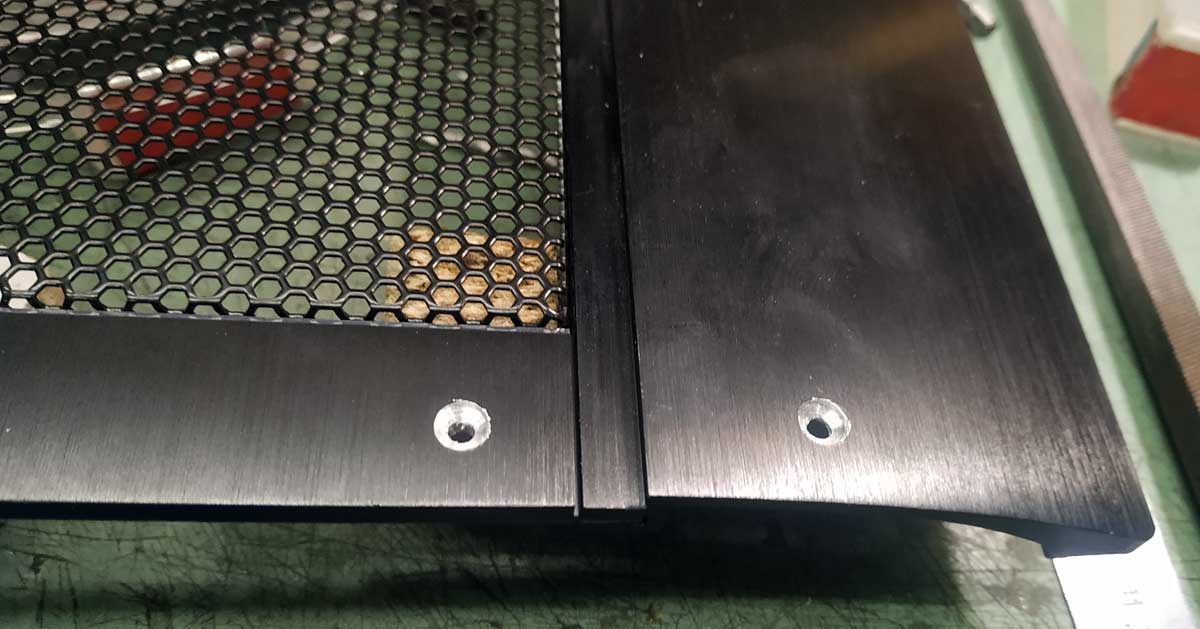

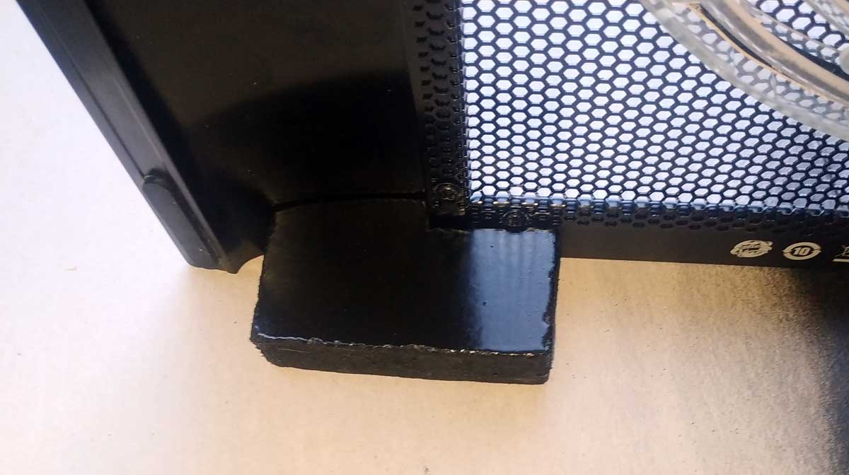

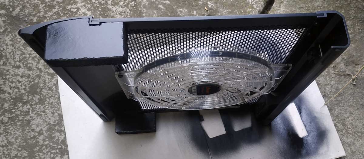

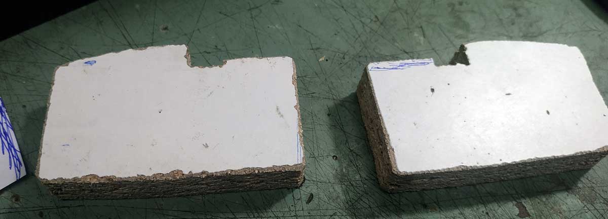

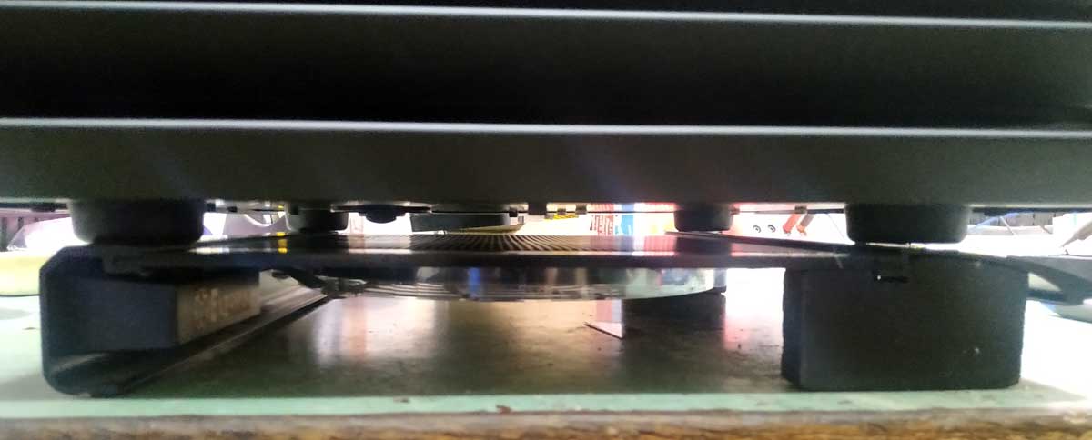

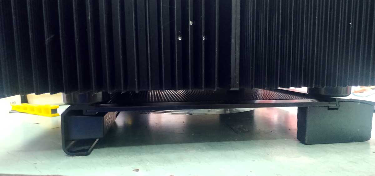

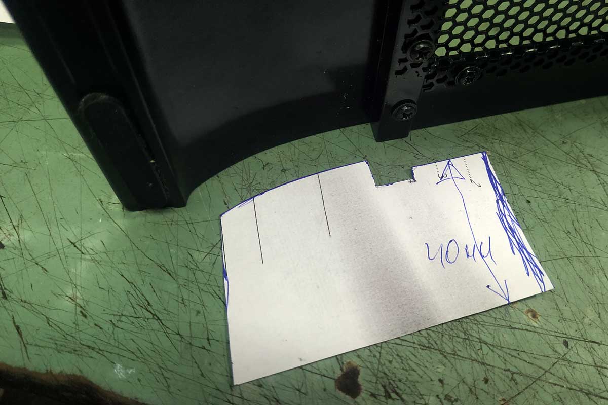

pics of fast and crude implementation
was thinking of using MDF or 40mm Al square tube, but was lazy to search for them, first thing I stumbled on was particle board ..... so why not
shown with FW amp on it and Modu 4U/400
it works as I intended
pics are awful blur, who cares
tool needed - (accu) drill, hand jigsaw

it's more efficient way having it as shown on pics
entire idea with Enermax is - if you can find it cheap, it's good basis
if not, then invest your time to make whatever you want with who-knows-from-where sourced fan
