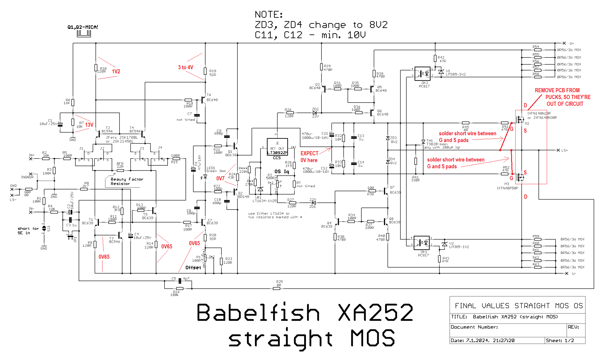

ok, will post schm for FE testing, sans pucks, tonight
here it is - testing only FE
steps are - removing pucks from game , so no nasty surprises
establishing NFB loo ( broken without pucks in place) so FE is having all what's necessary to behave
yeah, brainfart or double typo ...... typing on pic while already calculating next instance
10 times less, so 300-400-500mV
thank you
edit ...... first I uploaded pic without voltage values
then wanted that too, so was sorta in a hurry while I still had time to edit post/replace uploaded file
thank you

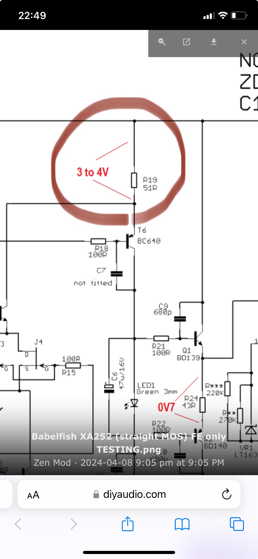

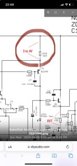

Ok, ran test as prescribed. I did use light bulb with rails at +-38v.
R7: 14.8v
R10: 1v17
R14: 0v663
R19: 0v605
R24: 1v41
Between r20-T7: 0v668
Between r9-T3: 0v668
R7: 14.8v
R10: 1v17
R14: 0v663
R19: 0v605
R24: 1v41
LED is common diffuse type, Green, so 1V9 across?
what voltage is at Q1 E, ref to GND?
recheck voltage E-B for both Q1 and Q2
LED standard Wurth WL-TMRW
LED: 2v6 across
Q1 E ref to ground: 0v083
Q1 E to B: 0v59
Q2 E to B: 0v59
LED: 2v6 across
Q1 E to B: 0v59
Q2 E to B: 0v59
Ok Swapped out. Behaving better now:
LED: 1v95
Q1 E ref to round: 0v076
Q1 E to B: 0v62
Q2 E to B: 0v60
LED: 1v95
Q1 E to B: 0v62
Q2 E to B: 0v60
so, it seems that everything is OK with FE now
while setup as is - can you check voltages across small smd resistors in biasing circ, practically voltage between positive rail and emiters of Q3, Q5, same as voltages between negative rail and emiters of Q4, Q8
that will tell is biasing circ operational
when that done, do not mount pucks yet, remove bridges you soldered form G to S of pucks , then with circ powered Off, check all resistors in between/around puck gates, meaning 10K R32,R33 and gate resistors R51, R52
it'll be cunning to dial Iq pot all the way CCW, preparing for full circuit testing afterwards
important note - pucks mounting - side with slit for screw goes looking at 0R56 group on pcb, side with hole for screw goes to down edge of pcb, speaker trace
Same voltage across Q3,5,4,8: 0v793
In circuit, R32+33 start at 6k and climb towards 10kohms. I checked them out of circuit earlier and they exhibited same, and were 10k when removed.
Yup, I know correct puck orientation, which was heeded originally.
So, next is to start on the startup procedure as you detailed pg 1. I will await your ok.
Thank You!!!!
Thank You!!!!
what you have populated for R** and R***?
sum value needs to be in range of 121K (270K//220K), or one single 120K resistor in place of any of those
so, LT3092 works as 10uA through said resistor ( group)
now, if 10uA goes through 120K, gives 1V20
divided with (R28 + P2) (when P2 is all the way CCW, so 500R) goes to (1K5+500R)
goes to 1V20/2K=600uA
600uA through R29 and R30 (both 470R) gives 282mV
you have 0V793, saying that you have way too much programmed current thorough LT3092, in range of 0V793/40R=1.68mA
if powered like that, it'll give way too high OS Iq
