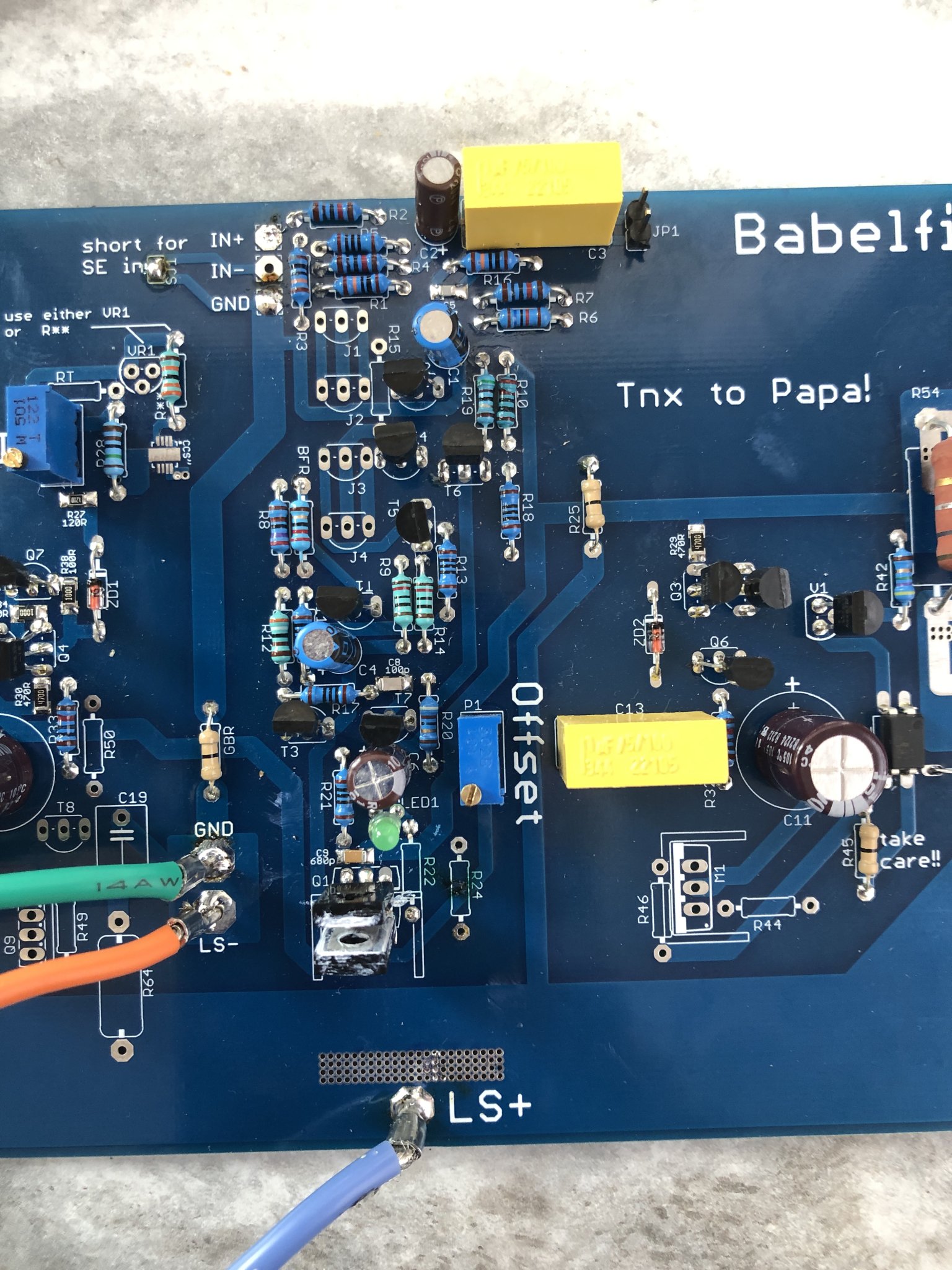

Running into a problem on first start. Using dim bulb tester, and on startup, offset quickly climbing toward negative rail voltage. I shut it off around 20v. No smoke or anything. No visual damage. Any specific areas to test? I went over board with magnifying glass, and didn't find anything unusual. Thx

better pics welcome
especially check output mosfets that you didn't swap them (been there, done that)

PSU checked and working properly. Problem with first channel. Have not powered 2nd channel. I will get do an exhaustive look over everything, and then do your prescribed fuse startup next. Thank you!

Update: Output mosfets are in correct position and orientation.
Went through whole board for proper parts and values.
Installed 2A5 fuse for each rail and powered up.
Offset again went up to 24v ish, then R24 smoked and I shut it down
Fuses both ok
Figuring I should pull Q1 and 2 and check. Not sure what to do thereafter. Might be useful to swap mosfets from other side to test? Run BD pair without heatsink for a few seconds to see operation? (I did have mica installed on both). Only replacement resistor I have right now for R24 is 47r.

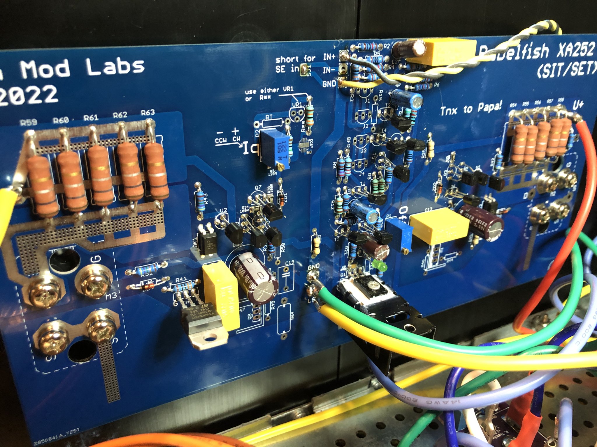

well, it must be something fishy in assembly process, R24 doesn't go in smoke without a cause
anyhow, besides checking each and every component for placement, value and orientation (where applicable), if R24 gone Dodo ........ you need to check and replace what's gone:
R18, R19, T6, LED1, R21, R22, Q1, Q2, R24
all ref to schematic for full mos, post #1462, linked here:
