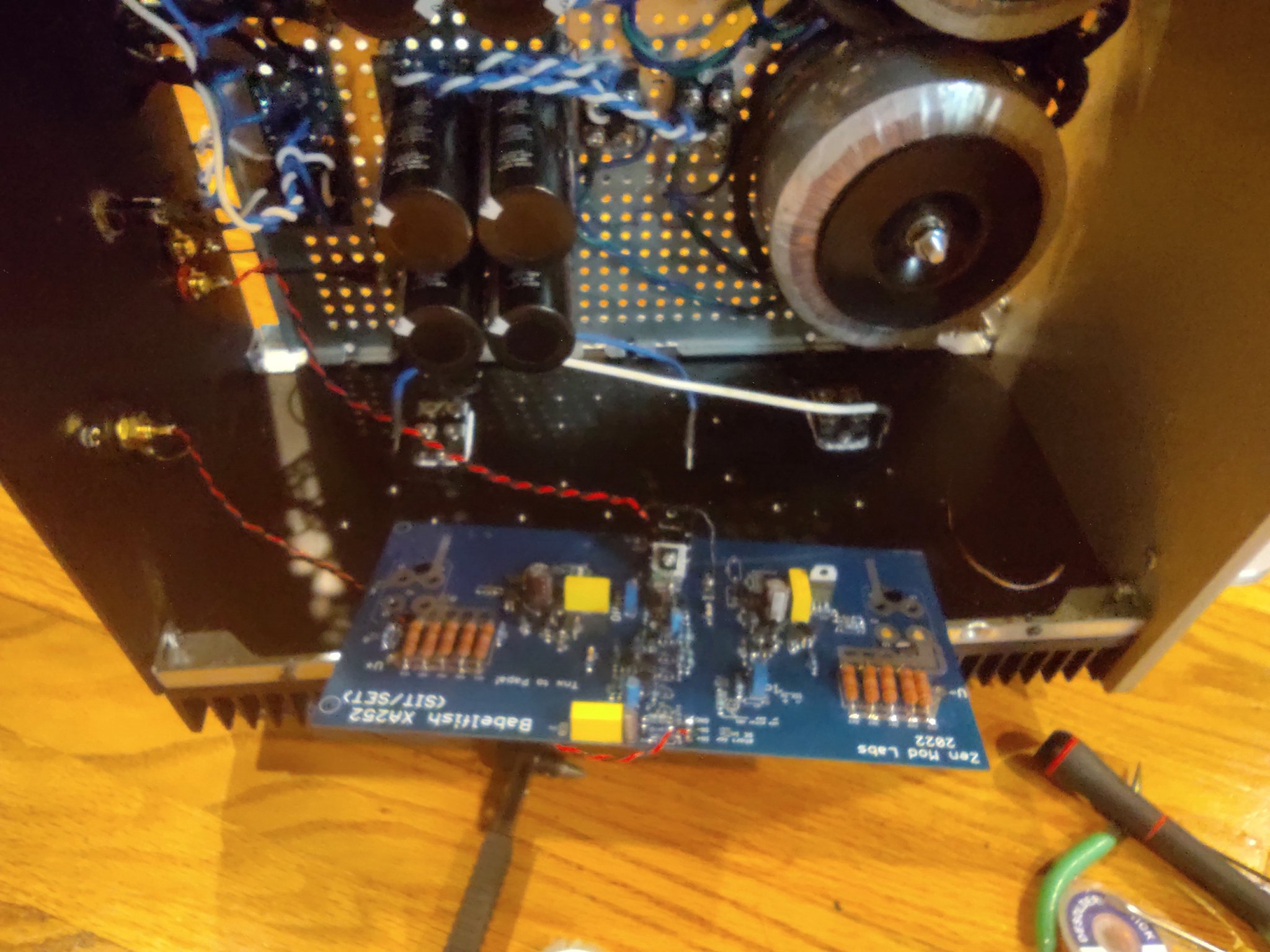

One board out, carefully wicked away solder from pins mounting 10 gauge wire to power supply, and removed them from board. Once detached from mosfets, board is quite maneuverable with only flexible signal wire still attached.
Three smoked resistors out and pads cleaned up. Also cleaned up pads for U+,U- and ground on PC board.
Next will remove the "transistor sandwich" and test those parts. If by strange chance they are good I will be surprised, they look normal enough, but does not mean they are good. If good, I will decide whether to remove and test other small active devices or try just resistors? Pretty sure I remember LEDs on when I first turned off after smoke poof.

@Russellc Having been through this exercise a couple of times ... replace more parts not less. Even if a part tests good today, it may have suffered during the puff and give up the spirit tomorrow. Also, from my recent amp adventures, 'if it ain't broke, don't fix it' - leave the healthy channel alone. I did just what you described and monkeyed up a good channel. Now I have a few miss-matched parts between the boards, so what, they sound better than ever.

Zenmod, post #1936 you suggest to member cwlo to replace R18, R19, T6, led1, R21, R22, Q1, Q2 and R24.
Would you suggest same parts with my mishap? Problems caused by 2 different circumstances, other amp was missing a resistor, whereas mine got a nasty transient.
I also ordered the other T items as well. I did not order the led, will have to get those. I see it must measure correctly, 1.9 volts, is there a particular led part, or just get a bunch and measure?

pretty much - same vertical of parts involved in mishapWould you suggest same parts with my mishap?
precision of said voltage isn't so critical - it can be green or red, so ref. voltage in range of 1V8 to 1V9; LED type is - plain normal diffuse one - those are of older/usual variety, not modern superbright ones
I bet you have some in drawer already
I have blue. Short of install, fire up and measure voltage across led, I assume no other way to make this measurement of 1.9 V? I know how to test with multimeter as to leed orientation,not voltage across it. Is T6 the only one of T1-T7 that should be replaced, I did order them all.

I have that transistor tester thing I posted. Is that it? Or another device?no blue
as I said - green or red; measure them prior to mounting
have you handy measure-it-all Gizmo?
anyhow, diode test on your DMM will give you direct measurement in mV
majority of those are limited to 2000mV, but for proper LEDs that's enough
