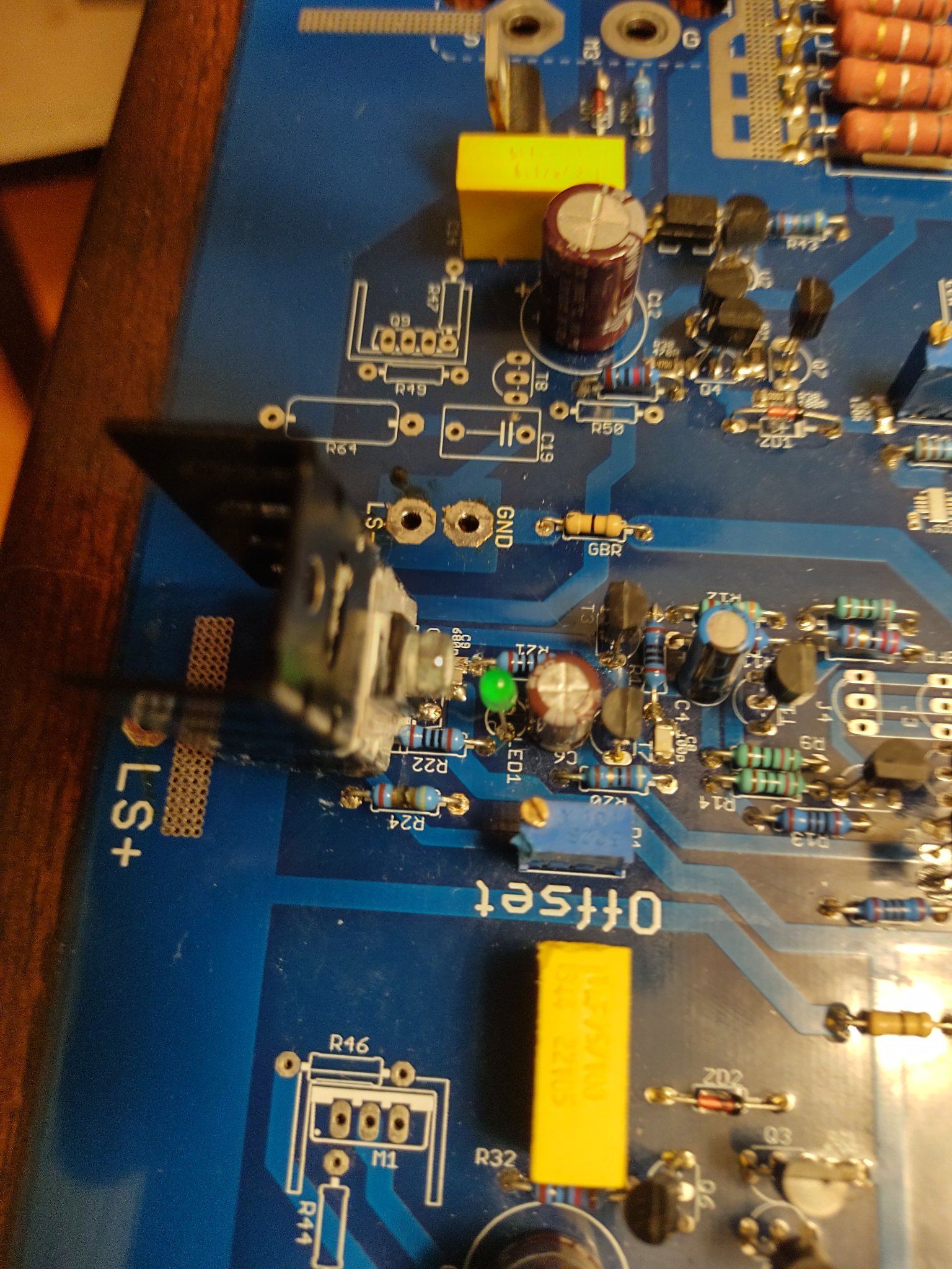

2nd channel not so good. When variac got to about 70 volts, whisp of smoke. Can't really tell where it came from, possibly R24 looks possibly tanned, maybe.
Started turning variac up, definitely R24. What now? Disassemble and test/replace same parts?
I was super careful not to mix up Q1 and Q2, but you know how that goes. I replaced all the suggested parts, just like in other channel. Q1,Q2, T6, R19, R21, R22 and R24.
I assume next step is tear down? Or anything else to check first?

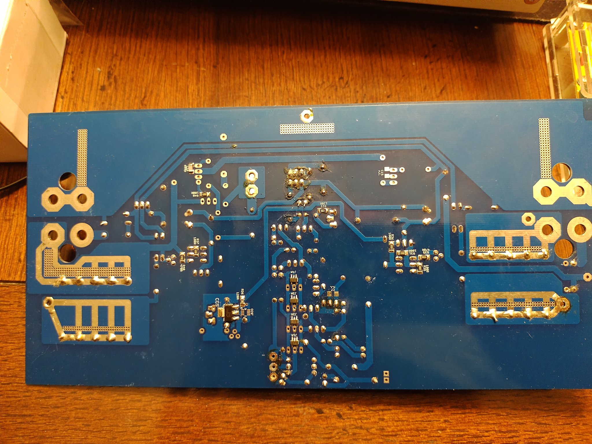

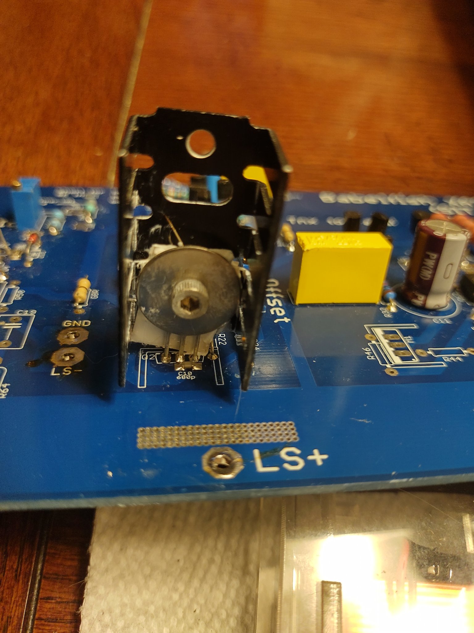

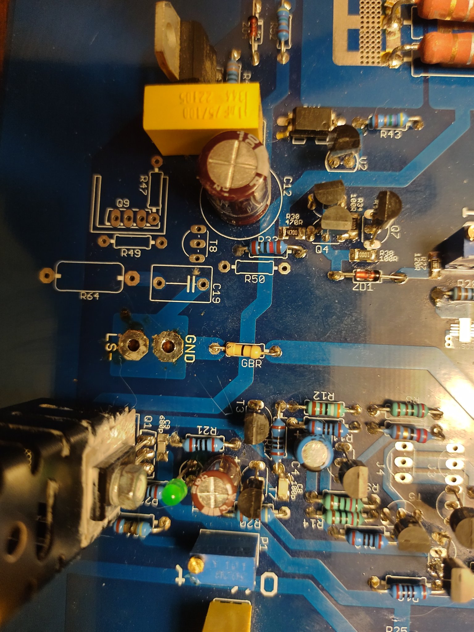

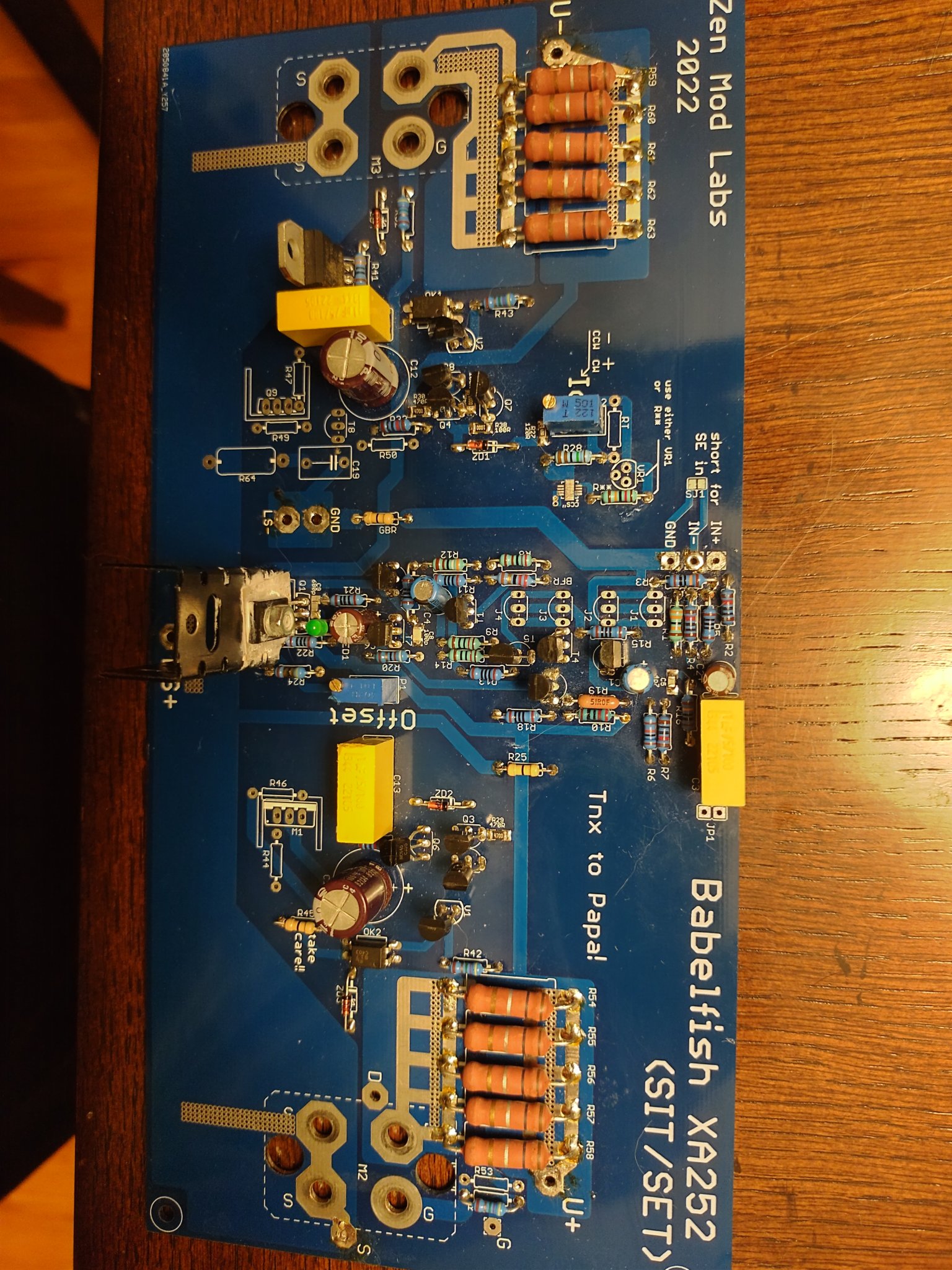

The offending board:
well, you have DMM and SuperGizmo tester
if R24 was toasted, any surrounding part was in danger of overcurrent
parts are cheap, work is cumbersome, so better to replace more than less, as it happened on that channel
no need for so big washers on BD transistors; and - with smaller washers you can see numbers on them
or - take red sharpie and paint red pins of BD139, so you'll see red pins even when soldered in place, as confirmation that red is in positive rail side
Reactions: 1 user

There are a couple of tiny items, smd caps maybe, and parts right by where transistor sandwich 6 legs go into board. Seems solder slightly disturbed from nearby removal/reinstall of sandwich. Could I have messed them up causing this? I will post pics of board as soon as parts removed.
If all parts are new, can't figure why R24 went. Would reversal of positions of Q1 and Q2 do this? I checked and double checked, Q1= BD 139, Q2 = BD 140.....but you know how it goes...first channel perfect.
Board disassembly after work today, and check parts. The resistor was just starting to smoke, backed off variac, none others disturbed. Visually anyway. All parts will be replaced. Again!
Russellc
Russell, see if you can cleanup that whole area. R21 solder pad looks like it could be touching adjacent c6. BD sandwich missing mica? I got a Hakka desoldering tool when I had my issues, and it made the removal of components so much easier and cleaner. Also, I was able to test probably 95% of the components installed, so using your dmm and super gizmo tester should find the problem.
Reactions: 1 user

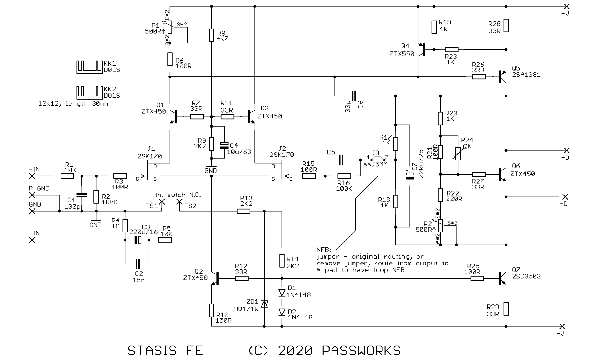

@william2001
Study Papa's New Stasis FE - there is limiting cell (Q4) where it needs to be
When I asked Pa about that detail, his answer was pretty much like "prevention of disaster in case of..."
Now you know and I know ........
Though, ZM need to build more cleverness to implement any sort of no-invasive limiting zingy in existing emiter follower stage in XA252
For now, I devised next gen, having 2 LEDs in series as base spreader, allowing use of 2*91R in between emiters, at least partially decreasing Poof possibility
that enables next step - no other way than adding few smd bjts and few smd resistors, monitoring current through each 91R emiter resistor, and clamping BD bases when current goes to - say 40mA
attached Papa's Stasis FE
Clever Pa.......
