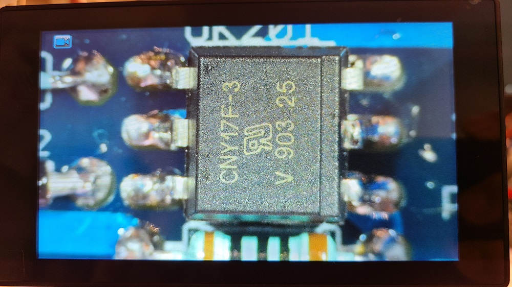

Is it possible that CNY17-3 is upside down? Will it even bias properly with OK101/201 upside down because there is no apparent pin-1 marking on my Vishay CNY17-3 so I went with assumption that the 'V' is pin-1
I didn't see datasheet give any indication:
CNY17-3
CNY17-3

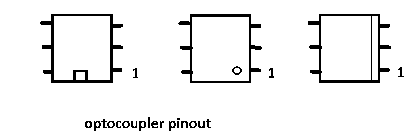

Page 7 of the pdf shows the pin 1 ID.
It is as the third diagram of Zen Mod's attachment - the line parallel to the edge indicates the side where pin 1 is located.
Thanks ZM and Ben!

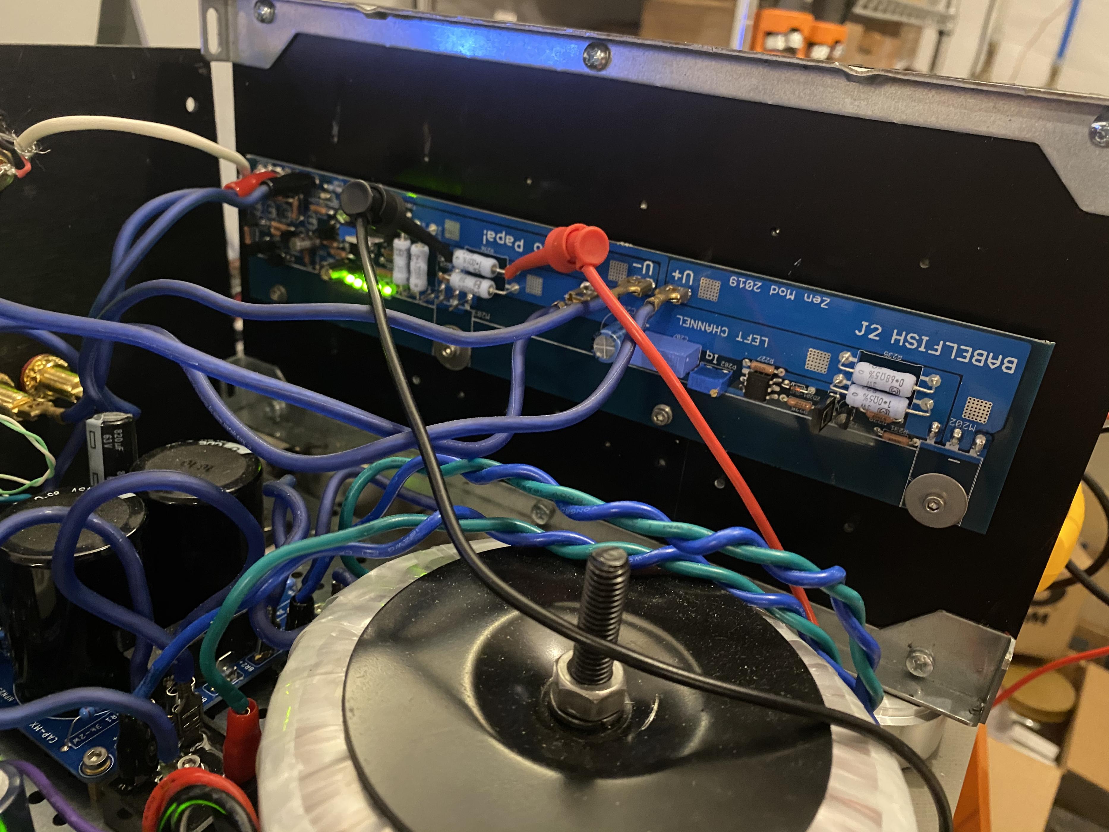

I removed the boards from the chassis to inspect them and then reinstalled them so I redid the input and output connections and re-grounded the input+ for both channels and it's being well behaved now. I put dummy loads on output and disconnected input+ from ground and it's still stable so crossed fingers and connected to speakers.
It's playing music now and sounds great so far but I get a slight buzz on one channel when I touch volume know on preamp (!!!). The boards are installed in test bed so this chassis/PSU is well tested ...
I may revisit how my ground connections are done on the boards. Right now I have OUT- | PSU GND | IN GND | IN- | IN+
Damn gremlins!
Anyway, happy to report that no magic smoke seems to have been released and I have music in my room thanks to ZM and Papa once again! :cheers: :cheers:
It feels like Diana Krall is singing in front of me but breathing on the back of my neck ... :nod:
It's too soon to try and imitate Srajan until I get more hours but so far it's definitely worthy of building and the best/worst part is it's only the IRFP150 version so far. This will be fun toy for sure! F6 was too restricted to even try Cree but this one definitely works!!! :cheers:

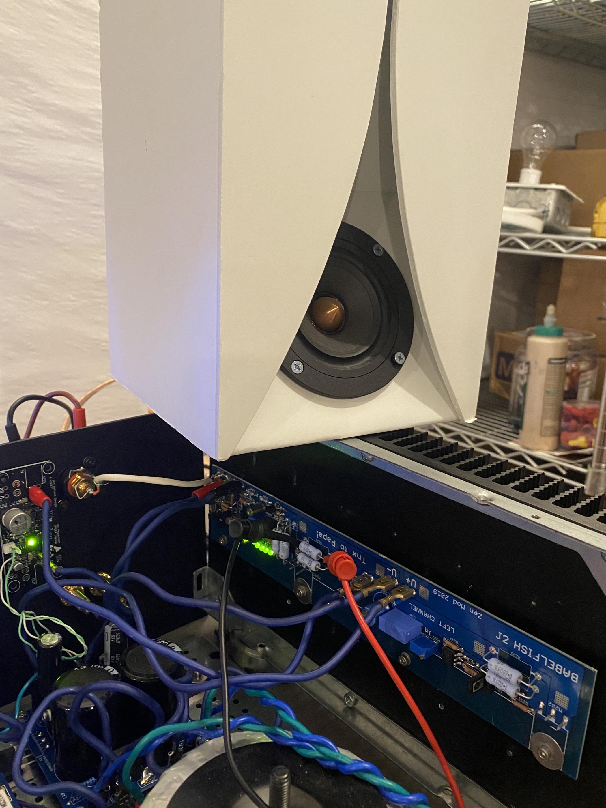

First sound on the right channel! Or is it the left channel???? No, right channel :rofl:

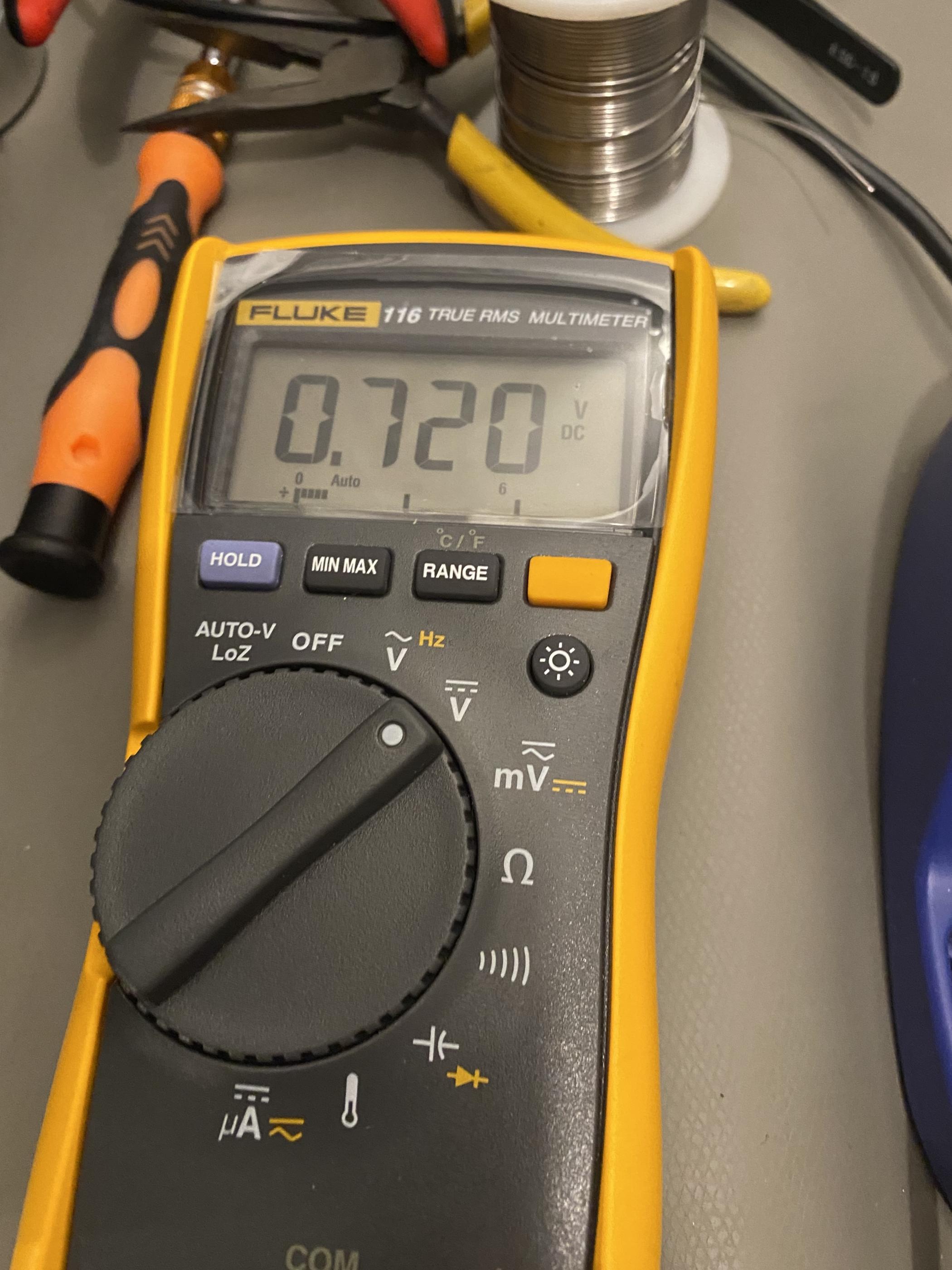

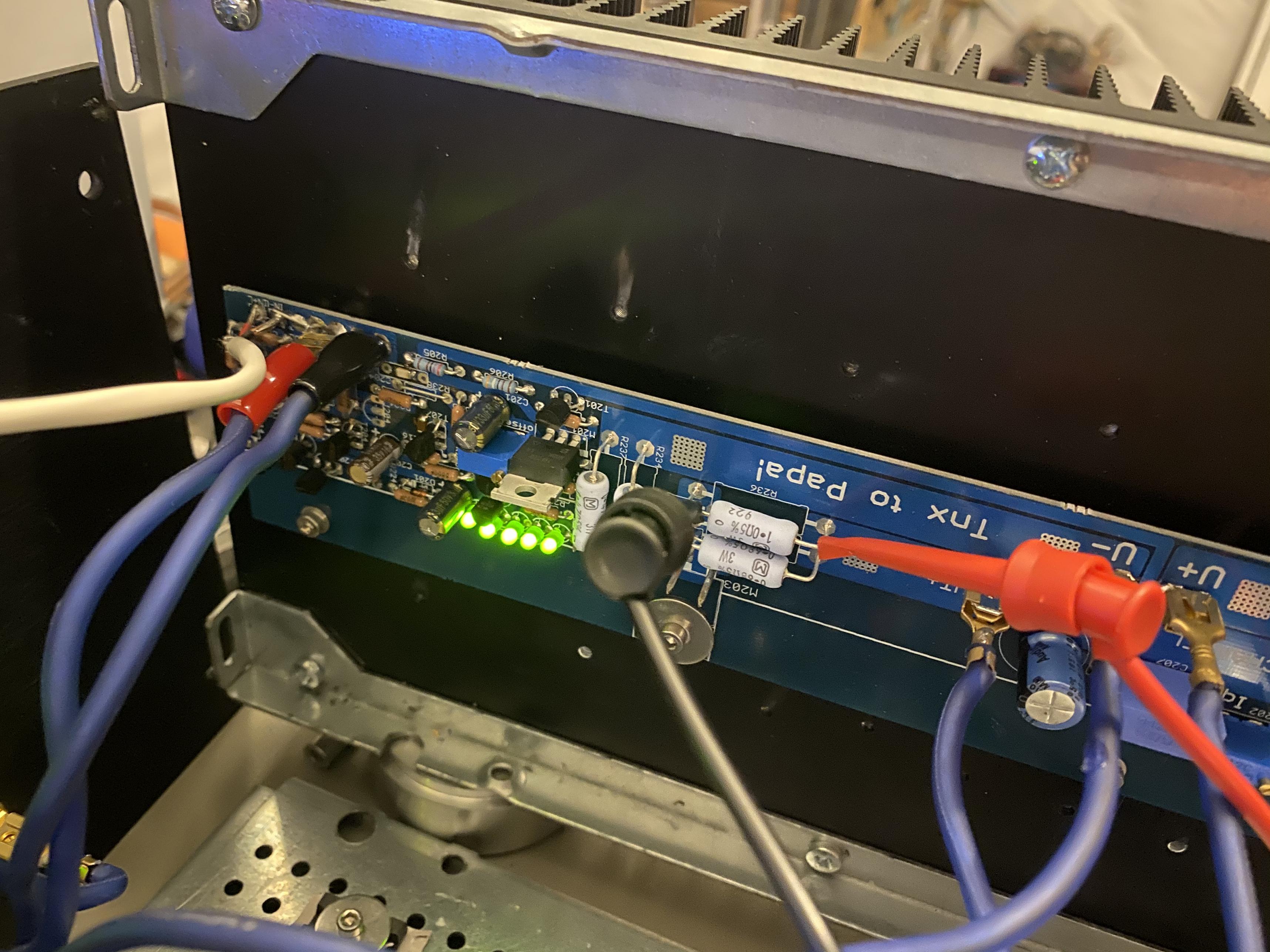

This is with Semisouth SEJP120R063 down and IRFP150 up. I’m getting about 720mV with P202 maxed out. It’s not fully cased yet so final adjustments remain. Playing a few quick tracks with an Amazon Echo Dot as a source it’s sounds REALLY good so far. Really looking forward to getting the other channel finished.
Thanks ZM!!!

Awesome - congrats! Using the SS’s I also topped out my bias pot around 750mv/1.5Iq. I believe it’s an easy resistor tweak if you’d like to get more out of it. I’ve been playing around with MOX values and that’s bought me a little more current, so I’ve not swapped any resistors. That said, I did have to make a resistor swap to get my offset to 0. Guess it’s a small price to pay for a listen to those sweet semi’s 😀 My absolute favorite amp, hands down!
Thanks Cody! So far it seems like P201 has enough adjustment to get the offset to 0mV. So the chassis is from an F7 clone. It is the 4u/300. The sink was getting pretty toasty after about 15 minutes. I wouldn’t want to take the bias up any higher, but I have a 5u/400 waiting on the shelf for this amp. 😀 Just didn’t have the time to build up a new power supply yet before the basement starts construction on Monday.
So ZM, what is the best tweak to increase bias a bit?
P102 is for Iq set, while P101 is for output DC offset chase
if you need more of any, just increase resistor in series with trimpot
for instance, R123 goes to 510R, R118 goes to 1K2
